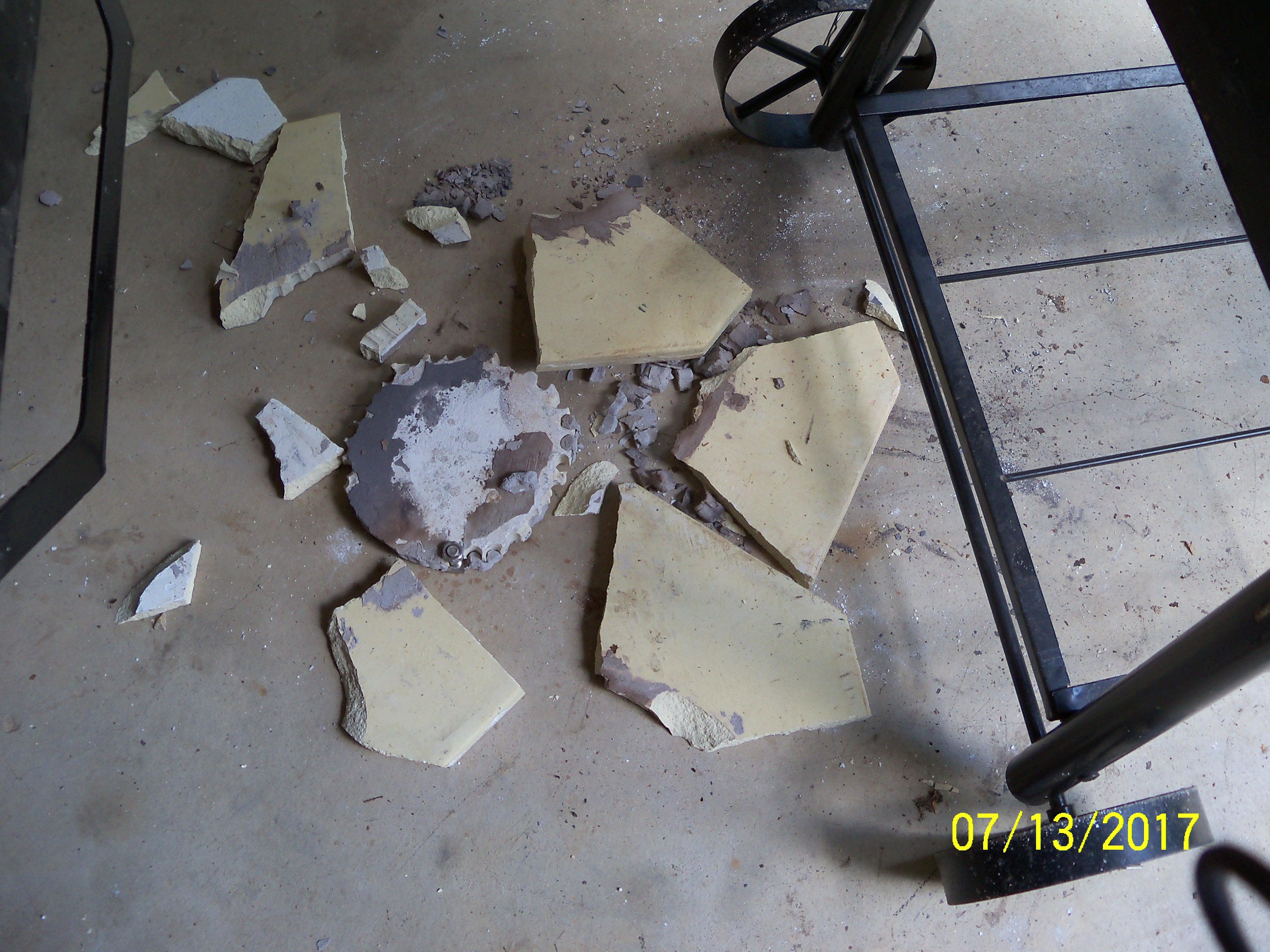

So I built a new forge from scratch. It's a ribbon burner forge and everything has gone smooth. Except the fact that I broke my burner as I was assembling the last tube and just about to fire up. Anyway, I have been firing the kao-wool & refractory floor, walls and ceiling every night after letting sit for 6- 8 hours in my oven starting at 195 degrees for 3 hours and then 300 for 3 hours. Of course that has only been 1/2" of cement too. I am curious to know if anyone has fired a ribbon burner after letting sit for less than 3 days. Yes I'm impatient. Especially after almost being done once. I was wondering how long it would actually take for 3 inches to set up and be ready for firing. I'm assuming 24 hours per inch, but has anyone done it sooner?

Frosty, It is basically Mizzou 3000. The Blacksmith and Farrier supply shop that I get alot of my supplies fro sells 55lb bags. I have experience using this refractory as I've had great results in the past.  I'm just basically wanting to know if I would crack my burner if I didn't let it cure for the 3 days recommended  in the plans for the ribbon burner plans that I printed up from Pine Ridge Burners. Honestly , I don't think I want to go off from the directions. They are written as such for a reason and I don't want any issues with this burner. I was just being impatient. The thing is, The refractory used for the burner is 3" thick so curing time is critical. Here are a few pics of my progress. That burner broke though. I dropped it. Oops :o

On mine, I added couple little tabs so the burner would sit on top of the flange of the Forge body. Takes away the force of the bolts pushing on the side of the burner, cracking the bond. I see you have a tab for sitting in the mould.
Neil
Ya know, between me and you, I broke the burner because of the bolts. As I was trying to put the plumbing together I thought I had the set screws tight ( I did) and the burner wouldn't move. I'm pretty sure it did push on the side cracking the bond. It just fell right out of the burner body. Thanks for the advice. I will do that. Hopefully the tabs that I have on there will be good but I know that the metal should absolutely not protrude into the forge body.
Neil
Thanks for that idea Neil. I put tabs on by burner body and it does relive alot of stress on the mold. Thans, again for that.
