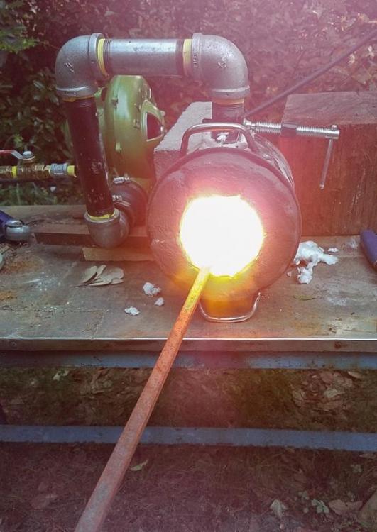

Phillip-SC Posted April 25, 2020 Share Posted April 25, 2020 SUCCESS! But maybe not what was expected... I taped over the blower inlet just to see what would happen if air flow was a bare minimum, and things really didn't change that much regarding the holes at the far ends. No longer concerned about the regulator pressure reading (Thanks again Buzzkill and others), I thought either the flow speed was too high on the ends or maybe my little baffle was too aggressive. So, I drilled out the 3 holes on each end just a little to see if that helped. No. Things were the same, even if I let more air go through and adjusted the fuel a lot. Hmmmmm. Long story short, I found an old coffee can and held it with long tongs onto/under the best flame I could make (but again, with almost no flames much on the ends) and like magic, the whole length of the burner suddenly became a thing of beauty -- and whoa! -- you could tell it's was way hotter! Back pressure of some kind was apparently needed in my case. Who knew? Time to get the little forge container finished, coated inside and assembled with the burner, and pretty confident now. And this thread had all the answers imbedded. I'll let you know how it goes. THANK YOU ALL. Quote Link to comment Share on other sites More sharing options...

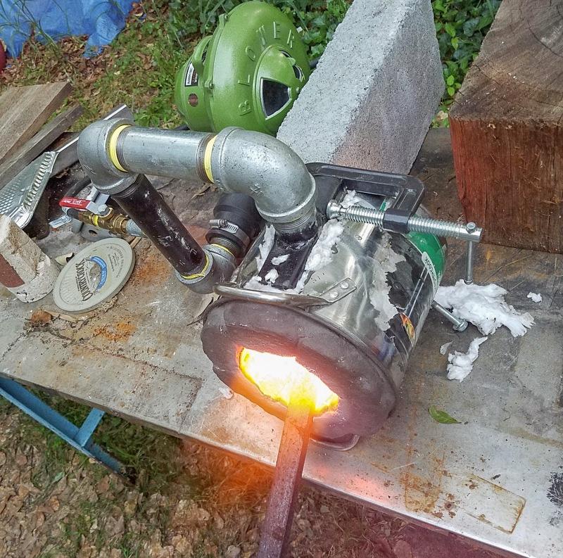

Phillip-SC Posted April 27, 2020 Share Posted April 27, 2020 Well, SUCCESS Again - Many thanks again to you guys! The forge is REALLY hot in this test. The flames are very evenly spread and fast to heat the just end of a bar (the purpose of this rig). Very unexpected to me is the fact I can run the whole range of the blower and interestingly the regulator shows 2 to 3 psi (though it probably doesn't matter, I now know). I am super happy with this test except I pretty much DESTROYED the inside coating because I did not wait long enough for it to cure. (Just a thin mixture of sodium silicate and aluminum oxide powder over some kind of very lightweight 2" thick rigid stuff - not labeled anymore - I've had for years). Quote Link to comment Share on other sites More sharing options...

Buzzkill Posted April 27, 2020 Share Posted April 27, 2020 Congrats! Looks like you can hit welding heat with ease on that setup. Apparently the back pressure in the forge was enough to even things out for you - more than I thought it would. For years Frosty has been preaching that burners should be tuned where they will be used - and he's right once again. Quote Link to comment Share on other sites More sharing options...
Frosty Posted April 27, 2020 Share Posted April 27, 2020 Just a figure of speech, who knew? Yeah I was ribbing you, I'm like that you know. MAN that's a HOT forge congratulations! Sodium silicate isn't going to survive in that environment and maybe not on the later behind the flame contact material. Heck, fumed silica might not do it. However, kaowool would be encapsulated in the hard refractory and you'd be safe enough. I'm betting your burner is pushing max temp for an air propane flame, you might need a better than 3,000f flame contact refractory! Have you melted a piece of steel in that baby yet? I would've made a puddle out of something soonest! Frosty The Lucky. Quote Link to comment Share on other sites More sharing options...
Phillip-SC Posted April 28, 2020 Share Posted April 28, 2020 I am fixing the forge walls, and will use kaowool inside with a coating as recommended. I have seen several of the really-high-heat refractory coatings but am really surprised at how expensive those are for just a small amount of material. Dang. Must have gold and diamonds and moon dust mixed in. I will indeed try to melt a piece of steel when this is fixed up. A thousand thanks. Quote Link to comment Share on other sites More sharing options...
