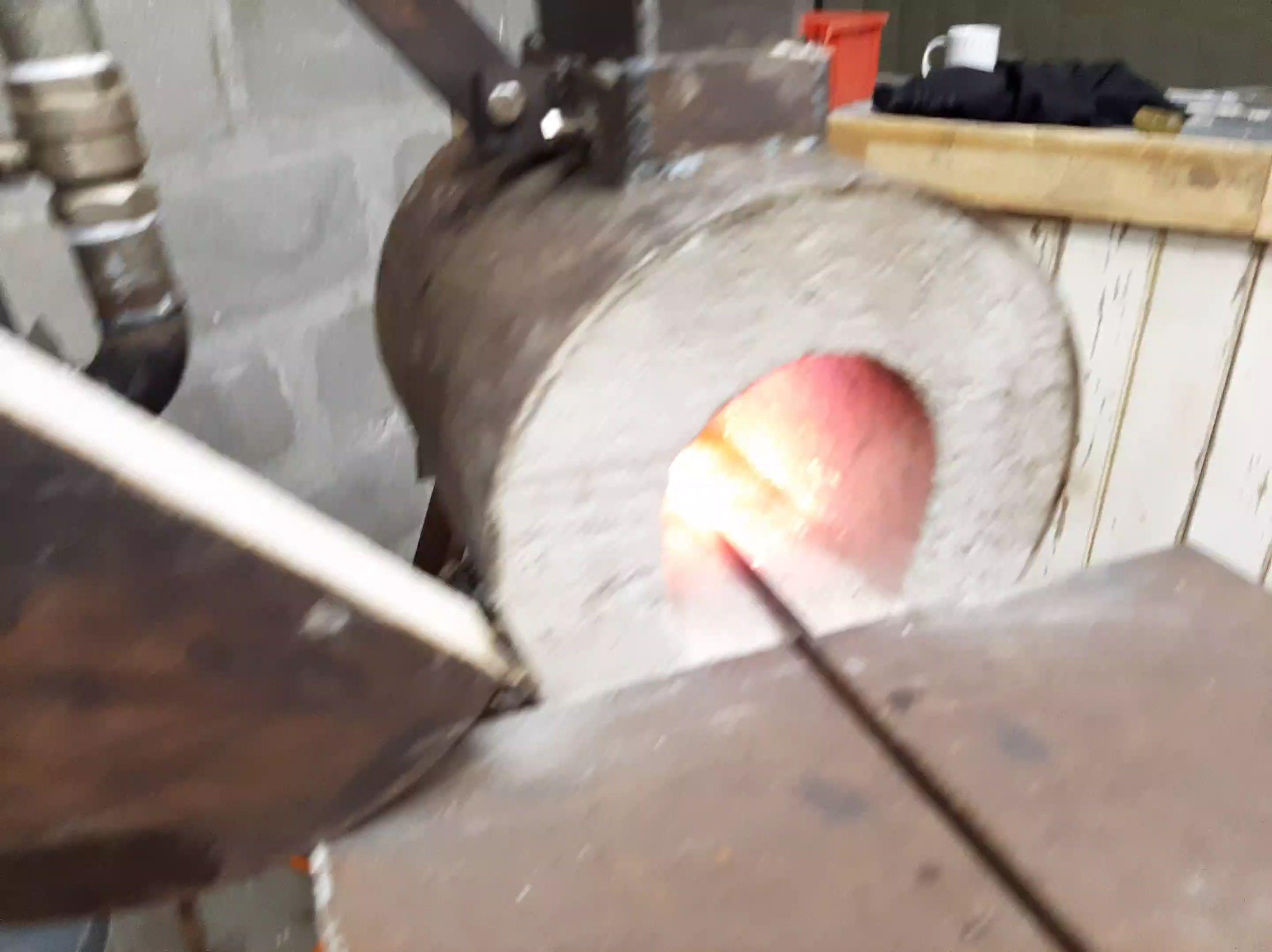

I installed the burner in my forge today. The forge is probably too small for the burner but it worked out very nice. I started slow on the air and gas mix and cranked it up further as the forge heats up.
A bright yellowish, nearly white heat was no problem! I just need to get used to the tuning to reduce scaling a bit more.

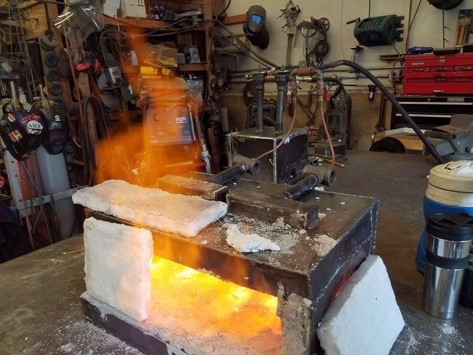

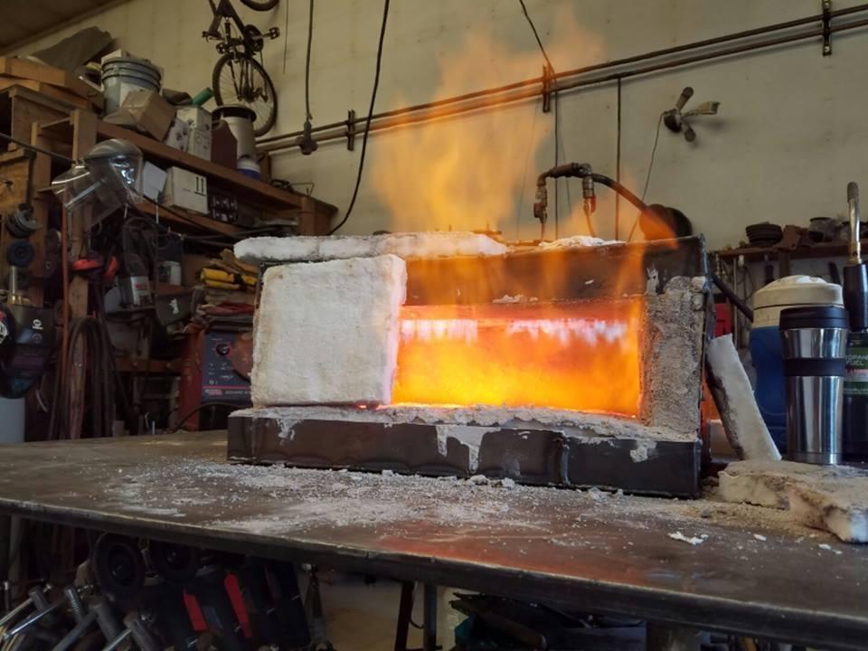

I am not sure if I am allowed to jump in here on this thread but I have some issues with a forge that I built. This is my first forge and ontop of that I decided I wanted to do a ribbon burner, although I am kind of regretting it now

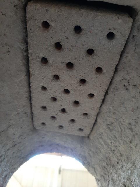

So just to get jou updated on what I have done so far.  The forge was lined with ceramic blanket 3 layers of 1 inch each and then covered with  approx 1/4" refractory. The mesurement for inside of forge is now 16" long and 7.5" diameter (cylindrical shape with flat bottom). Volume calculates to approx. 650cu.
The burner body is 4" x 8" and I have 23 holes of 5/16 spaced accordingly in a 3 then 2 pattern. There is a baffle plate in the plenum of burner.

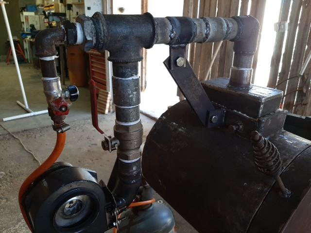

The piping for the burner is 1 1/2 " and you can check my configuration in the photo.
Gas is supplied with a high pressure regulator and is controlled by a needle valve. Gas is injected into system via a diy injector made up from a piece of pipe blanked off in front and then 3 holes drilled around it. Diameter of holes are 5/64.
The blower is a squirrel cage type. It is probably a bit small but I did hook up a variable speed leaf blower with same problem although a lot better heat.

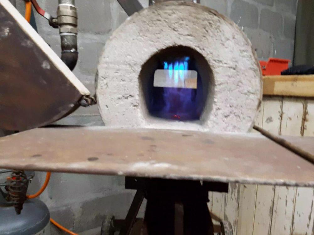

So the problem is that I do not get the flames to burn on all of the holes in the burner block. I checked and all holes are open.  I played with the gas air mix quite a bit. I can get both rich and carburising flames. There is no popping or Bach burning. Everything looks good. I would have thought that forge would heat up sooner and that it would get hotter. I ran the forge as hot as I could for about 15min and although the forge got nice and hot and I am sure that I would be able to heat treat and forge with it, I was hoping that I would be able to forge weld at a later stage as well.
I am poking around in the dark here so any pointers and advice would be appreciated. Heck maybe I just nedd to run it a bit longer or something I don't know.
One thing that I am concerned about is that I might have drilled the holes in the mixing plate in the plenum a bit big. So instead of some of the gas going around the plate it can now gow streight through. And also do I have to many holes in the burner block?

I can't see anything but the forge and flame. A pic of the outside of the burner might help.
The flame I see is a little rich. rich and carborizing is the same thing. Lean and oxidizing are the same thing. Not nit picking it just really helps if we use the same words and meanings. Yes?
It's not looking bad from what I see,  little tuning won't hurt and the more you mess with it the sooner you'll learn how to tune your burner.
Is a couple few outlets not burning your main concern? It just indicates more fuel air flow is hitting some outlets harder than the ones that aren't burning. Without knowing more about your burner that's about the best I can say.

Here are pics of the forge outside. I know the blower might be a bit small so I will get a better one. Although I do question the huge blowers that I see some have. I might be wrong there as I have no experience to back it up.
Thank you for all your help. I really do not have any means of getting to a blacksmith at this stage. Lock down and my remoteness comes into play. I stay almost 500 miles from the closest blacksmiths.
Good grief MAN don't apologize! I was only joking with you to put you at ease! Seriously how could anybody ask permission to post without posting? Heck I thought you were joking so I played along. You weren't using the wrong terms, I only pointed out a commonly used synonym so you'd know what other folk were talking about. I like to try to get folks using the same terms for things, it saves a lot of explanations? Yes?
You have nothing to apologize for, you've built a heck of a burner from often dubious information. You deserve KUDOS for a job well done.  You have it down to tweaking for higher performance. Brother you should be SMILING! :D
I'm not a fan of the huge blowers with the giant flames shooting out of the forge openings you see in most ribbon burner forge videos.  Looking at the most commonly used plans shows the reason they need such strong blowers to make them work. They place the diffuser right on top of the air fuel supply so it takes a lot of pressure to get any flow past it and what does get past is moving so fast it just blows right through the forge. Sure the forge gets hot but the amount of fuel burning OUTSIDE the forge is nothing but a dangerous waste of money.
I'm a proponent of low velocity flames so they stay IN the forge longer and transfer more heat to the forge liner so it can work for me. I paid for that propane, I want all it has. It's the Scot in me. ;)
You might need a LITTLE larger blower but you might be able to rearrange your air plumbing and increase the flow enough. Right now the flow is entering the T with the gas jet and impacting the far wall. This is a hard impact and very turbulent. Turbulence is good for mixing the propane and air but it is inhibiting  the free flow of air more than I THINK it should.
With me so far?
Good. I can't see what you're using for an elbow on the blower itself but if you rotate the blower so it's in line with the air line it will flow more easily not having to go around the corner. Yes? I would put the T IN LINE right after the gate valve you're using to control the air flow so it can blow straight through the T . Got the picture?
Good. Your propane jet now mounts in the T's CHASE. If you look at a Capitol T a plumbing T has the "Run" the cross on top and a "Chase", the single part at 90* to the run. In plumbing the main flow RUNS straight through a T and if you need to some for a faucet or another  room or whatever, it CHASES off the run. Make sense? This is just more jargon so we don't have to explain everything. Yes?
Anyway,  now your propane jet is mounted in the Chase so you'll need to adjust it's length so it's more or less centered in the Run. (the air flow)
Where the T used to be needs an elbow to turn the corner.
I think that little change MIGHT improve the air flow without increasing it's velocity as much as a larger blower. Introducing the propane earlier in the air flow will improve mixing and there's plenty of turbulence turning the corner at the top. It will help, if not enough you're only out a little time and a new blower can just be mounted and hooked up. Yes?

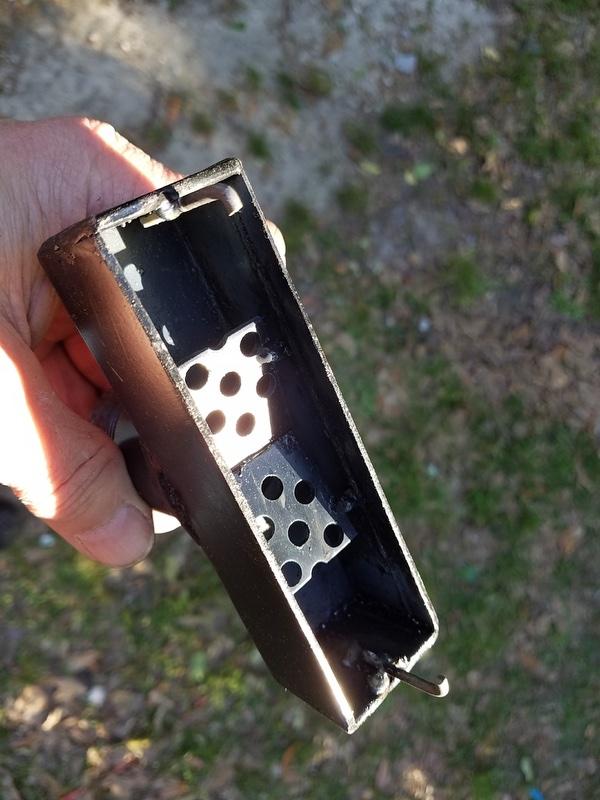

The only fix for uneven flames would involve cutting your plenum open adding a diffuser and welding it back together. I'd live with uneven flames were it me.  What's happening now is the air:fuel flow is entering the plenum aimed straight at the holes in the center of the block, they are getting the most pressure and the flow isn't changing direction so those flames are longer. The farther fro the center the smaller the flames until you get to the outside ends and there isn't enough flow to feed them.  Make sense?
The way a lot of guys try to even the flow is with a diffuser with a lot of holes right on the inlet but as I said it takes a lot of static pressure from the blower to overcome the restriction. What I did instead was to weld a solid piece across the plenum half way to the burner block. My plenums are 2" x 2" tubing set almost 1/2" into the block leaving 1 1/2" space between the inlet and the block. My diffuser is 2" of the side I cut off the tubing I made the plenum from, a 2" x 2" square welded about 3/4" from the inlet.  I should've made it 3" long but it worked well enough at 2". All my diffuser does is deflect the stream from going straight in the center outlet holes. The flames aren't perfectly even in my burner but good enough. I don't need perfection.
What really evened up flames was mounting  my fuel air inlet on the side of the plenum rather than the top. The main flow isn't aimed at any of the outlets it's aimed at the far wall of the plenum and disperses sideways to the far ends almost as much as to the closest outlets. The flames in the center of my burners are still longer than the ends, it's a pretty smooth curve but they're close enough. My forge is evenly HOT across the length and doesn't make excessive dragon's breath.

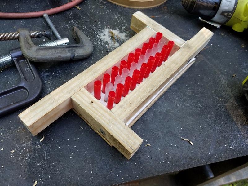

About baffles or diffusers in the plenum, I related my opinion and experiences not everybody agrees. Below is a pic of the NARB (Naturally Aspirated Ribbon Burner) in this configuration with the baffle I described. Before you cast a refractory block if you experiment with drilled wood blocks you can find what works best for you without a bunch of work and expense. That's how I came to my current intake/plenum configuration.
The first pic is one of the wood test blocks they didn't have to survive more than 30 seconds to tell me all I needed. All the yellow in the flame is burning wood, not mal-adjusted burner. The T inducer is mounted the way your intake is. The blame size is like yours, typical.
The second pic shows how I mount the T inducers to the plenum.

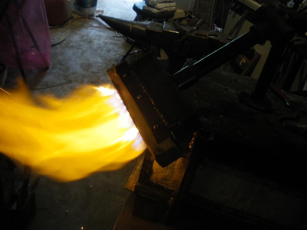

This last pic shows the flame distribution. The burner on the right still had crud in it and evened out nicely once I got it clean.

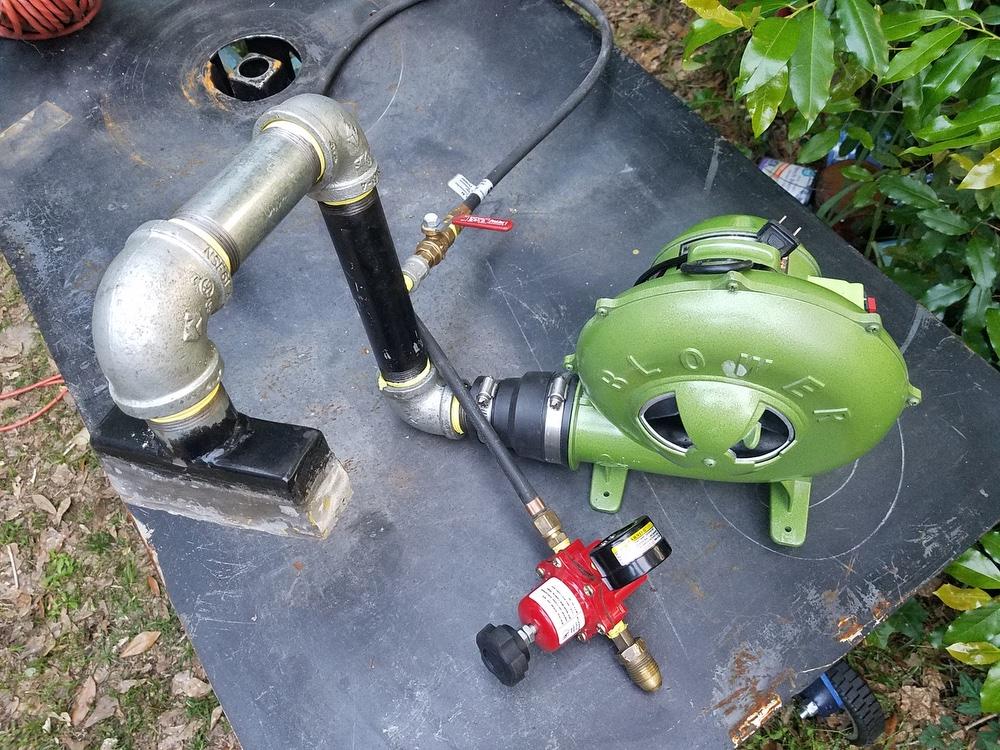

This thread is super educational, as I have a similar issue to the OP, and one more as well...
I've learned from this forum and elsewhere that one of the great benefits of a forced air ribbon burner - in addition to the great heat output - is the fact(?) that you save so much propane. Mine does not. My first and only new forge of this kind requires NO LESS than 10psi on the gage, or the flames will cease entirely. What would lead to such high pressure requirement on the fuel?
The burner I made is really small at about 2x6 inches and has 26 holes to try to match the open area of 1-1/4 inch pipe. Like the OP, I do not get a healthy flame from the ends, PLUS the flame goes out at less than 10psi. This IS an open air test of the unit. The furnace itself (yet to have the burner) is quite small, with an open area of approximately 8 inches length by 4-1/2 inch diameter. From comments, I see things will behave differently in there.
Note also that, even though the flames look neutral to me, there is a good hint of yellow flame a few inches away from the blue. I'm sure that is a clue to something. Sorry, no photos of flames yet.
I do have a normally aspirated two-burner forge I have used for years, but this ribbon forge is totally new to me. Thank goodness for this forum!
The assertion that a forced air ribbon burner uses significantly less fuel than other options is mostly myth.  Regardless of how you deliver the fuel, it takes a certain amount of fuel with the correct amount of air to produce a given amount of heat in a certain amount of time.  There's no getting around this; it's just chemistry and physics.  There is a slight caveat to that. Multiport burners, such as ribbon burners tend to not have quite as "fast" flames.  What that amounts to in simple terms is that a little more of the heat can stay inside the forge longer before it's pushed out.
Where a fair amount of the confusion seems to lie has nothing to do with the volume of the fuel being delivered, but the pressure at which it's being delivered.  Naturally aspirated burners rely on high pressure small fuel streams to induce the air needed for combustion.   We accomplish this by using a small fuel delivery orifice.   With forced air burners there is no particular advantage to using a small high pressure stream, so the fuel delivery line typically has a much larger orifice.  The result is that even though the volume of fuel delivered may be identical, the pressure is much lower. For this reason, your reported fuel pressure really doesn't tell us anything valuable at all.  We don't know how large your fuel delivery orifice happens to be.
For some people the lower pressure equates to less fuel used in their minds.  From my personal experience my impression is that switching from a single port burner to a ribbon burner (both naturally aspirated using the same mixing hardware) resulted in a slight decrease in the fuel used to achieve and maintain the same temperatures in the same forge. I only ran a forced air burner for a short time and it was not a ribbon burner, so I can't compare anything there from personal experience.  What I can tell you is that for a forced air burner with independent fuel and air supply controls you should be able to get whatever atmosphere you want from very rich to very lean (and everything in between) very easily by adjusting the fuel and air as needed.
For what it's worth I have not been able to mathematically determine how much total cross-section area the combination of the burner outlets should be compared to the delivery tube for a multiport burner.  There are too many variables to take into account for me.  For instance, a single port burner only has friction on the inside of one delivery tube, whereas a multiport burner has friction to take into account in every outlet, and that is also affected by the material used and the surface area of the outlets.  That's just one thing.  My observation for the naturally aspirated ribbon burners (NARBs) I've made to date is that the sum of the area of the outlet holes of the ribbon burner were usually at least 3 times the cross-section area of the mixing tube that delivered the fuel to the plenum, but I always end up fine tuning by starting with more holes than needed and plugging holes until I find the number that allows for good operation.  A forced air ribbon burner should allow for more latitude in the number and size of the holes compared to a naturally aspirated burner, but there are certainly limits to everything.
When your flame "goes out" is there a somewhat loud pop, does it blow the flames off the end of the burner, or does it seem to you that it just disappears?
My first impression is that's a lot of blower for a small ribbon burner.  I have a few questions for you though.
1. If you completely close the blower input gate do you still get significant air out of the burner holes?  If the answer is yes then you need a better way to control the air, such as a gate valve.
2. Does your regulator have a minimum pressure or will it let you turn the gas completely off?  If you can shut the gas completely off then the regulator should suffice for your gas control.  Just leave the ball valve wide open and control the gas with the regulator.
3. Did you build a diffuser/baffle plate into your burner construction?
If you are blowing the flames off the burner that's a good indication that you have too much air pressure.  When installed in the forge there will be some back pressure to compensate for this, but you really should be able to get it burning in the open air.  The size of your gas delivery orifice is on par with a 1"to 1.25" naturally aspirated burner, so 10 psi is a LOT of fuel compared to the size your ribbon burner appears to be.  Without knowing the number and diameter of the holes I can't be sure, but I believe you just have way too much air and fuel (currently) for that burner.  If you can decrease the inputs with more precision you will probably be able to make it work though.
I concur, the cross section area of my crayon dia. outlets is approx 3x the cross section area of a 3/4" T burner.
The reason Phillip's burner doesn't pop when he shuts it off is because he turns the propane off while the blower is running so there is never a flammable mixture in the plenum that isn't moving. This is an advantage of GMOBs (Gun Multiple Outlet Burner) or the venerable GRB (Gun Ribbon Burner) You can let the blower cool the burner block and forge after you're done with it for the session.
Phillip: I heartily concur on your placement of the gas jet, the farther and more turns the mix has to pass the more thoroughly they mix. Propane is an unfriendly gas where air is concerned it doesn't mix easily, left on it's own it will separate.
Nice burner by the way, I agree it could use better control of the air and I disagree about using the regulator as the fuel control. It requires more pressure i the propane supply than the static pressure in the mixing tubes or it can't deliver. A needle valve right after the 1/4 turn valve will give you precise fuel control.
Were it my set up I'd mount the 1/4 turn valve between the regulator and gas hose and the needle valve between hose and gas jet. Let the hose drain when you shut it down, no good reason to leave it pressurized to bleed over the next hour or two. It's not much propane but it doesn't take much hiding in a floor drain or something to provide an energetic welcome to the next spark.
He didn't state that he shut the gas off, just that the flames went out. Additionally he said he could still smell propane (the indicator anyway) after the flame went out.  So, if he was running both gas and air and the flame went out it should either have the pop/backfire or the flames were blown off the end of the burner due to the speed of the FA mix being greater than the speed of the flame front.   He's indicated that the latter is the case.
I think I understand what you are saying about the static pressure, but in my mind at least if he's running several psi of static air pressure in the whole system - enough to prevent the propane from flowing - while its flowing through the burner ports (as opposed to a closed system) it would be way more air than needed with that diameter of piping. So, he'd either need more/bigger outlets on the burner to decrease the pressure and keep from blowing the flames off the end or less air. Either way, even if a needle valve isn't necessary it certainly won't hurt anything and can provide maybe even a little more fine adjustment.   I was just trying to help him get up and running with the least amount of hassle.
Thanks Guys - I'm really learning thanks to you and this forum.
Yes, it is closed in these experiments. Not visible in the photo, but there is an arc-shape slot -- maybe a square inch in area -- just below the movable vanes (no doubt to prevent burnout of the motor), so there IS still enough air blowing to fill a typical 13 gallon kitchen trash bag in about 3-5 seconds...if I recall correctly but unscientifically.
The 30psi regulator can visibly go below the 10 I noted above, all the way down to zero, so fuel still flows until the adjusting knob is turned counter clockwise to less than "0" on the dial. At that point, the knob becomes very lose, just like the gages do on oxy/acet tanks. In fact, this is just like the regulator on my old 2-burner (not forced air) forge.
Yes, I've attached photos showing that part.
AND, Frosty , I just ordered the needle valve. It surely might help! Thanks again, fellas.
With all of that in mind I still think the main issue for you is too much air for that burner.  If you get a needle valve you can test for the static pressure issue by turning the pressure up at the regulator past 10 psi (the point where you indicated the flameout issue) and then regulate the flow with the needle valve.
I think you will find that if you can tame that air supply with a way that you can make small adjustments (like the aforementioned gate valve) you will be able to keep the flame lift minimal to none in the open air.  In my mind you should be able to run that burner at a significantly lower gas pressure than 10 psi if you can get the air flow decreased to match the fuel delivery better.
