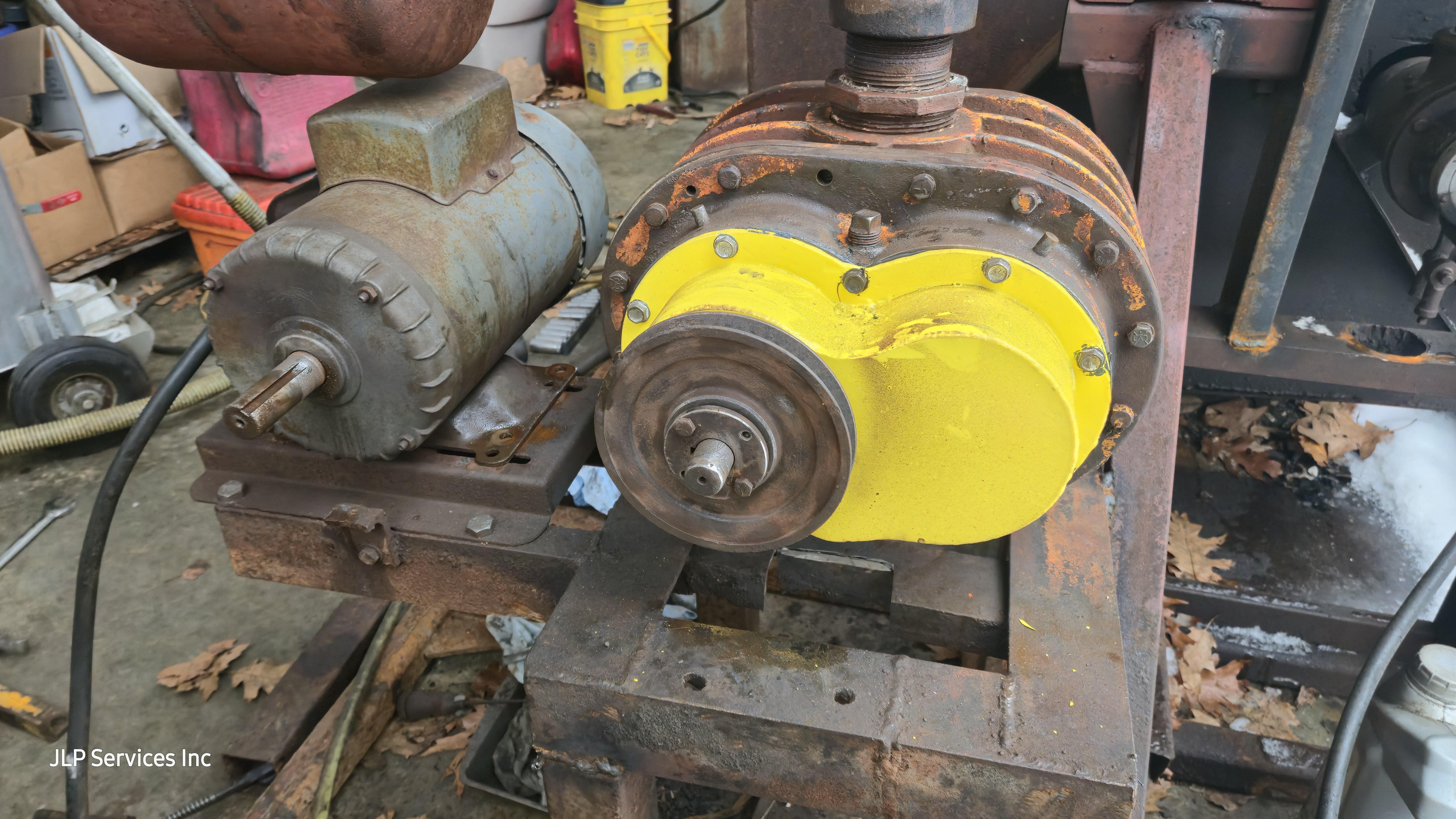

jlpservicesinc Posted December 5, 2025 Author Posted December 5, 2025 Last few days have been slow. We got hit with a snow storm and it depresses me since I have to work in it. I did find the gumption to pull out some 1/8" sheet and mark it out and today I machined the seat for the oil seal. This blower oil cover is coming out great. First time building such a thing. I will plasma cut out the cover and weld it in place after I verify the standoff height. I'd like to be able to replace the oil seal by removing the pulley only leaving the cover in place yhen using a pulley or screw grab the seal from the outside and pull it. Install the new seal in place.. I was thinking originally about fillet weld with the holder mounted proud of the cover. Now im thinking drill a hole large enough and do a face butt weld. Quote

jlpservicesinc Posted December 7, 2025 Author Posted December 7, 2025 Frosty. Your a good dude. I appreciate you making the suggestions.. Thank you.. I was able to get the gear cover done today. Still not the right seal, should be here Monday. But this will allow for me to get the gear case buttoned up and oil in it. The main idea is to get it sealed up for winter. If once the cover is on and we have a day that is decent I'll give it a firing now that all the gauges are installed.. I Should be able to get it dialed in. Burn range is from .79gph to 2.00 gph IIRC. This size of furnace might be to large to do cast iron for the burn rate. Time will tell. Quote
Bull Sigh Posted December 7, 2025 Posted December 7, 2025 Great work and photos. Keep on keepin' on. Quote
jlpservicesinc Posted December 8, 2025 Author Posted December 8, 2025 Thanks Bull, I got it fitted, oil drain put in with 1/8" NPT plug, I was able to get the pulley off the drive motor to get the alignment adjusted.. It was so rusted. I've got probably another hr before it's operational. I'm running motor oil in the gear case for the first run up. I'll drain it after a few burns.. I tried to get the gear box side as clean as possible but there was a lot of rust dust, oil oil residue and such. I tried to clean it 6 or 7x.. Problem is the ooz inside would just blow around vs out.. So a few oil changes will do wonders. According to USPS tracking, seals should be here tomorrow. I decided to pull the old seal before installing the cover and this will expedite installing the new one tomorrow. I was able to get the motor pulley cleaned up on mounted back on the motor.. Of course now it's like it's new.. Also had to fix the sq key, and install a new set screw. Quote

jlpservicesinc Posted December 10, 2025 Author Posted December 10, 2025 Bull blessings. I work outside and winter get less and less fun. On another forum I frequent one person mentioned these blowers are nearly bomb proof. They use them for ventilation so they get dust in them. The way they clean them is they dump water in while running. I fired it up yesterday with less than the results hoped for. My electrical supply is lack luster for a 3hp 120v motor. I was hoping to stay 120v but my current cord is 10awg 150ft long. To long with to much drop and average pull to maintain full speed with thickened oil in gear box. New oil seal installed. Of course it was 10F here yesterday. But.. Well, if hunkerin down is in your future. Enjoy. My schedule doesn't change with the seasons. Just output. 20251208_121100.mp4 Quote
Frosty Posted December 10, 2025 Posted December 10, 2025 The weather isn't doing you any favors. Ours is just heading for hard cold though not as cold as it was 50 years ago though. Still it's -5f and falling as sunrise approaches. Do what we do up here, use a synthetic gear oil, they do not get stiffer as the temp drops and drop wear particles easily so if you use a magnetic drain plug it'll clean up the old rust and wear particles you couldn't clean yourself. It took me some delving a few years ago to make sense of multi weight oils. How can oil be 10w when it's cold and 40w when it's at engine operating temperature? I don't know what the oil companies were thinking to use that kind of description but it's physically impossible for a liquid to the thicker as it gets hotter. What 10-40w oil actually means is the 10w viscosity oil has the lubricating film strength of a 40w petroleum oil standard. In truth synthetics change viscosity VERY little with temp. The price of a quart might scare a body but when you consider the modern synthetics can go tens of thousands of miles and not degrade it's really cheap. A quick search hit 75-90 gear oil ranging around $12.00 to $22. / quart. The thicker viscosity is so the oil sticks to gears and doesn't need to be slung in the case to lube everything AND provides some shock cushioning between gear cogs. Unlike internal combustion engines which experience mostly sliding friction and are lubricated by pressure so thinner oil is necessary. Synthetics also don't degrade seal rubber like petroleum oils so your seals will last a long darned time, IF the shafts are polished. Frosty The Lucky. Quote
