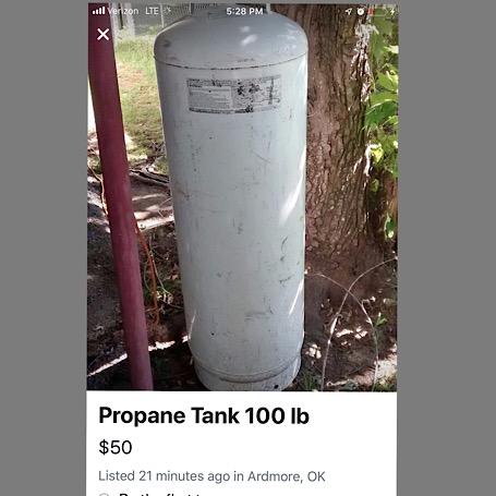

I've got a friend who had to live in a trailer for the past 10 months while his house was being added onto and remodeled.  He bought a trailer and a 100 # propane tank to handle their needs.  He's moved into the house now and selling the trailer.  I asked what he wanted for the tank and he said $100.  That's a pretty good deal for basically a new tank isn't it?  It would be nice to not have to scavenge the small tanks off my little Casita travel trailer.
It's probably a pretty good price here, I don't know about Central Oklahoma. What do you think? Checked online ads?

100 USD is about what you would pay for a new one, Chris, but $100 for a barely used one now isn’t bad.
Unless you want to drive to Ardmore.
Driving there would burn up about 6.7 gallons of fuel and cost you about 2.5 hours. What else could you have done with the 2.5 hours?
Dangit,  DHarris, I just got home from Davis.  Wish I'd known about that tank, I'd driven a little further South for it.  Oh well, I'm always  "an hour late and a dollar short"!
