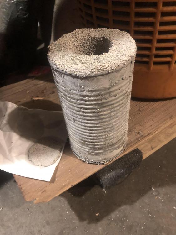

AngryDaddyBird Posted January 13, 2019 Share Posted January 13, 2019 For several months I been using two propane torches to try my hand and forging small steel stock into flint strikers and other things. One is a bernzomatic BZ8250HT and the other is a modified Old bernzomatic all brass torch. Both are regular propane/mapp torches. I been reading for months about what forgeto buy. Then decided since I don’t know if I really want one I’ll just make an easy mini can forge. Used Koawool, Kast-O-Lite 3000 and Metrikote. Heat source will be my modded torch head. I do have a few atlas burners and regulator hoses from atlas. The 30kband dual 150k setup but think I’ll save those for a nicer build. This was a fun build and works. I tried to angle the heat into a swirl and it does it well! It’s my first try so lots of mistakes and lots of things I’ll do different on my next bigger build. I’ll make the next one with a 5” diameter chamber that’s 12-15” long. Heres some pictures. Quote Link to comment Share on other sites More sharing options...

Mikey98118 Posted January 13, 2019 Share Posted January 13, 2019 You are correct that you have some construction errors. Nevertheless, you have done quite well, and I recommend that you transfer it to the permanent Forges 101 thread. Lots of people are interested in making coffee-can forges that run from cylinder-mount propane burners, such as yours. Quote Link to comment Share on other sites More sharing options...
AngryDaddyBird Posted January 14, 2019 Author Share Posted January 14, 2019 14 hours ago, Mikey98118 said: You are correct that you have some construction errors. Nevertheless, you have done quite well, and I recommend that you transfer it to the permanent Forges 101 thread. Lots of people are interested in making coffee-can forges that run from cylinder-mount propane burners, such as yours. I’ll see if I can figure out how to transfer this. Yes lots of errors like kast-o-lite over the koawool. Any advice is appreciated!! How can I transfer this to permanent firges 101? Quote Link to comment Share on other sites More sharing options...

Mikey98118 Posted January 14, 2019 Share Posted January 14, 2019 Well, its here now, so lets go on where you are. It looks like the torch head isn't modified, and is just used close outside the portal. This is the first time I've seen an air/fuel torch used this way, and yet still sufficiently heating the forge. So, let's discuss the forge construction first. Quote Link to comment Share on other sites More sharing options...
