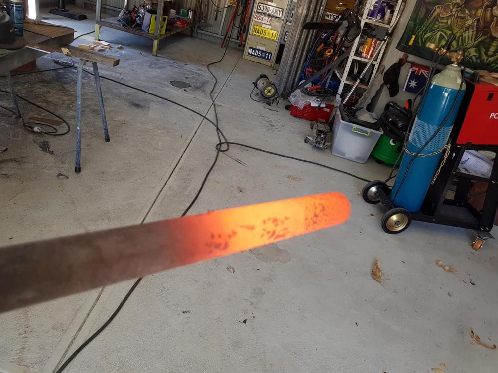

Ok. In my "built my first Jabod" post, you can see I had it down at a steep angle. As the day went on, I was working it closer and flatter to the top in an effort to not burn the steel.

I think the problem I had was a combo of placing my work at a steep angle, and having to much air flow since I was using an air mattress inflator.

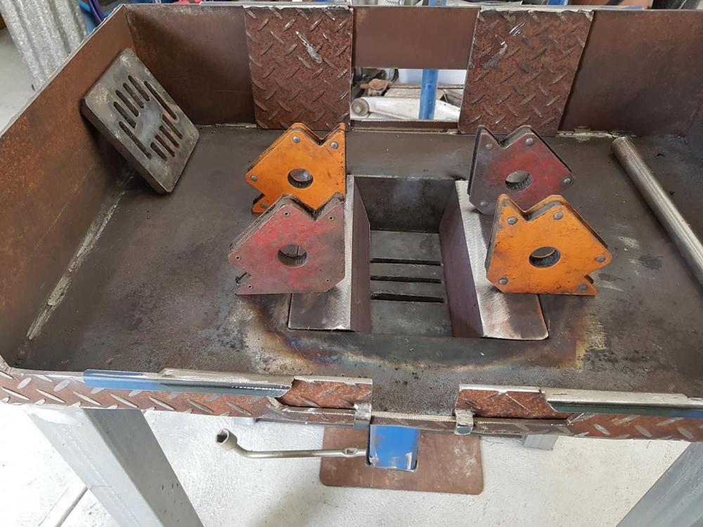

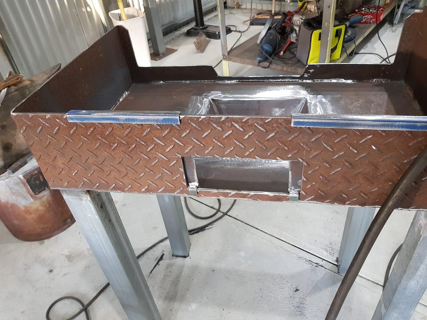

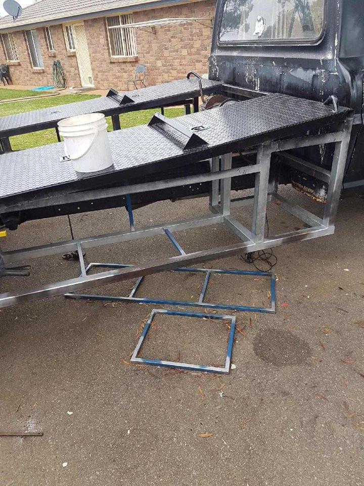

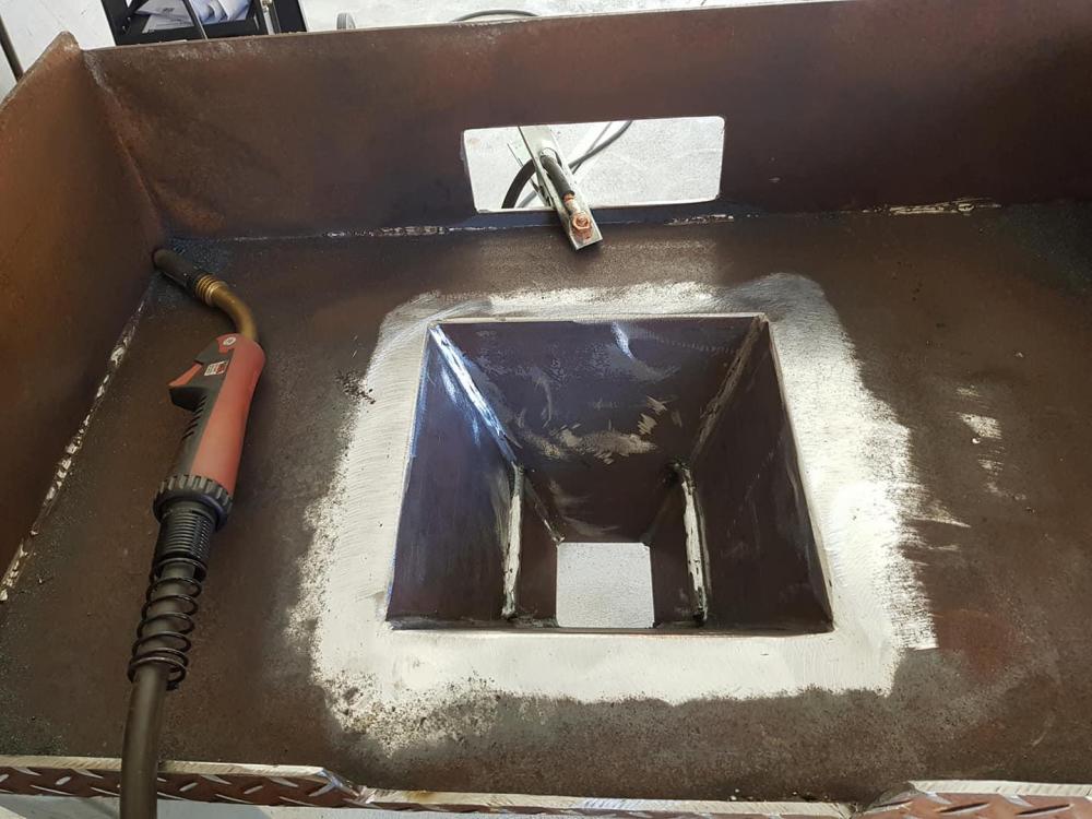

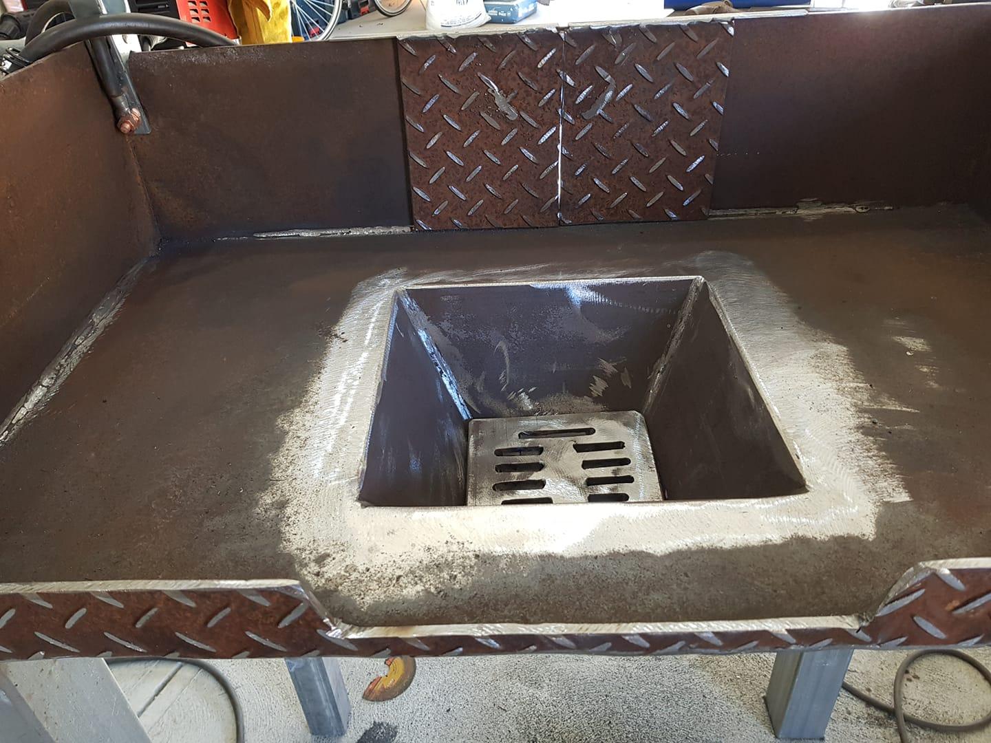

Had to replace the 3 year old underbench oven all day yesterday, anyhow got a few things done also going to do the front door similar to the rear two, I reduced the amout of slots as you can see my  height base plate is next then ill do the underside after.
Why thank you very much VainEnd84, it is a learning work project i've always wanted to get into, funny really when its been said by many of my friends over the years that what we do for a living we are not supposed to like doing at home. OFF Topic LOL a few things at home and at work, this is who I am, i'm just gunna put another pic up, the last one please lets not go on about it, it just shows how much steel is part of me haha

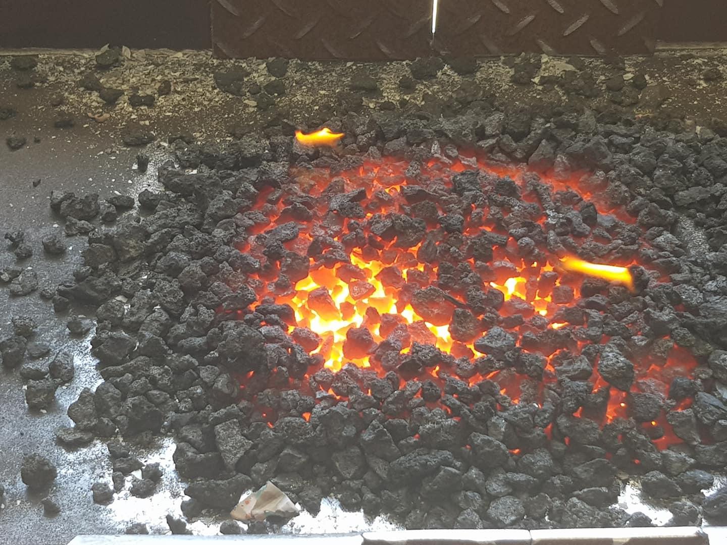

Modify your fire shape and size to fit the project at hand. Try putting a piece of pipe, say 4 inch diameter, into the fire pot and just below level with the bed of the forge. Fill the area between the pipe and original fire pot with ash or non-combustible material. This will reduce the fire size and create a small hot fire for use on ends, twists, etc when a larger heat zone is not heeded.
For a long fire, use or make a piece of rectangular tubing to fit inside the fire pot.
 It will also save fuel.
If you find a shape fire you like, weld up a base plate (that fits the bottom of the grate) to the extension you like and keep it on hand for when it is needed. Makes it easy to clean out the fire pot, insert the modifier, fill the remainder with ash etc, and light a fire. When finished just remove the modifier. Think of it as your new rose bud. (grin)

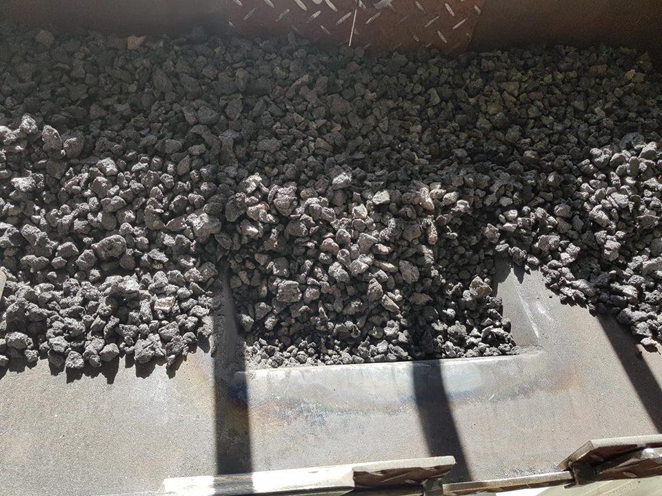

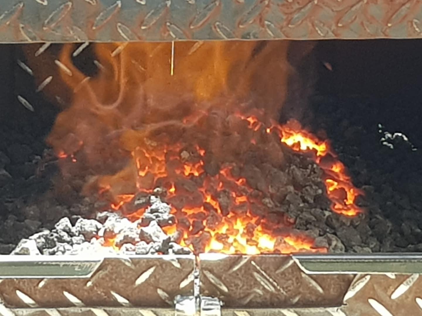

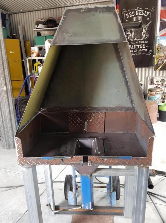

Cheers yet again Glenn ! ok a lower front wall to suck the exhaust better it sounds more logical looking at this first photo, I did want to know how high to lift it but that is also said! Im curious as xxxx second photo how hot did it get roughly, I worked five years in BHP and watched the big digital Dial say when the steel was formed  ! and from memory it is 1430 C, 2606 F, so what do these get too? Also ive completed my version of your fuel saver idea cheers for that too. second to last pic she cleans up so easy thanks again for what im learning.
May I suggest you stand at the front of the forge and lower the front of the hood to where you can still see the pass through door. If your concerned then the top half this distance can be solid and bottom half can be hinged to swing up and out of the way. A catch would be advised to hold it in place when in the up position. See red lines in the photo below.
Suggest you hinge (or allow for removal) the side panels from the top of the forge walls to the bottom of the front hood cover. This should substantially reduce the open area of the hood and allow the chimney to suck the smoke from the forge up and out the chimney. Practice with some thin sheet metal until you get what you want. Plate steel is not needed for this, just thin tin. After all your only blocking the air.
What size is your chimney diameter?
If there is a lack of draft, then close or block either side from the top of the forge wall to the floor of the forge. Sample pieces of thin tin will work to practice with until you get what you want. See green lines in the photo below. Lines are approximate. When the mobile panels top and sides are swung open, the open area should provide full access to any project you you want to have in the fire.
It is all about playing with the system, and making modifications, until you get what pleases you. Please let us know how it turns out.

What size is your chimney diameter?;; the chimney is 11"
Please let us know how it turns out. :: No worries ,im back at work from Monday so I wont be doing as much as ive been doing,so it will be steady as she goes from now on.Thanks again for your wisdom Glenn.

Took good advice all was fantastic today MKIII Test im happy as !
Does the hood remove the smoke from the work area to your satisfaction?
Is the size and shape of the fire good for getting your project metal hot?
Do things get hot quickly enough for you?
Did you try to cut back on the air flow and use just the amount of air required to get the heat you needed from the fire?
Nice job on the forge build. Be sure and post photos of your forged projects.
1: yes very good!
2:Outstanding!
3: scarily in a way!
4: yes have a great adjustment with the air feed!
