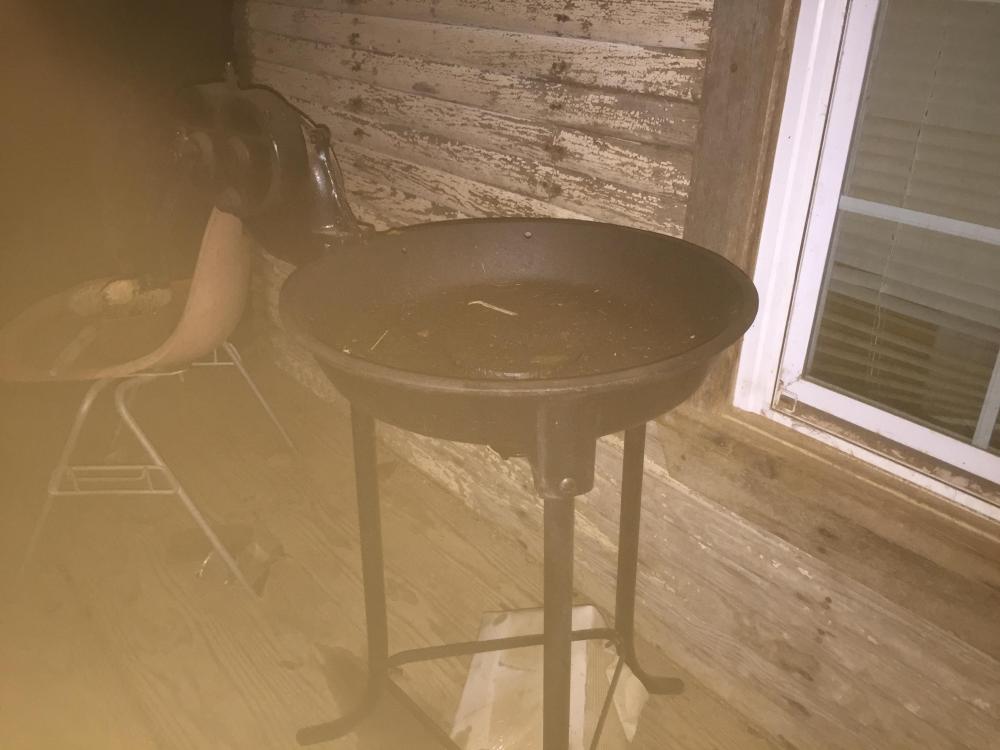

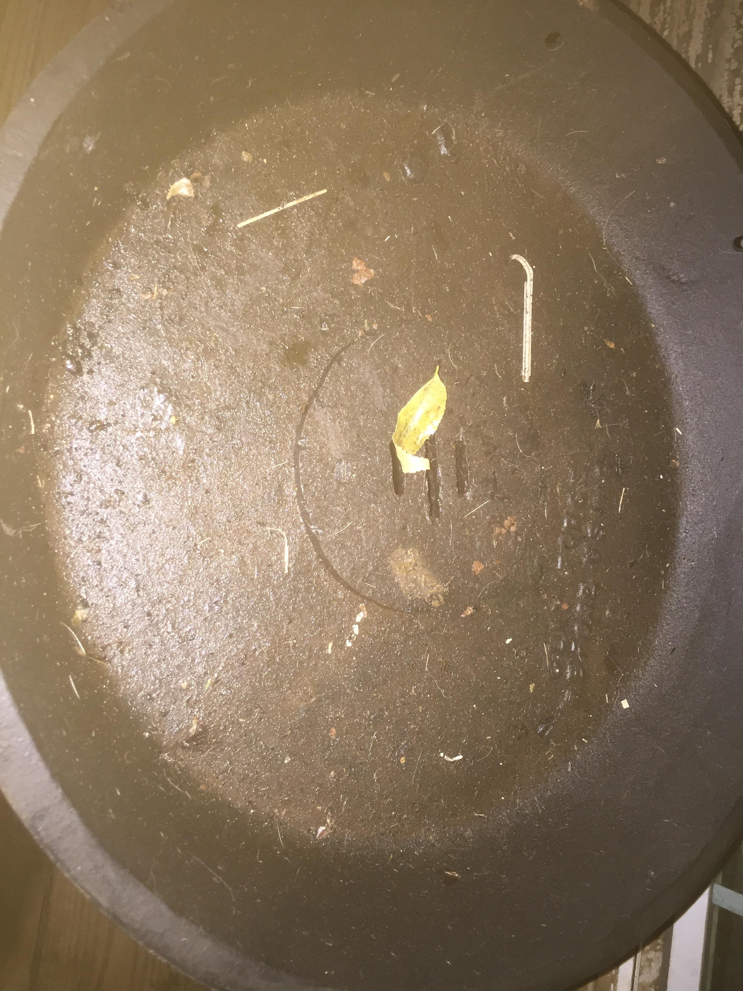

Hey all, I'm fairly new to this and this is my first forge so please bear with me. I'm currently trying to decide on a design for a coal forge.
I have this old fire pit (28in diameter, 7in deep) that I plan to use as my fire pot, the metal is thin so to prevent the fire from burning through I was thinking of using cement rated for 2,200 F to coat the inside. I also want to have a table that has a hole cut in the center that the pit fits into. I have two options for the table. I can either buy a 1/4in thick steel plate from craigslist for 60$ (I would also have to cut it down to size, but I don't have the tools to do that)
Or I can use some 3/4in thick 95inch long and 18 wide. You probably noticed that the wood is not as wide as the pit, to remedy this I would cut the wood in half and put the two sides together making it 47.5 in long and 36 in wide. My questions are, is wood a viable option? If not is there a cheaper option than the steel plate? And is there any other comments on the design?

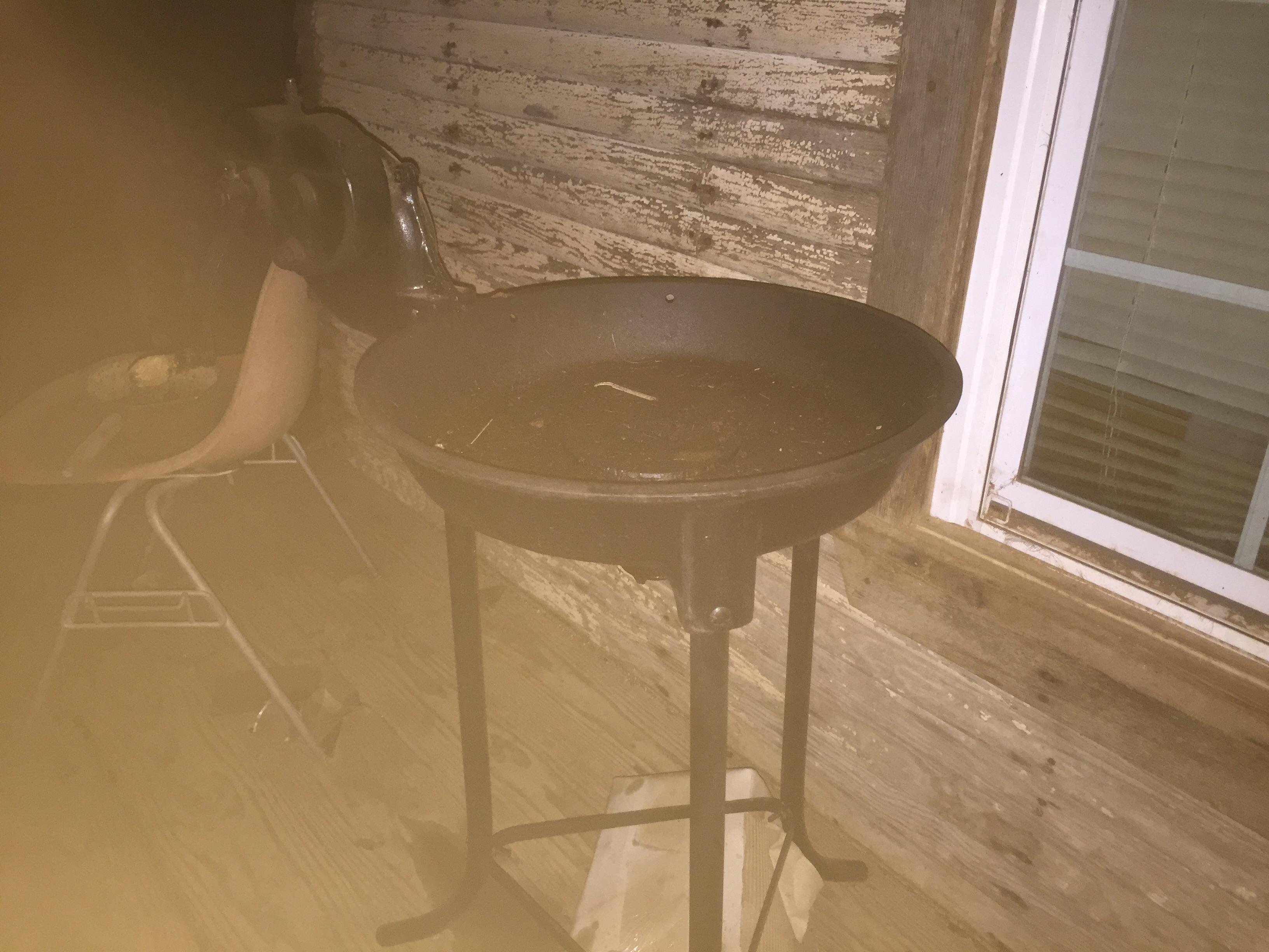

Sorry for the horrendous formatting, also here is another photo I forgot to add
To be honest, I think you would be better off building a JABOD forge like this one.
If you are determined to use your fire pit consider making it a side blast but don't use the 2200 degree cement but line it with clay.
Priced this week at two different big box stores, a 1 x 12 x 8 foot common pine sheeting is over $21 a board, knots, splits, and bows included.  That is a rare piece of lumber. Find a better use than cutting it for a forge.
Find an old pallet at most any store for free and take it apart. More than enough wood to make a JABOD forge. Did I mention free? So get two of them in case you need one for a project later. You will also need a piece of 3/4 or 1 inch black iron pipe, and some dirt. If you can not find dirt in Upstate New York, then pay the extra money and get a bag of NEW, not used, cheap kitty litter. One bag should be enough.

It may not be thick enough metal. Suggest you make the JABOD forge first so you can have a forking forge while you think about what your second forge will look like. (grin).
While the wood does look quite nice it is a laminate unfortunately, so don't be fooled. I have been considering the JABOD as another option, but I have a few questions, one being, can I just use any dirt or does it need to have a lot of clay in it? Furthermore, can the size be increased without worry or are there other factors that I would have to take into account?
Most any dirt will do. Any organic matter will burn out with the first couple of fires.
If you make the forge according to the provided design, it should work. A bit larger will not hurt. You want to establish a fire ball to forge in. The forge size beyond that is usually ends up as fuel storage or a place to put tools.

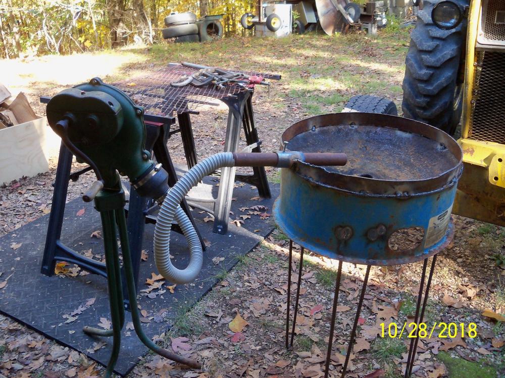

You can make clay with cheap unscented cat litter and sand. Why cut the fire pit in half, just drill a hole in one side to fit a side blast tuyere pipe in it and clay it in or use bricks to form the fire box. Here is one I'm making for charcoal, just need to find time to clay it up.
