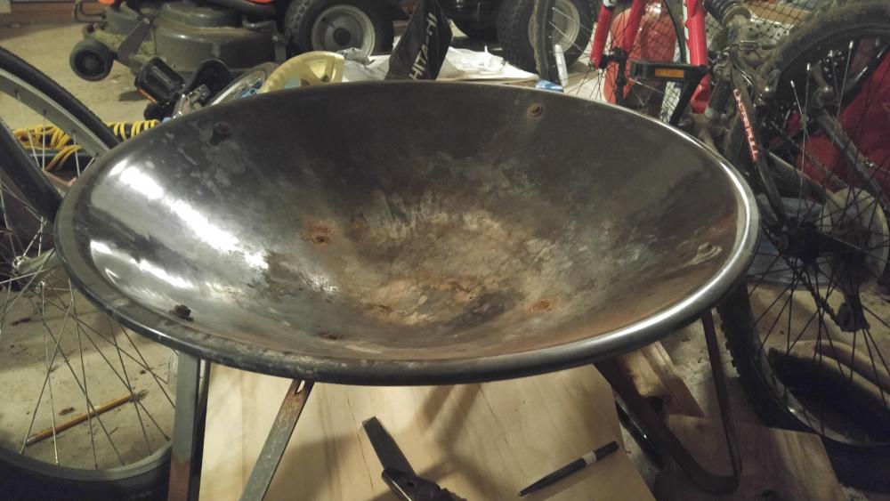

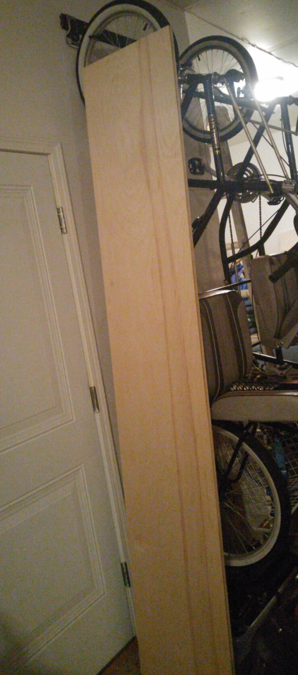

  5. Hey all, I'm fairly new to this and this is my first forge so please bear with me. I'm currently trying to decide on a design for a coal forge. I have this old fire pit (28in diameter, 7in deep) that I plan to use as my fire pot, the metal is thin so to prevent the fire from burning through I was thinking of using cement rated for 2,200 F to coat the inside. I also want to have a table that has a hole cut in the center that the pit fits into. I have two options for the table. I can either buy a 1/4in thick steel plate from craigslist for 60$ (I would also have to cut it down to size, but I don't have the tools to do that) Or I can use some 3/4in thick 95inch long and 18 wide. You probably noticed that the wood is not as wide as the pit, to remedy this I would cut the wood in half and put the two sides together making it 47.5 in long and 36 in wide. My questions are, is wood a viable option? If not is there a cheaper option than the steel plate? And is there any other comments on the design? Sorry for the horrendous formatting, also here is another photo I forgot to add

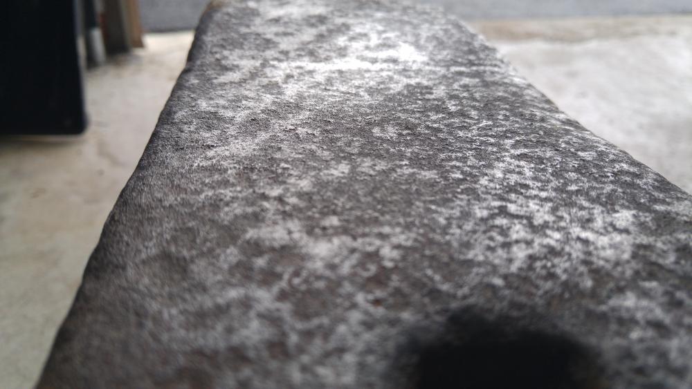

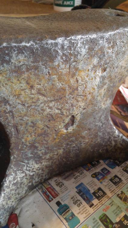

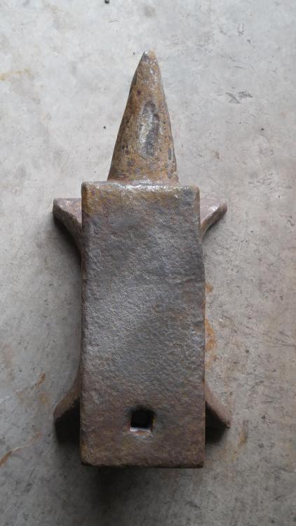

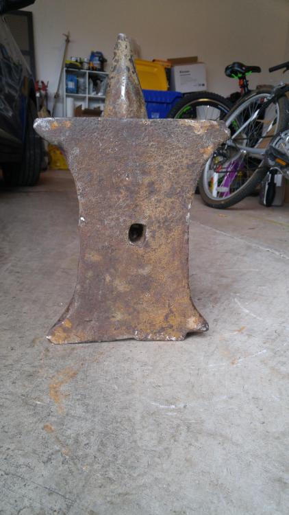

  7. Recently got a new anvil; however, after going over it with a drill with a brush attachment and giving it a 24-hour vinegar bath I can't find any markings. The only information I really know about it is that it is 130 pounds. I've also noticed that it seems to be a colonial style anvil, unfortunately, that is where my knowledge ends. Hopefully, you guys can help identify it. Any help is appreciated, thanks in advance.
