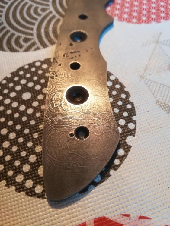

Hi Folks,
I've got a little problem. I made a pattern welded steel of 1045 and an old file. So there are no other alloys worth mentioning in it (except of carbon of course). It's the first try and the package welded perfectly. The first etch in ferric chloride for 10 min showed a nice pattern. But after heat treating there's just a glimpse of a pattern after 1 hour of etching. As far as my experience goes (but with high alloy steel) the pattern becomes more intensive after hardening. Anyone with some more experience in pattern welded steels out of "pure carbon steel"? I just don't want to ruin the blade by etching it too long.

I'm sorry, i forgot to mention, that the knife has not been hardened completely. I'll attach some pictures to give you an impression. As you might see, the unhardened handle area has a really nice pattern, the hardened blade area hasn't.

Thats not correct. Our ancestors used only carbon based steels to make pattern welded steels since the late 8th century. And as you can see on my handle there is a well defined pattern possible. The equalization of the carbon depends among other things on the number of welding heats. And it does at every steel, not only the pure carbon steels.
 I covered the speed of carbon migration in my book, so I wont go into that thesis here again other than to say it isnt because of carbon differences because there isnt any.  There are  other accidental elements in even the best made steels only in a lab can they make pure steels,  and that is where the  differences comes from.  But I will invite you to explain what gives the different colors  in steels
c.baum: earlier! - see Sutton Hoo or  the letter from Theoderich "wurmbunt". I guess that the different etching in old blades mostly depends on different contents of phosphorus ( and sulphur and arsenic ). In your case the difference might be the content of manganese, C45 high file low.

don't get me wrong, I'm sure you know what you're talking about. But that's not an explanation for that, the unhardened handle shows a pattern and the hardened Blade doesn't. I can't imagine that all the welding heats didn't effect an migration of carbon and the one short hardening heat does. I hope you can imagine what my thoughts are.
