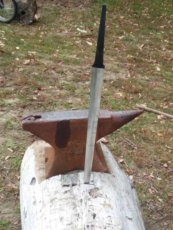

A nerve racking quench and temper turned out a decent blade that flexes nicely and is hard. I wanted to get a feel for it before I try forging one.

Thank you. This was my first heat treat of a blade this long and I am still learning but I heated in a gas forge to about 1600 F and quenched in 150 F oil, and tempered @ 325 F. Not posting this as a recipe, only as a starting point.
2 hours ago, ThomasPowers said:
1/4" to 1/8". It will stab through a steel barrel well enough. How much testing do you guys normally do after heat treat, before finishing?
Basic Flexibility and hardness tests.  No Richard the Lionhearted/Saladin  tests need to be done.  You can stab through a steel drum with a pickax too but it doesn't make a good sword.

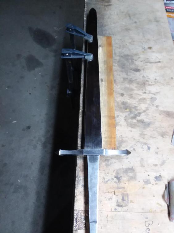

Another setback, I tried cleaning up bevels with diamond files and realized after one bevel the whole thing "bowed". I will try to straighten it at tempering temps. A common occurrence?

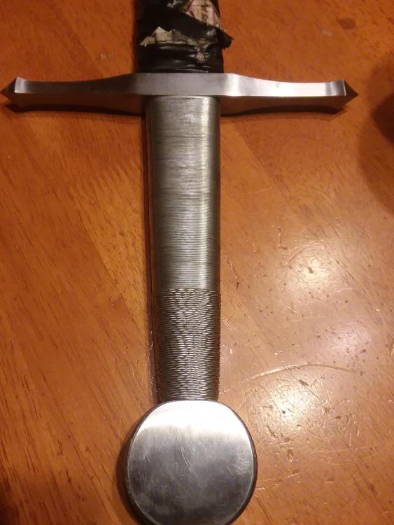

This is where I'm at. How would you guys go about a handle, keeping in mind I will be peening the pomel on. I had considered dowel risers wrapped in some braided line wrapped in leather. Suggestions?

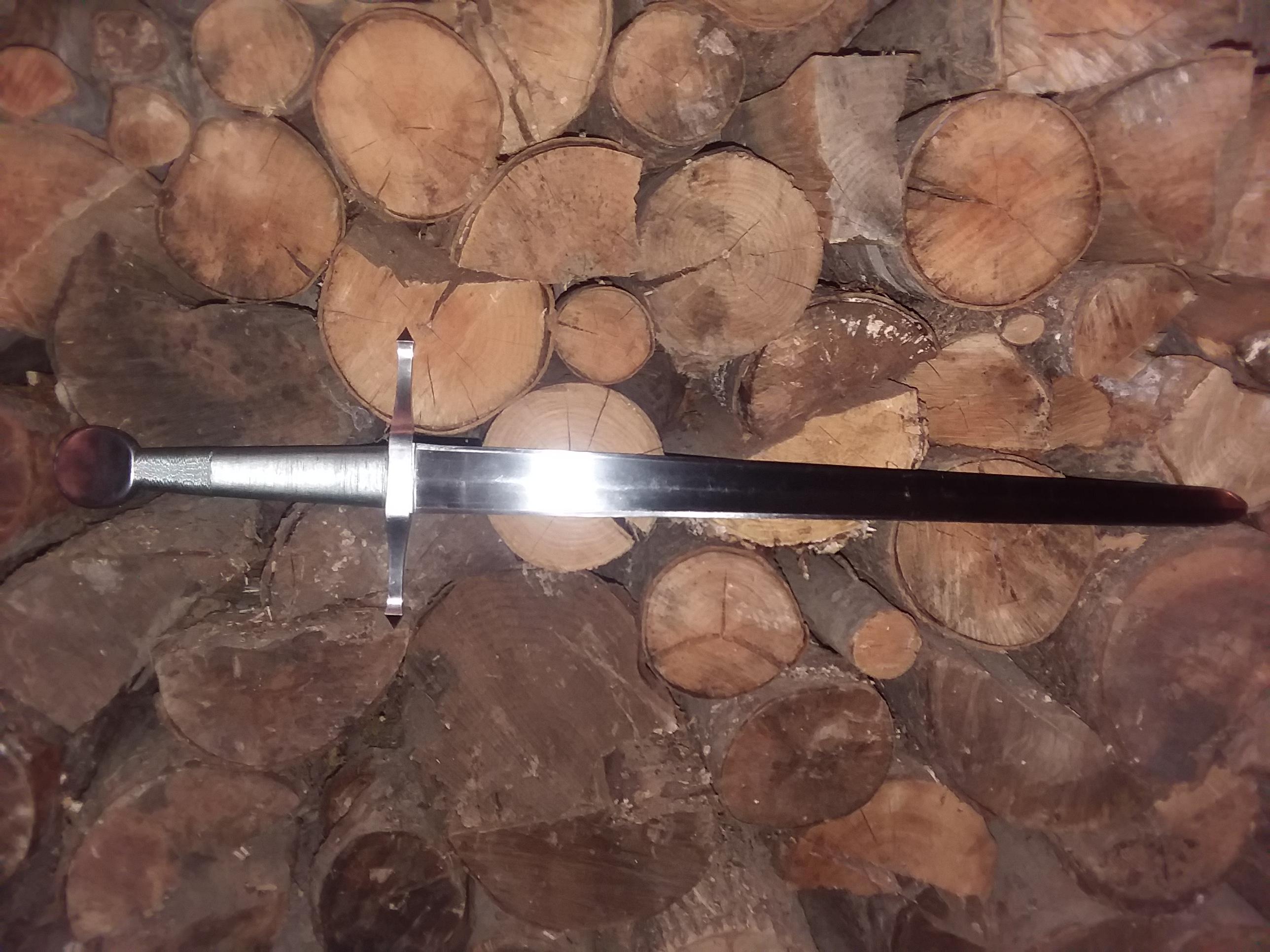

Finally done. Thanks for all the help and the twisted wire wrap suggestion. I never held a sword before making one and now have a great respect for this weapon of war.
OK now for the interrogation:   what's the total weight and where is the balance point?  The grip looks long was it intended to be a hand and a half?
Best estimate on the weight is 2.5 - 3 lbs and the balance point is 1.5" forward of the guard. It is intended to be a hand and a half short sword.
A chopper!   Weight forward and it's on the heavy end.   Good practice blade.  Got a pell?
You'll like using it more if the handle weren't tapered back to the pomel.
Looks pretty good.
I've never heard of  a pell until now, but i will deffinatly be making one outdoors this spring. The blade is heavy but is incredibly sharp. All you can feel is the flex when blowing through frozen milk jugs of water.
I had planned on making a riser between the upper and lower portions of handle but ultimately went with the strongest and most simple way I could.
