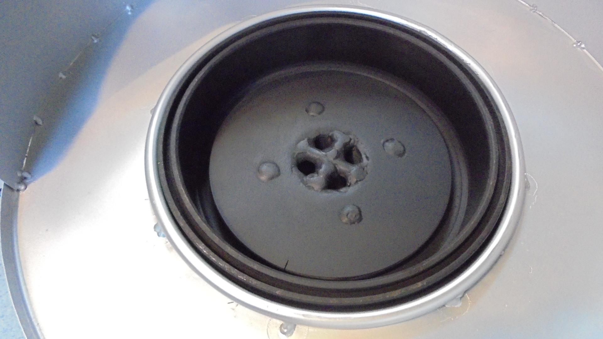

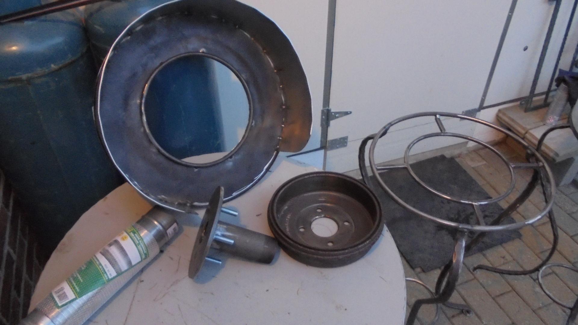

September 2, 20187 yr Hi Joe, this is a ‘steel’ wheel rim (melting temperature at <2500°F) and not a brake drum (melting temperature at +2800°F). So a real brake drum will last much longer. The sketch you mention talk about a brake drum not a rim. Don’t be afraid to ask we really like to help you. Your sincerely, Hans

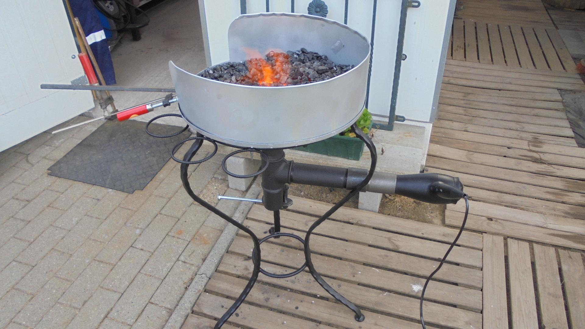

September 6, 20187 yr Author I did not think about a brake drum!! Although, I had the rim available. I dont have a larger brake drum available. Thank you guys soo much this helps alot. Glad I came here! I did post an issue I was having with the blower so far this is where I am with the forge... I'm looking into making it into a side blast now lol
September 6, 20187 yr You don't really want a big brake drum. Look for something roughly 8 inches in diameter and 2 to 3 inches deep for a decent size for forging most relatively small items.
