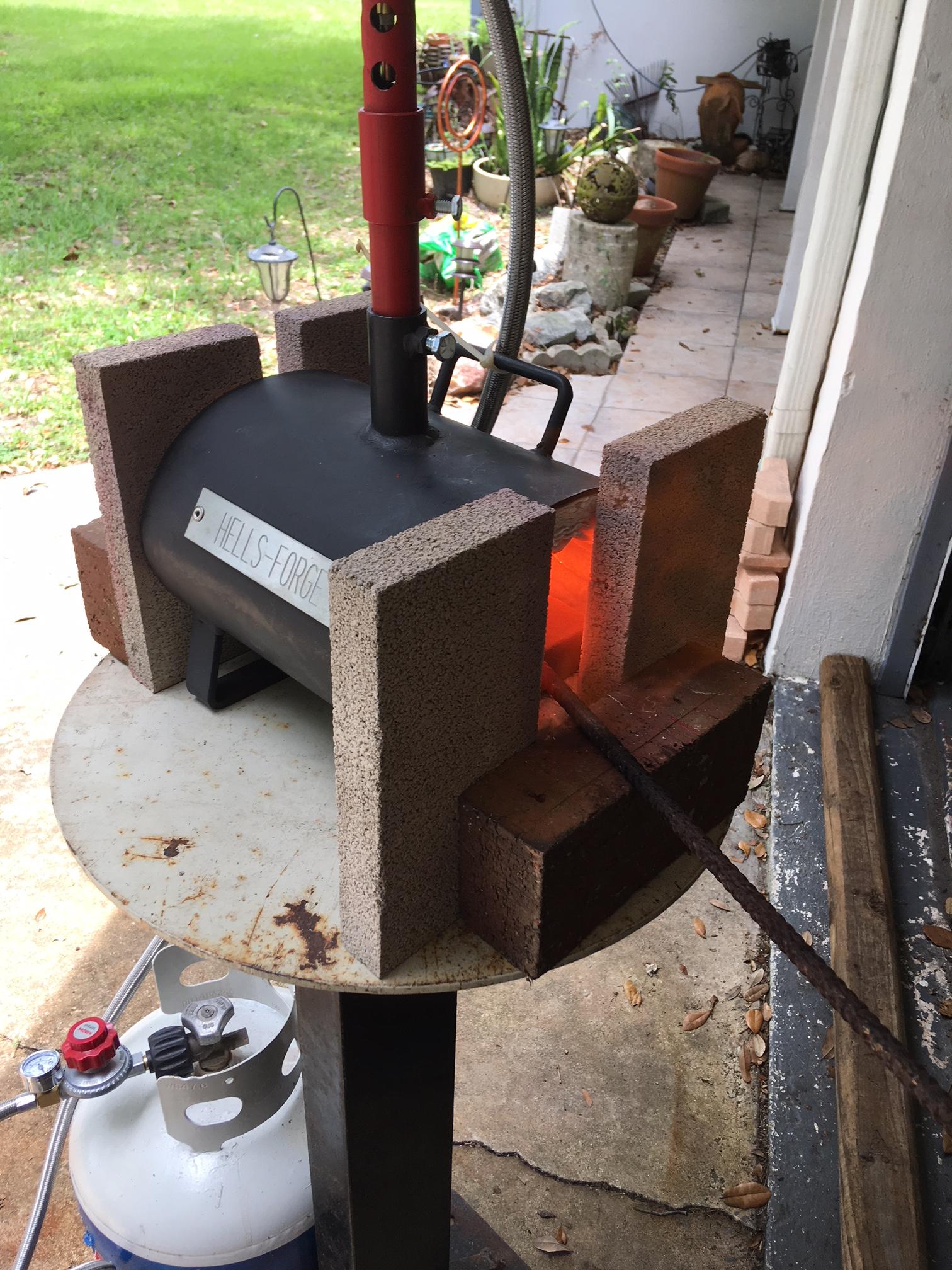

Foamhead Posted June 7, 2018 Share Posted June 7, 2018 I recieved an inexpensive Hells Forge single burner oval forge with 1" spun ceramic with surface treatment insulation and a pretty questionable regulator with no gauge, and no instructions whatsoever which i after one try at lighting it replaced it with a Kibuw 30psi regulator with gauge so my first question is where do i start as far as the air adjustment collar at top and propane PSI? i dont know the size of the tip orifice sombody start me out so my son can pound some hot metal Quote Link to comment Share on other sites More sharing options...

Mikey98118 Posted June 7, 2018 Share Posted June 7, 2018 So, it is safe to assume this is the single burner version. First of all, you have probably lucked into the best design in their forge series. The burner should self adjust its air to the gas flow. The choke will prove helpful for keeping the flame stable until the burner and forge heat up, and for protecting the burner from chimney effects after shutdown. Other than that you should only need the choke when you want to deliberately achieve rich flame. Such tricks are well down the road. You will want to increase the insulation, rigidize it, and seal Coat it EVENTUALLY. To begin with, just buy four hard firebricks, with which to form a configurable opening in front of the exhaust. Give yourself and your son time to learn your forge before trying to due everything possible to it. While you are doing that, read through Forges 101, to understand the fine points of getting the most possible from your very good beginning. Also, I never advise sticking with their original hose; I think it is junk. You will find some advice about where and how to buy a braided stainless steel fuel hose, on the cheap, in the latest page of either Burners 101 or Forges 101. Have fun and make sure your reading stays ahead of your decisions. Quote Link to comment Share on other sites More sharing options...

Foamhead Posted June 11, 2018 Author Share Posted June 11, 2018 Ok got my forge set up with brick 'Doors' which helped to get my first successful test burn and heated a little rebar to see where my temp was i still get an occasional "chimney fire that blows right out and improves and temp comes up in forge but still very unsettling and with the flame "spill out the end i did lose some beard leaning in to puff out the flame should i add a "roof brick at each end to clean up the convection around the venturi? I know i am still not in the category where these posts should be but i will work on refining my 'behavior' in the future, meanwhile thanks for the assist from each of you it has been helpful and supportive IMG_0719.MOV Quote Link to comment Share on other sites More sharing options...
Frosty Posted June 11, 2018 Share Posted June 11, 2018 Are those FIRE BRICKS? If not they're not going to survive long. I ask because they look like concrete pavers but I could be wrong, it happens all the time. Listen to your burner how they sound tells you a lot about how they're burning. The video sounds like it has too much back pressure. Opening the back up a little might help Assuming the choke is open completely, if not open it up, let that baby breath! Frosty The Lucky. Quote Link to comment Share on other sites More sharing options...
Mikey98118 Posted June 11, 2018 Share Posted June 11, 2018 There are a LOT of improvements you need to make, and easily can, on your forge; take your time about making them. I suggest that you begin with Plistex or Wayne's other finish coat, in order to seal your insulation and to raise the temperature in the forge through radiant emission. With a little luck your forge temperature will raise from orange up into yellow, while your forge's insulation becomes much better protected; this simple and inexpensive step will allow you to enjoy your forge and TAKE YOUR TIME in learning how to get more out of your forge, instead of rushing into an attempt to finish it, and botching the job. Re-emission of radiant energy throughout a forge is synergistic with performance of a burner's flame; which is why it is so valuable, and also why it's importance is so hard for beginners to accept. Quote Link to comment Share on other sites More sharing options...
