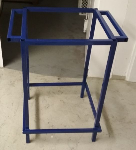

Nanafalke Posted May 19, 2018 Posted May 19, 2018 Hey, a few weeks ago, I started building my first gas forge. I live in Germany and we got those 11kg propane tanks that make a good shell for the forge. For the isolation I use ceramic fibre and fire cement. Of course I used a respirator while working with the fibre. Here are some pictures: And a little stand: Yesterday I isolated the tank: I shaped the interior room oval, I read, that this shape has it's advantages in the Forges 101 thread. If I would build it again, I would probably have moved the burner hole a bit further to the opening, because I put more material in the backside. Now I let it dry 2 - 3 weeks and then I will weld two u-profiles to the front to be able to close the opening with a firebrick and two pipes to the side for a workpiece holder. Feedback is highly appreciated Best wishes Quote

Mikey98118 Posted May 19, 2018 Posted May 19, 2018 If you used refractory mortar/cement, it isn't too late to overlay it with a light coat of castable refractory or Plistex, etc. Basically, mortar/cement isn't able to deal with direct flame impingement. That said, what's done is done, and you should just move forward. You are wrong about moving the burner closer to the exhaust opening; it is common to see forges with the burner close to this opening; that doesn't make it right; it just means we get tired of pointing this out. Intentionally or not, you put the burner in the right place; don't move it. Quote
Jackdawg Posted May 19, 2018 Posted May 19, 2018 Looking very nice. What are you going to use it for? Finding yourself a firebrick or two to sit inside as a floor that your stock can sit on can be helpful to make the lining last longer. Also acts as a sacrificial floor if your going to use borax. I made a flat spot in mine to support a fire brick, but have not got around to getting one,the flat floor is doing okay, but definitely starting to powder up where I scrape and scratch it with the stock going in and out. Quote

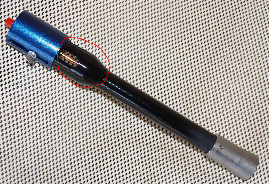

Nanafalke Posted May 31, 2018 Author Posted May 31, 2018 Thanks for your feedback. Actually, there are 3 videos and there is no picture of the flame. Maybe you refer to the preview image of one video? I searched for a 3/4" burner on hybridburners.com and found this. Is the part I marked referred to the flame retention nozzle? I properly mounted the propane supply with 6 screws now and tested again. Here are the results: If you can't see the vimeo videos, here are the links: https://vimeo.com/272741216 https://vimeo.com/272741527 Picture of the flame, 0.2 bars If the burner doesn't burn as hot as expected, I still can convert it to a t-burner. Just thought why not try building one with parts I already have at home. Best wishes Burner at night.mp4 Burner light.mp4 Quote
Mikey98118 Posted May 31, 2018 Posted May 31, 2018 No; the flame retention nozzle (AKA nozzle) is at the forward end of the burner, and is the stainless steel part. Meantime I have seen a much worse problem on your burner; you only have a plain short MIG contact tip. You need a long tapered contact tip; this problem is aggravated by the hex nut holding the tip in place, but the right tip would probably do okay despite this other problem. Quote
Nanafalke Posted May 31, 2018 Author Posted May 31, 2018 So the flame retention nozzle is basically the flare? Or is there still a difference? I'm also not that happy with the current setup, if a long tapered tip doesn't improve the burner, I will just convert it to a T-Burner. Now I have to find those long mig tips, they are not that common here. Thanks a lot for your help Best wishes Quote

Nanafalke Posted June 10, 2018 Author Posted June 10, 2018 First of all, thanks a lot for your explanations. On 1.6.2018 at 12:31 AM, timgunn1962 said: As I understand things, a flame retention cup works much like a forge-in-miniature, causing a donut-like ring of flame to form on the "shelf" where the diameter steps up, keeping the flame attached. I make my flame retention cups with a short length of pipe twice the size of the burner tube and odd bits of intermediate-sized pipe to fill the gap between them: loosely based on the design shown in http://amalcarb.co.uk/downloadfiles/amal/amal_gas_injectors.pdf. I have found these retention cups work well when a burner needs to be run outside a forge. The burner doesn't need to be run outside, I just did it for testing. It would probably be a good idea to put the burner in the forge and see how it performs. On 31.5.2018 at 9:51 PM, Mikey98118 said: You need a long tapered contact tip Sadly, I can't find those here in Germany. The only ones available are these tapered but not long ones. Not sure if they will work aswell. Best wishes Quote
Mikey98118 Posted June 10, 2018 Posted June 10, 2018 Okay, in the absence of the right tip, that short tip can be made to serve by increasing flow inside the gas pipe to tip interface. Change out the locale equivalent to 1/8" schedule #40 pipe to 1/8" schedule #80 pipe. The increased streamlining of gas flow at the joint will permit the shorter tip to serve. If you also can't find the preferred gas pipe, then you can braze a heavy wall stainless steel "gauge" tube with an inside diameter of about .030" inside diameter into the tip to bring it up to the right length (1-1/2" length of bore). Quote
