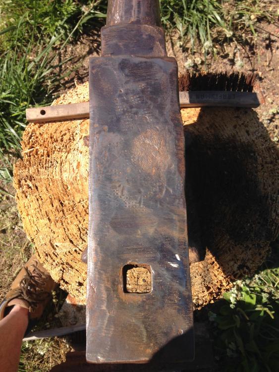

Moose Iron Posted May 2, 2018 Share Posted May 2, 2018 Can anyone help identify this anvil? I can't find any markings on it besides the USA cast in the side. Seller had no info on it besides that he found it in a pawn shop. Quote Link to comment Share on other sites More sharing options...
C-1ToolSteel Posted May 2, 2018 Share Posted May 2, 2018 I've seen a few of those before in pictures. They aren't any particular name brand, and I highly suspect cast-iron ASO (not good). Not 100% sure on that one, though. Read up on ring and rebound testing to see what your looking for, and pass on it, if it doesn't measure up. In the third picture, I see what looks to me like dents in the face from someone taking a mill-face framing hammer to it. If this is true, then it is probably an ASO. Quote Link to comment Share on other sites More sharing options...
Timber Ridge Forge Posted May 2, 2018 Share Posted May 2, 2018 I have heard from many people that they are cheap aso made in Mexico. Quote Link to comment Share on other sites More sharing options...
Irondragon Forge ClayWorks Posted May 2, 2018 Share Posted May 2, 2018 Welcome to IFI... I tend to agree with others that it's a cast iron anvil from Mexico or China. I always recommend this thread to get the best out of the forum. Quote Link to comment Share on other sites More sharing options...
Bill Epps Posted May 2, 2018 Share Posted May 2, 2018 Looks like a wore out pice of junk Quote Link to comment Share on other sites More sharing options...

Everything Mac Posted May 3, 2018 Share Posted May 3, 2018 Raised lettering = indicative of cast construction. Lack of pritchel hole/ pritchel larger than the hardy hole = indicates an ASO. A ring/ rebound test would confirm this one way or the other. The cast "USA" brand is a well known cast iron ASO type anvil. Better than no anvil at all but unless it's really cheap or free, personally I'd pass and keep looking. All the best Andy Quote Link to comment Share on other sites More sharing options...
ThomasPowers Posted May 3, 2018 Share Posted May 3, 2018 A large chunk of steel bought for scrap rate, 20 cents USA a pound at my local scrap yard, will make a better anvil than a cast iron "Anvil Shaped Object" often be sold at *real* anvil prices. Quote Link to comment Share on other sites More sharing options...
