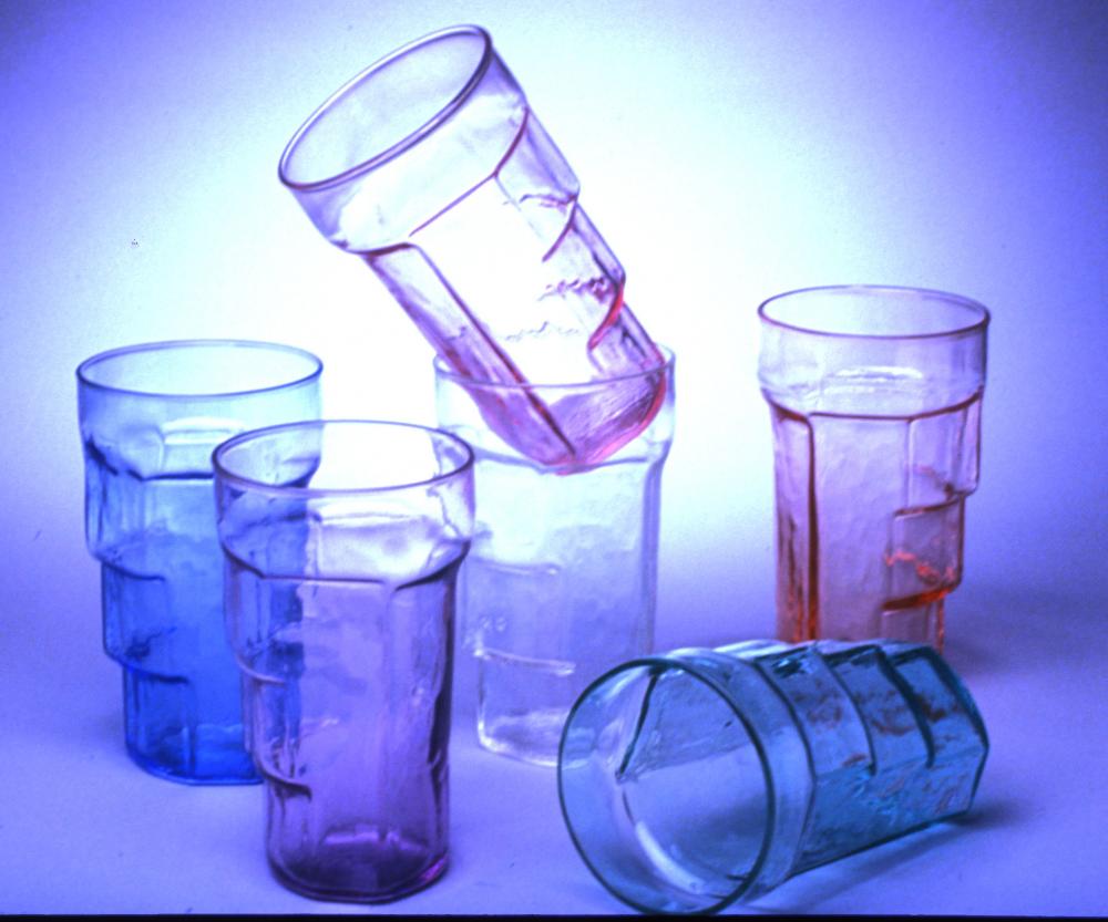

Latticino Posted May 18, 2018 Share Posted May 18, 2018 Interesting, I used to machine "scrap" graphite for custom glass molds that I got from a facility that made special assemblies for potting electrical devices. They tossed a lot of end cuts and used to allow me full access to their junkyard. As I recall the material was quite easy to machine with just a wood bandsaw, file, belt sander... but I have no idea whether I was eating up the teeth or not (never had to replace the saw blade, but wasn't in any kind of production anyway. Boy the dust sure got everywhere though. I ended up working in a dedicated storage room with exhaust fan and still struggled with it. Even using a full respirator with HEPA filter cartridges I found traces of black dust inside the respirator and my nasal passages. Not to mention that the dust on the floor was a good contender for slickness with black ice... Don't miss that even a little bit. If I recall the binder for the graphite I used would break down fairly quickly on direct contact with molten hot glass (figure in the 1900 to 2100 deg. F range), but was fine with short contact with glass at working temperatures (probably the 1400 - 1800 degree range). Not sure how this will equate to use as a coal forge, but personally I would go with steel plate as a preference. Note that thick sections of graphite will also transfer heat from forge interior to exterior pretty quickly as well, so your pot design may not be all that efficient. Here is a shot of some of the glass tumblers I used to make with the custom molds: Quote Link to comment Share on other sites More sharing options...
JHCC Posted May 18, 2018 Share Posted May 18, 2018 Cool info, cool story, cool glasses! Quote Link to comment Share on other sites More sharing options...
