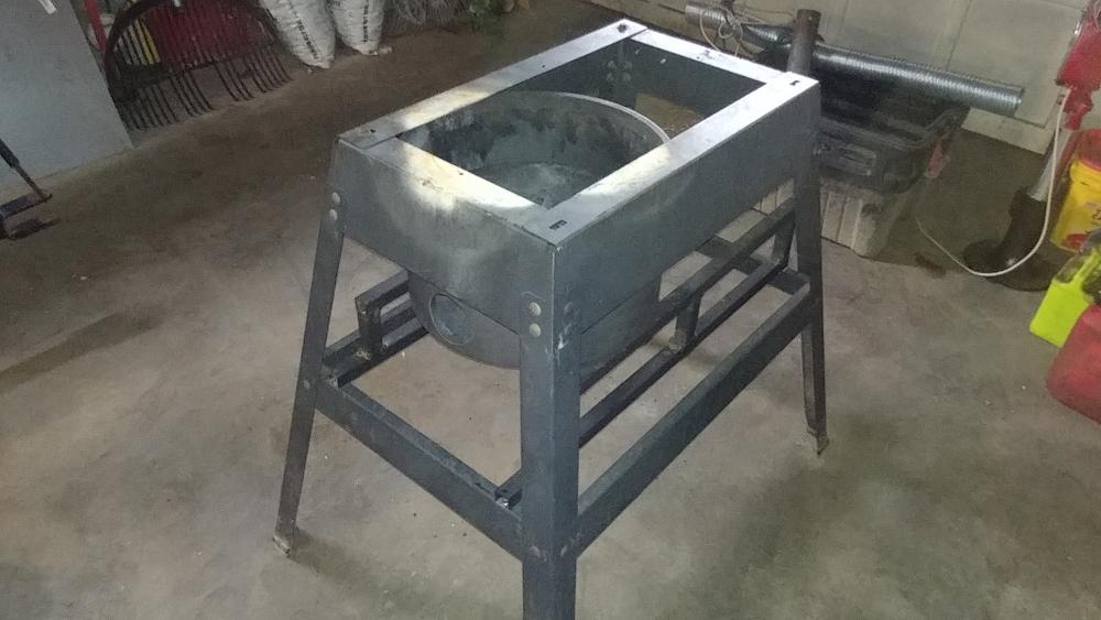

  2. We are starting small. The fire pot is 13 1/2 inches. I.D The first fire was more of a test since we didn't have an anvil. We had the coal level to the top and all of it was HOT. I've put together a piece of 1/2 inch steel plate on a stand so we can try some real stuff. The firepot should big enough to start. Hammahead
  3. Unit togeSorry to take so long to figure out the pictures. This is the fire pot .next is the hearth plate. Next are the standoffs, and side view of hearthplate. Next standoffs in the firepot. Next Unit assembled. This is a modified chop saw frame with support struts.Now the unit is locked into the frame. This is the air supply pieces. That's everything but fire. Rain is coming soon, but when everything corporates I will show you the real first working fire and first attempt to form steel with heat and hammer. Thanks for your patience. Hammahead

  6. Thanks for the interest guys. Arc meltelater graphite is a different grade called low density, this stuff is high density, made to grow silicon computer chip material. It is also useful to make resistance heaters, both of which I have made a boat load of. It is made in Japan by Ibiden industries, owner of micro mech the company I worked for now retired.if you ordered a similar piece of material it would cost about $2000. Thankfully mistakes are made and this stuff was in the scrap pile. Going out to take pictures now.
