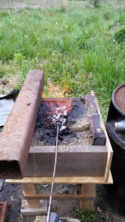

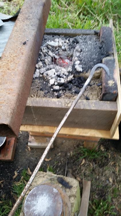

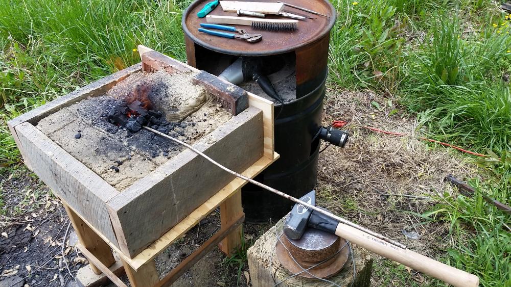

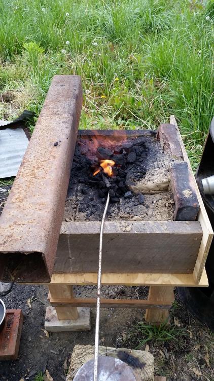

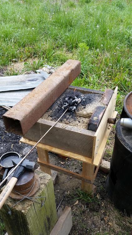

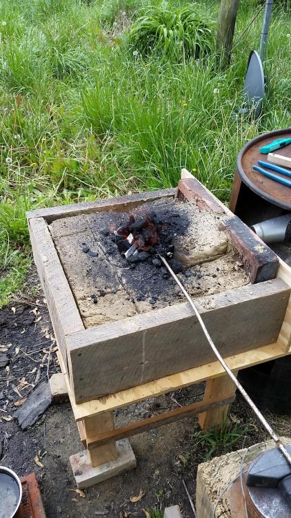

Hey guys sorry no video today my wife and daughter stayed inside it rained yesterday and she was kinda cold and my daughter was fussy I think I need to reshape the fire pot a bit but it worked pretty good I had to turn the hairdryer on high to get the fireball at the right height. I took some pics for you guys to see how it went. I didn't do much just made a pick rake for the new forge.
Ayup, that's a fire alright! How do you like it? Hot enough? Good control? Economy?  Make hot dogs taste funny?
It works great I think I need to make a few modifications but it's dirt that's easy to fix it gets good and hot but I couldn't get it to forge weld not sure if it was me not being practiced enough the stock I tried to use or I need to raise the bottom to make the fireball sit even with the top of the dirt instead of an inch below I got it to a bright orange but not yellow or white it's probably me still not being very practiced with fire management yet. I like the economy though and control is good as long as I don't put the hairdryer too close to the tuyere and catch it on fire again when the tuyere vacuums fire out of the fire pot after you shut off the hairdryer. But anyways I think it needs a few modifications to get it just right.
