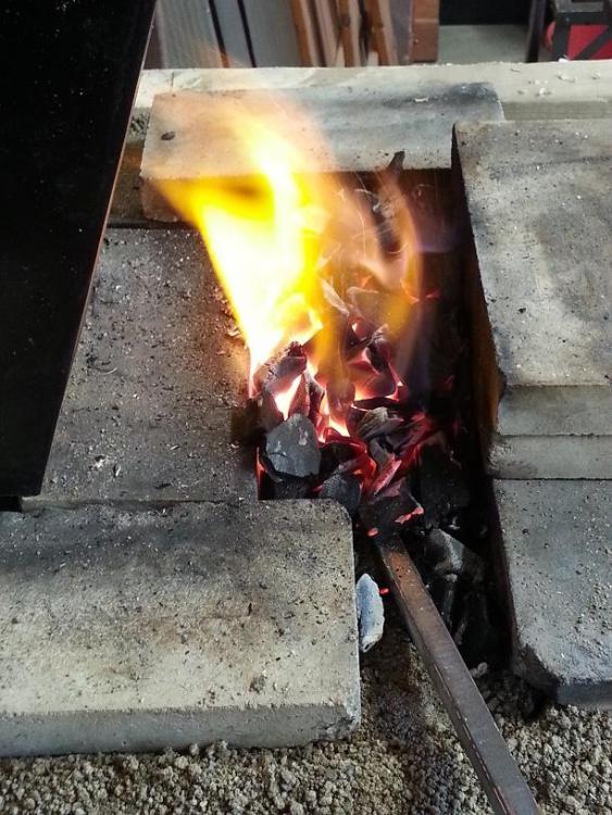

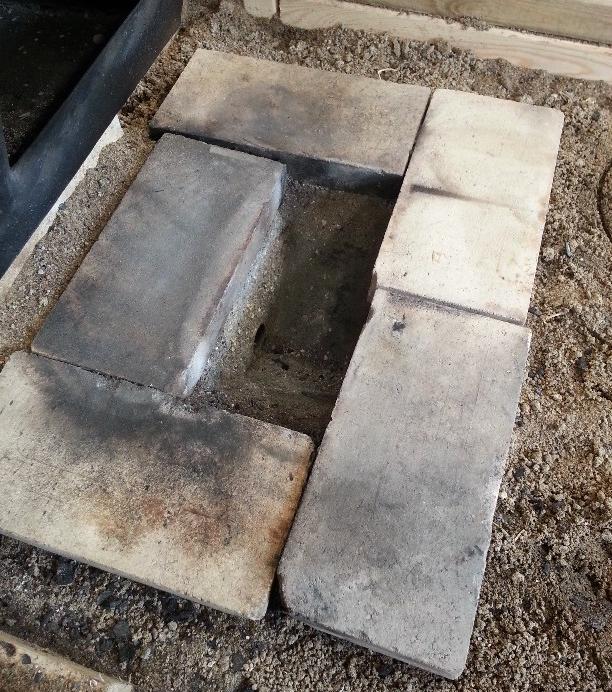

Here’s my first forge. It is basically a box of dirt with a few fire bricks on top to keep the edges firmer. I’m using a 1” black pipe for the tuyere and a box bellows for an air source.

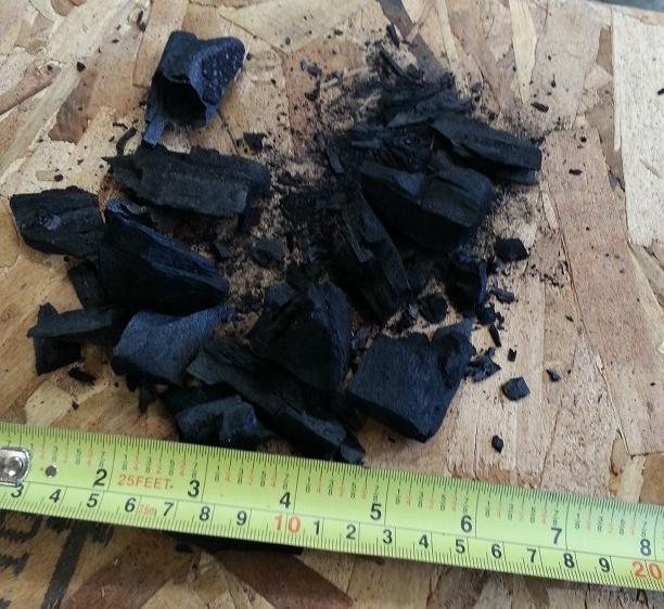

The V-shaped trench is approximately 4” by 9” in dimension and 6” deep. The tuyere sits 1” from the bottom of the trench. I’m using lump hardwood charcoal for fuel, broken into pieces about 1” in size.

I’ve done a few tests with a half-inch piece of mild steel to see how well it works, and in general I am satisfied. My only problem is that I can’t seem to get my steel hotter that dark yellow. I’ve tried varying the speed and strength of my bellow strokes, but can’t seem to get to welding heat. And I’m making sure to keep an inch or three of coals above the steel.
Wondering what I am doing wrong. Are my pieces of charcoal still too big? Is my tuyere too large, resulting in too much concentrated air?
Suggestions on how I could improve my forge would be welcome. :)

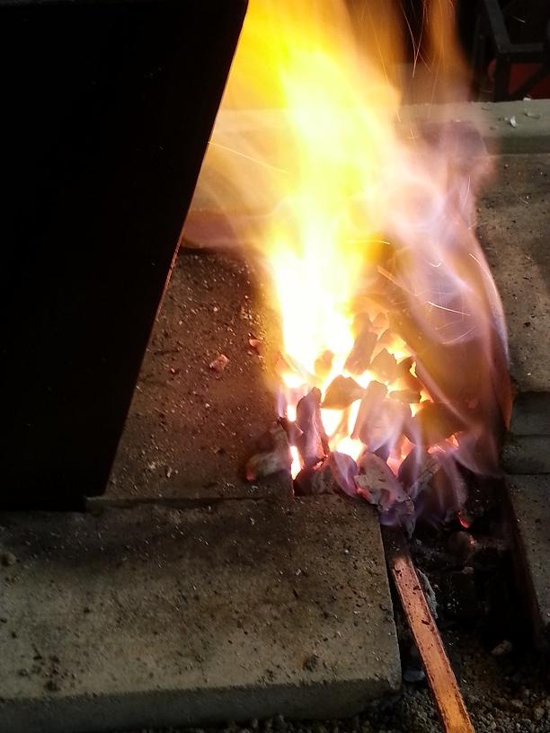

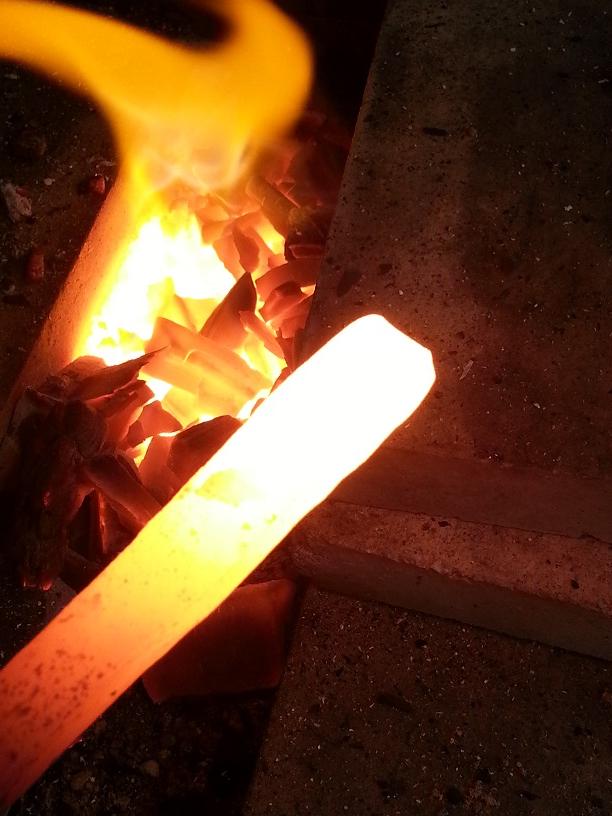

Here are the pictures of my new test. By angling the stock down towards the tuyere and pumping my bellows solidly (though not crazy hard) I was able to get the steel to light yellow - it was sparkling at one point (no picture of that).
jabod_v1.2_a.thumb.jpg.7cf9704ba379e4d88a1f58a8d9fe393f.jpgjabod_v1.2_b.thumb.jpg.ee53e1df5defc5f14399f03b6fa300d3.jpgjabod_v1.2_c.thumb.jpg.0778bb3d5e3cf1afa8f7bffd886caf96.jpg
Once I shut everything down and removed the coals, I saw that the walls of the trench as well as the tuyere were red-hot. And when I cleaned up the trench, I fished out two small pieces of melted sand. So obviously I'm doing someting right.
My guess is that I could make the slot where I insert the stock (between the two bricks) at least one inch deeper. So, in short, between 1" and 2" above the tuyere is plenty deep for a charcoal sideblast.
