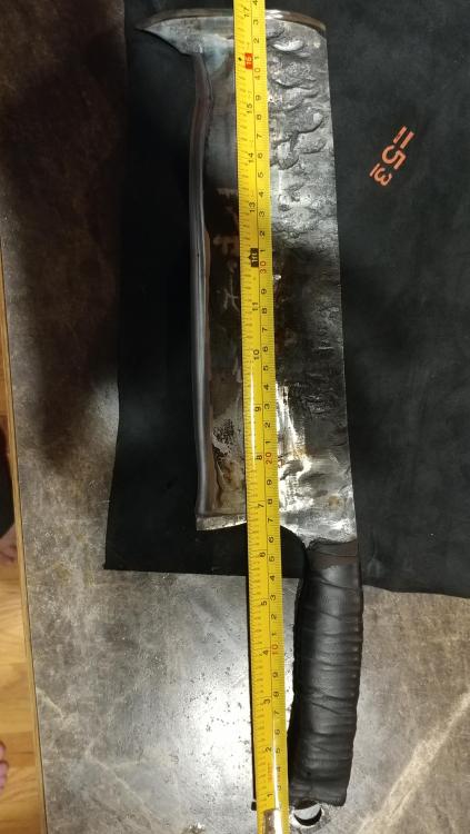

DavidF Posted February 26, 2018 Share Posted February 26, 2018 Cool Uruk Hai look! How long is it? Quote Link to comment Share on other sites More sharing options...

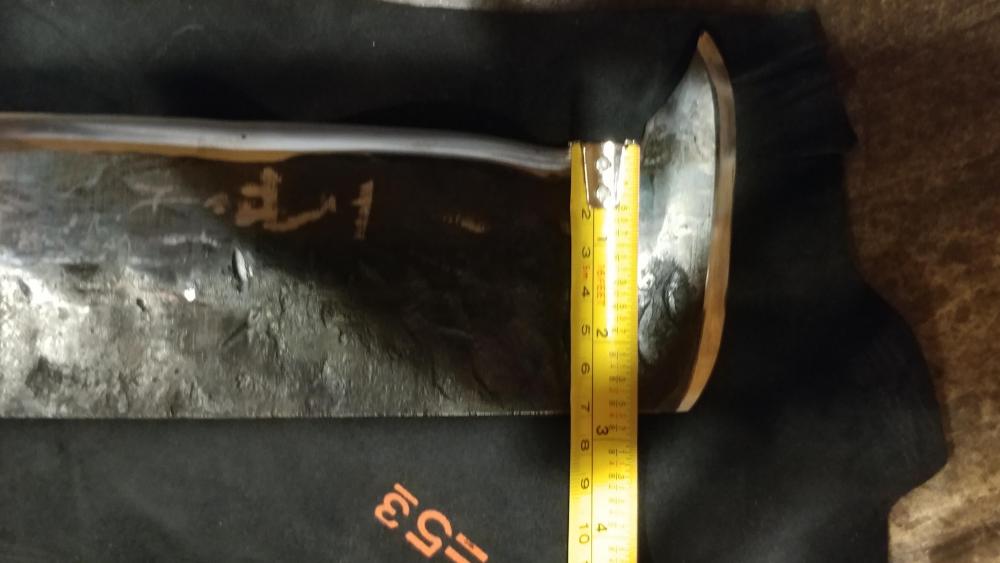

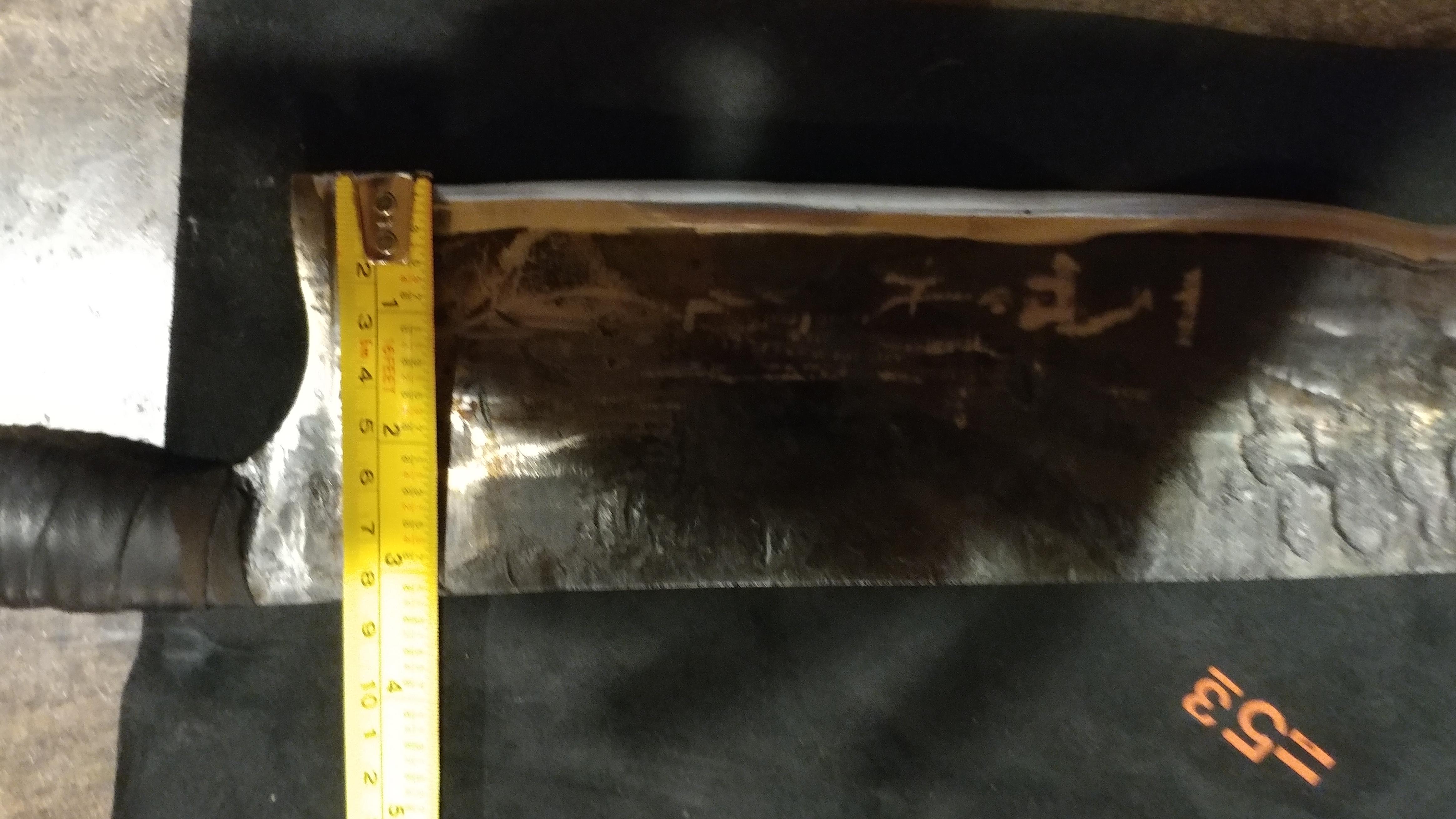

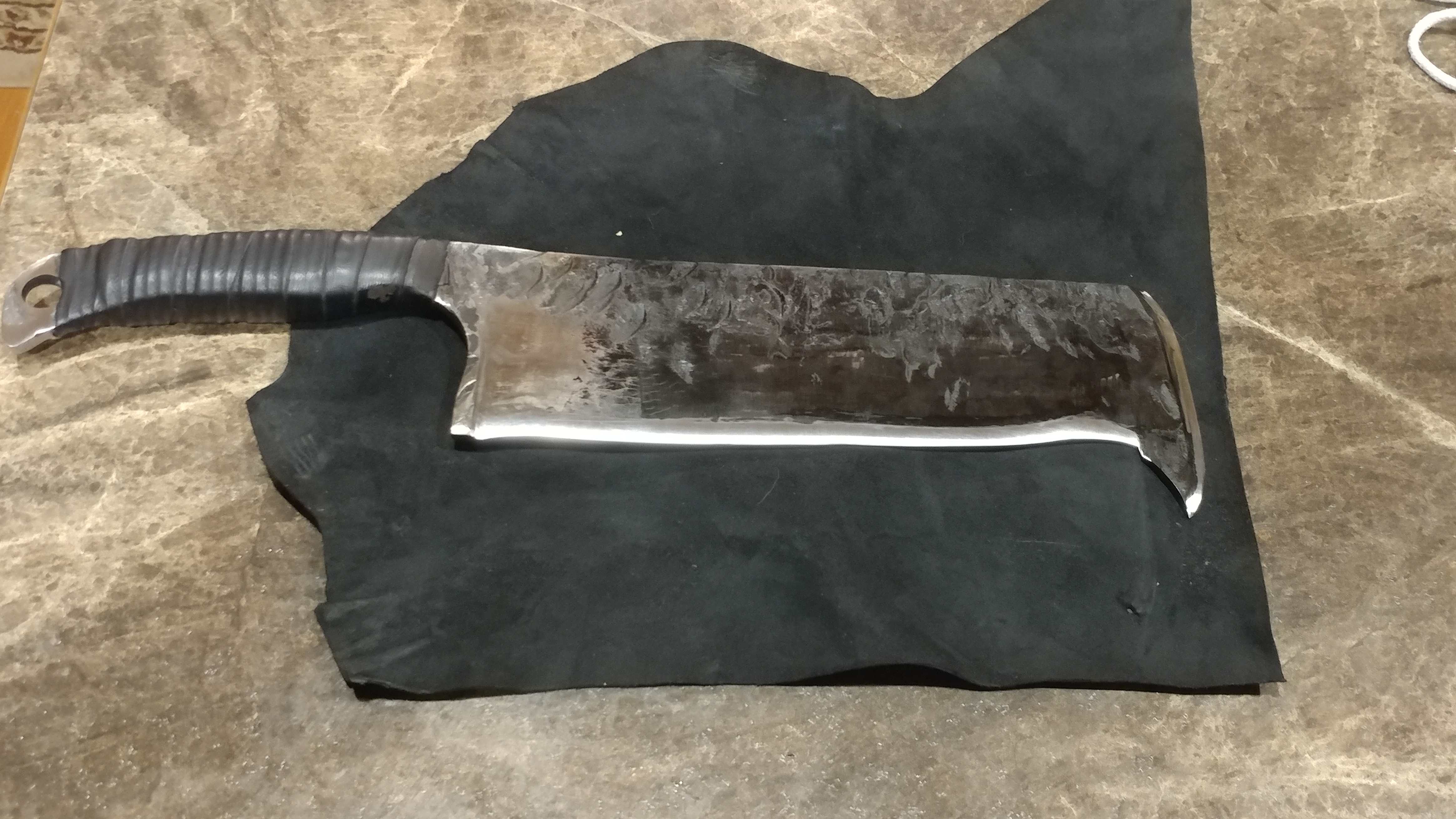

DavidF Posted February 26, 2018 Share Posted February 26, 2018 I love it! I thought about doing one of these and planned to pound a hardened blade into it before HT to make it look like it had seen some battle and had some scars. It looks like it is was crafted in the underworld. Good job and I bet it was a blast to make! Quote Link to comment Share on other sites More sharing options...
Binesman Posted February 26, 2018 Author Share Posted February 26, 2018 Yeah it was a blast a friend and i actualy made it as a gift for a video game company producing a game we are eagerly awaiting. One of the "sides" in the game is a nordic like people so we wanted to make something that looked like it beloned to them and had seen a lot of battle. So we hammered heavy and didnt grind clean then after tempering we put boiled linseed oil on while still hot so it would darken and age the blade then scrubbed it in with scotchbrite pad. To end we only clean/polished the edges to 400grit so eaven though it was "old and battered" it was "maintained and deadly" Quote Link to comment Share on other sites More sharing options...
ThomasPowers Posted February 26, 2018 Share Posted February 26, 2018 Actually it looks like a fairly standard variation of a billhook used for centuries, especially for hedging. You may want to read up on stress concentrators as battle weapons would generally NOT have them "built in" Any smith that could forge and heat treat a weapon would be able to leave a smooth surface hammering. Quote Link to comment Share on other sites More sharing options...
