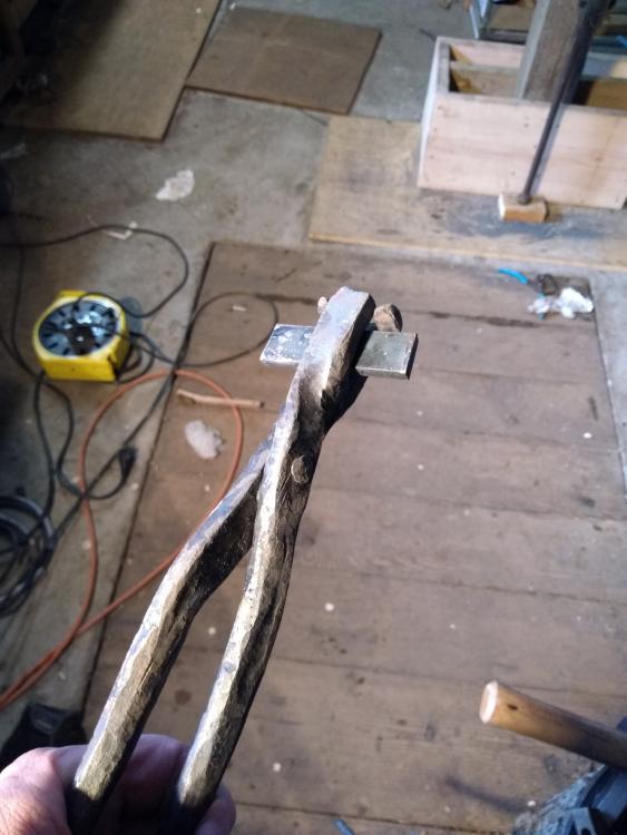

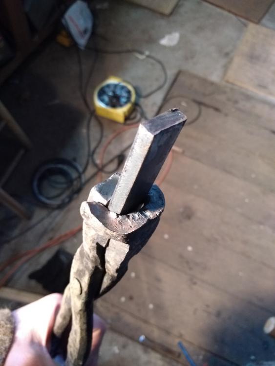

MotoMike Posted February 19, 2018 Share Posted February 19, 2018 I made my first set of box jaw tongs. I can say this, they work well. Quote Link to comment Share on other sites More sharing options...
sfeile Posted February 19, 2018 Share Posted February 19, 2018 Nice job Mike. Those are handy for sure. That's a nice bull pin you got there too. I need to get me one of those. Quote Link to comment Share on other sites More sharing options...
MotoMike Posted February 20, 2018 Author Share Posted February 20, 2018 Thanks Shawn. That Bull pin is quite handy and much appreciated, thanks. Not as shiny as it one was. Quote Link to comment Share on other sites More sharing options...

DavidF Posted February 20, 2018 Share Posted February 20, 2018 Awesome work. I need to try making some tongs. I am using a long set of vice clamps for now. I need to pick up some rebar and make a set. Mine will be caveman inspired too! I will probably use these images as a design template. Looks perfect for the stock I need to hold Quote Link to comment Share on other sites More sharing options...
ThomasPowers Posted February 20, 2018 Share Posted February 20, 2018 Why if you have a choice would you want to use rebar? You like tools that hurt your hands to use? You have the time and money to waste making them to not hurt the hands? Couldn't you just hammer on your fingers and save the fuel costs? Quote Link to comment Share on other sites More sharing options...
MotoMike Posted February 21, 2018 Author Share Posted February 21, 2018 Thanks Everyone. @DavidF check out the articles here. the EZ tong write up is what I used for my first set. basically flat tongs. I made mine to hold 1/4 round stock too. the plans call for 1/4 x3/4. I used 5/16 x 3/4 and they are robust. I still use them when I need flat tongs even though I've a few sets of store bought around. Quote Link to comment Share on other sites More sharing options...
