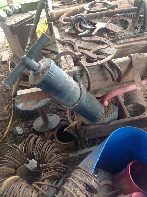

Would a pump like this work at all? It would allow me to more easily control the air flow I think than the hand pump suggested earlier by you Charles and I can use it while saving my arms for the hammer work.

Not enugh air and it is only single acting. Order the one shown from Walmart, I got mine from academy sports. For charcoal with a 3/4" schedual 40 tuyere it is plenty of air, and it is quit. It was $10 plus tax. I like this style beter than others because it is bigger and the outlet is not in the handle.
This is the mark 1 dirt box forge. Now if you don't mind squating to forge you can take it camping as well.
