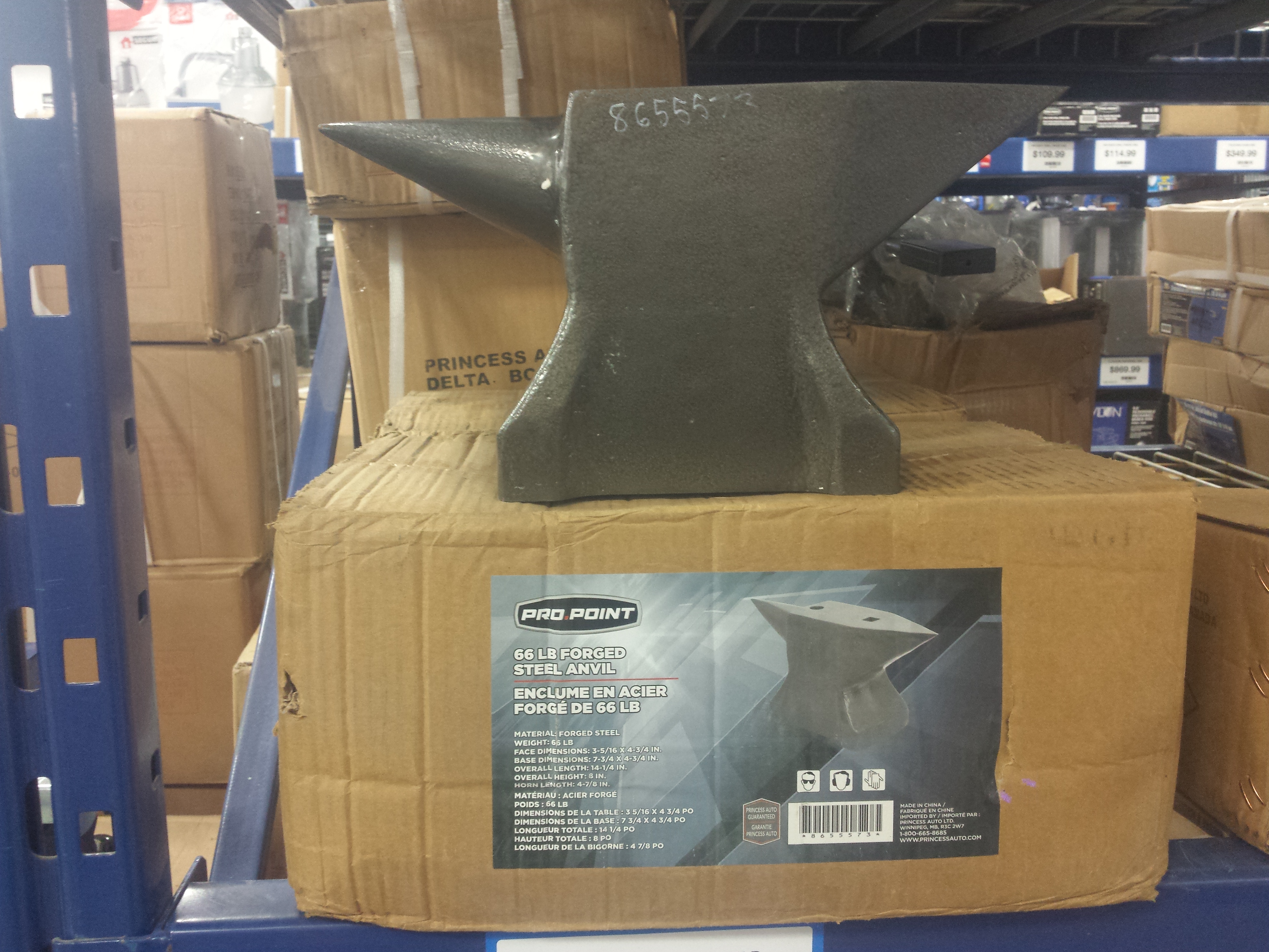

So I'm traveling through Canada and decided to swing into Princess Auto to browse. It's like the Canadian harbor freight on steroids. Lots of imported "tools" but also excellent trailer building supplies, hydraulics, and some surplus. In any case, this is what I found.

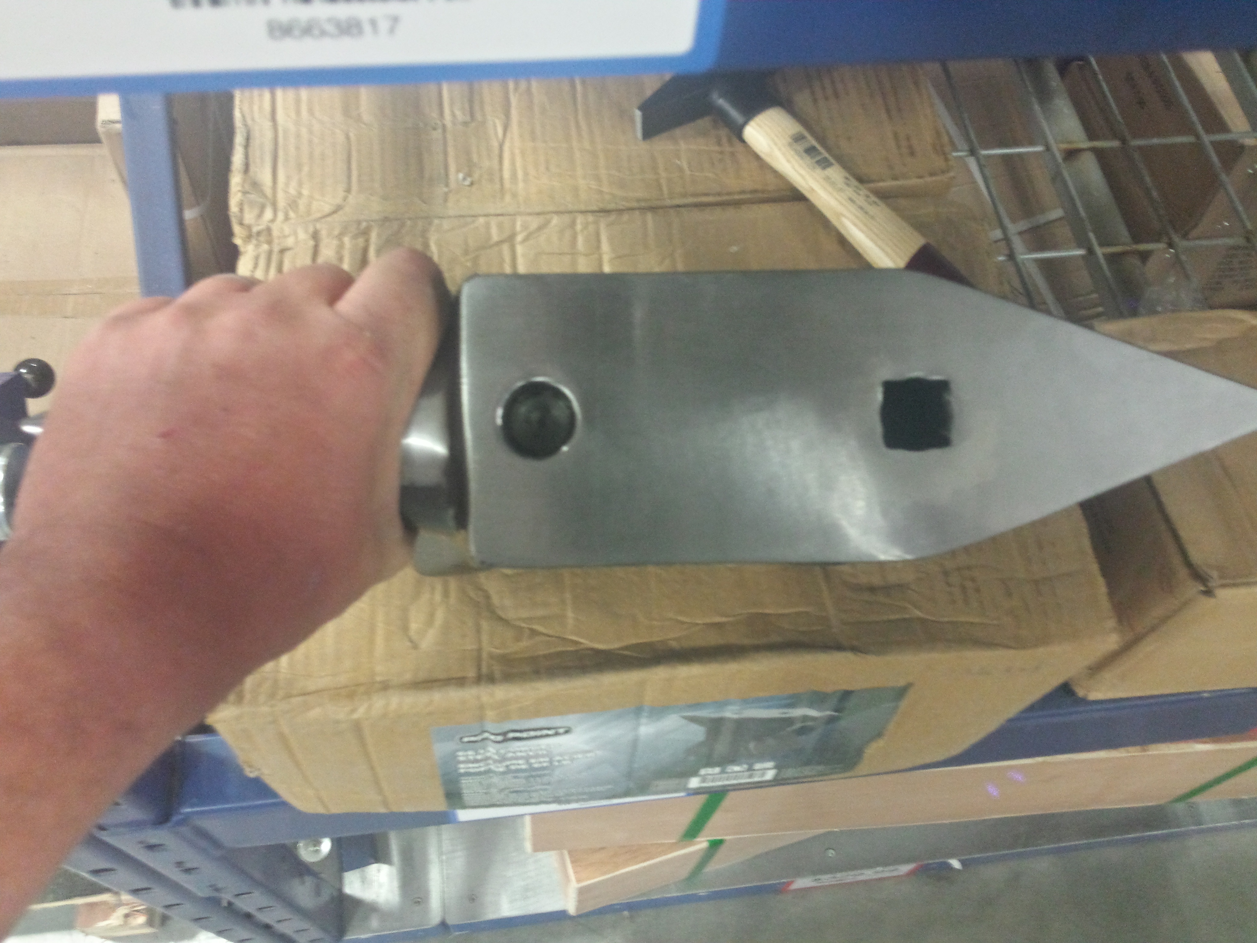

It claims to be a 66# STEEL anvil.  I was ready to write it off as another cheesy Chinese cast iron ASO, but I couldn't help myself. I grabbed a hammer and gave her a tap. And another. Then, with it sitting on concrete I did a rudimentary rebound test. Consistently it was  60-70%.  And it rings.
I think this might actually be a STEEL anvil. Note I didn't say HARDENED STEEL. But steel in any case.
And now the downsides. The "pritchel" is as big as my thumb and drilled only 2" deep. Same for the hardy. Neither pass through. The working area is ridiculously small for an anvil this size. And the price. Nearly 6$ Canadian per lb
Anyway, an odd addition to the list of Chinese anvil attempts. At least there were no visible casting lines, and the machining was pretty clean. Also, I wish I had photographed it, but the bottom features 2 threaded holes....for mounting maybe?

A local blacksmith had purchased one of these "forges steel" ones, they also had another design that was "cast steel" and came in three weights 30, 60, and 120 lbs I believe. This one was OK, the hardie hole and "pritchel" hole were drilled only part way through, the face was decently hard, but it only had about 60% rebound. The other cast steel ones were better, with the hardier and pritchel running through, and they had about 75% rebound.
They were no where near the quality of better manufacturers, and for the price the NC Anvils are still a better deal in my opinion but they are not bad and actually do seem to be made from steel rather than cast iron.
