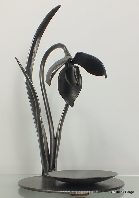

The project is a flower on a stem, and some leaves attached to that stem and a scrolling "vine". The flower is along the lines of the attached photo (not mine. found on the internet for inspiration).
The main stem is 8mm, and the stems of the petals (and leaves) are about 3mm. So heat is a serious issue, trying to forge weld. Especialy, as there are several around the same spot. I"m sure a seasoned blacksmith could tackle this, but I dont qualify as a newbie yet.
Back to cheating, I mean, stick welding - the finish should be "forged black". So I would try to hot hammer the weld to blend it into the base metal. Wire brush it all, and hot bee wax it. Is that a workable plan? especialy regarding making the welds blend/vanish?
The branch welds on that I would fireweld, you will always see where the arc starts otherwise, even if you chisel or file a vee. The firewelded branching elements just flow together.
Obviously an actual flower or shrub does not look like a fire welded branch weld, but this is an interpretation of a natural form using the properties of the material...the chosen media.
I would suggest you tie the leaves and petal elements together with soft iron wire and weld in one go.
The butt weld between flower head and stem you could arc weld and blend/lose it...but just as difficult with a stick as with a fire weld which requires no further blending or hiding. TIG or gas might be a bit easier for that butt weld...but the over all time taken would not save money.
If you want to produce a fire welded form why not fireweld it? Nothing wrong with an arc weld, but it has different characteristics and visual properties. Learning to produce a fire welded form by fire welding is a skill that is worth having...it really is win win.
It is obscured by the dish but the base of the stem in the image appears to show a couple of blobs of weld which look awkward and interrupt the otherwise graceful flow of the stems.

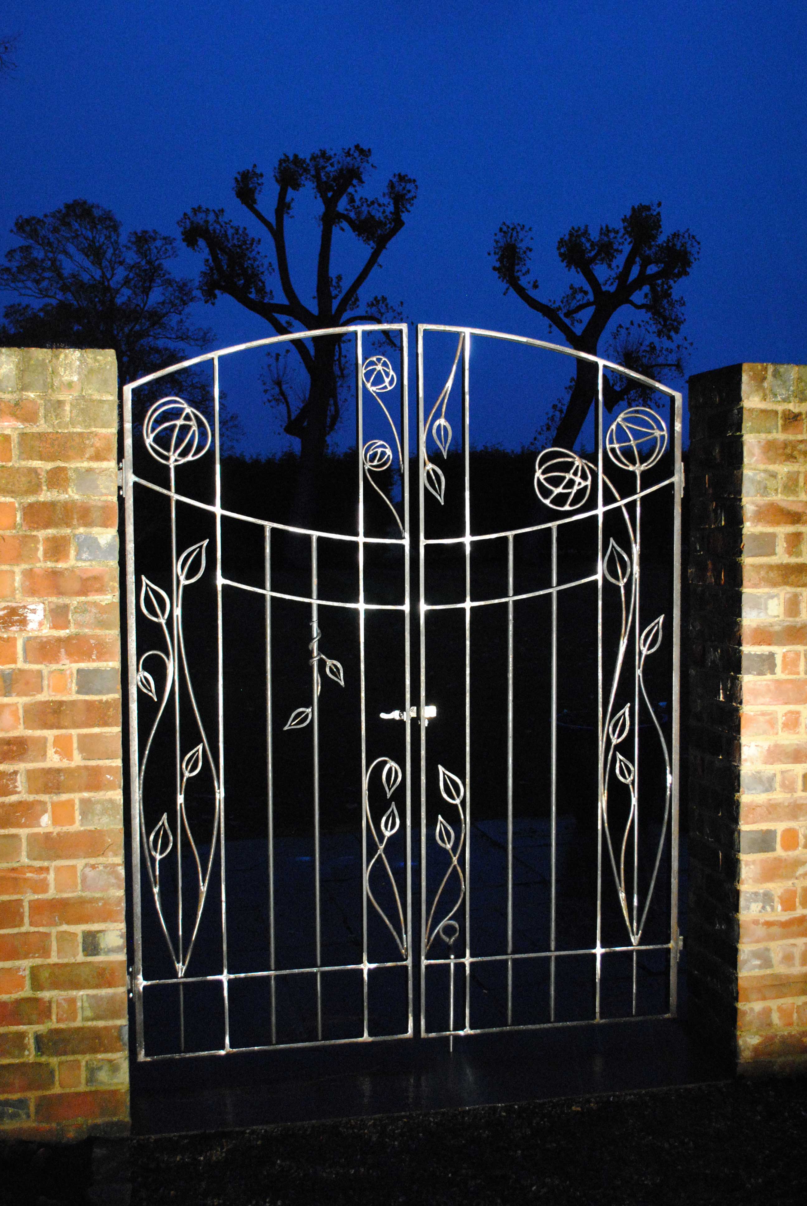

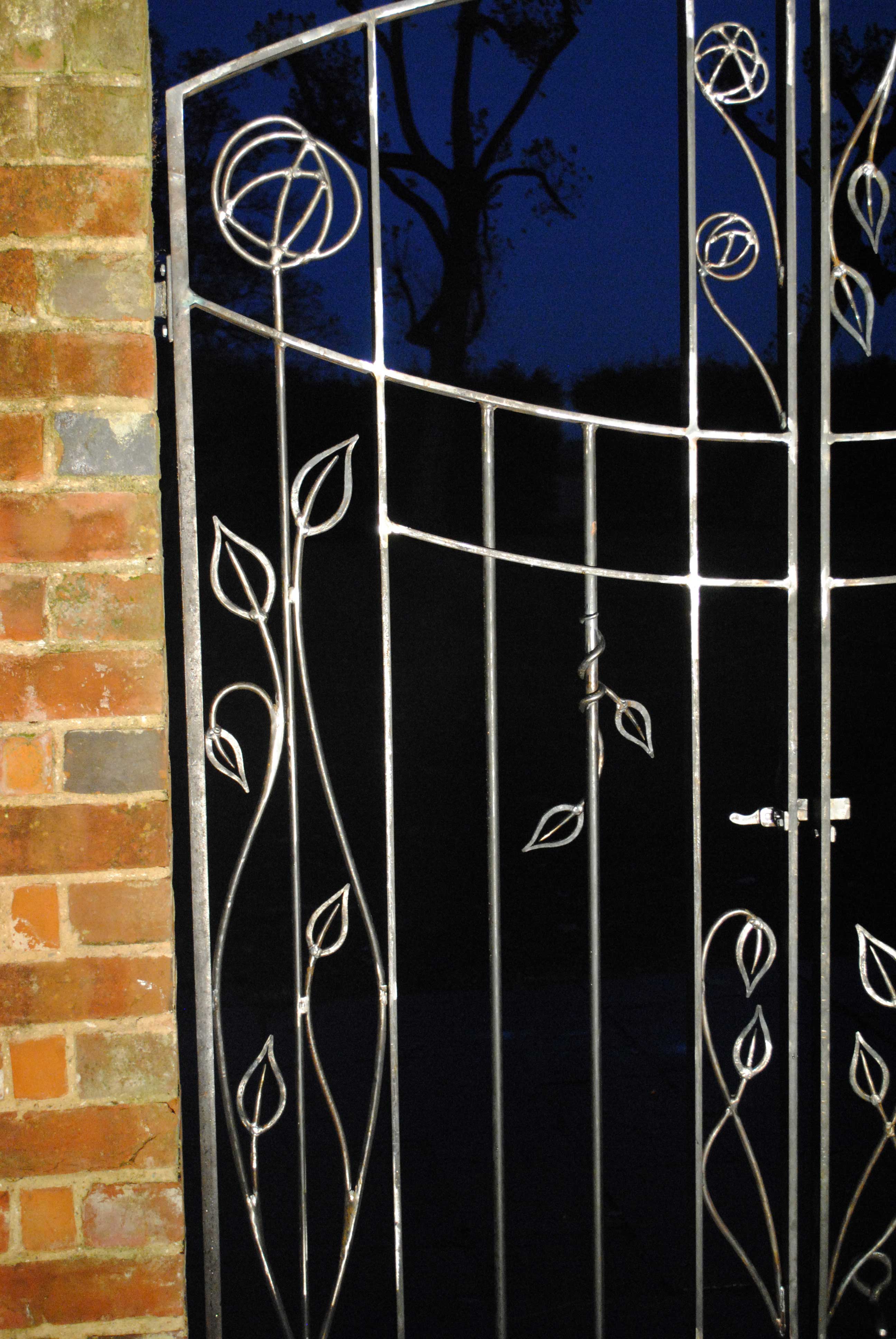

Just to throw the cat amongst the pigeons and chuck in a thought process I've recently gone through with my own work - arc welding gives you so much more potential than fire welding - why not use it? Why have all flowers got to be life like with seamless transitions, why can't they be abstract and use the weld for character?
These gates were inspired by C.R Mackintosh's rose flower stained glass windows for a client that wanted roses and climbing branches. I'm not saying they're better in any way than what you want to do, I'm just illustrating a point that you've got a tool in that stick welder that gives you a whole other scope of creative possibilities. I took these pics during the dummy run install before they went off for finishing. They're just a bit easier to see than the daytime pics because of the light contrast.
Install-001a.thumb.jpg.676d8f144d385b0c19179275bade6bb1.jpgInstall-002a.thumb.jpg.c51000772dc631d70c47f158fb90f6b2.jpg
