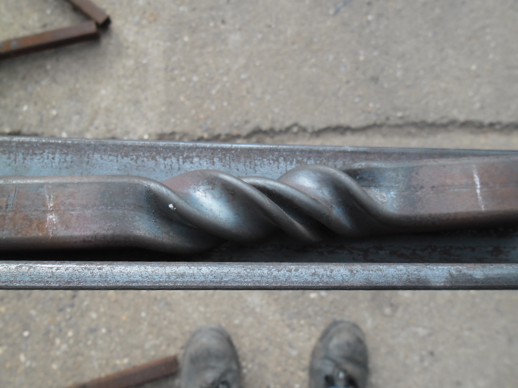

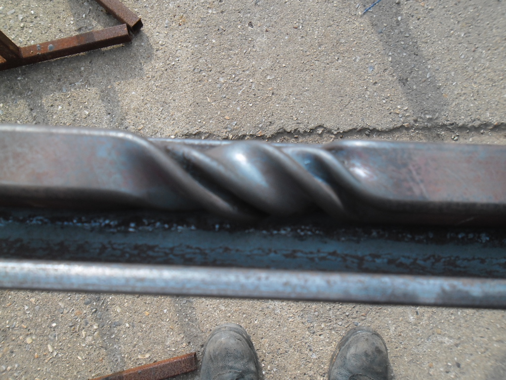

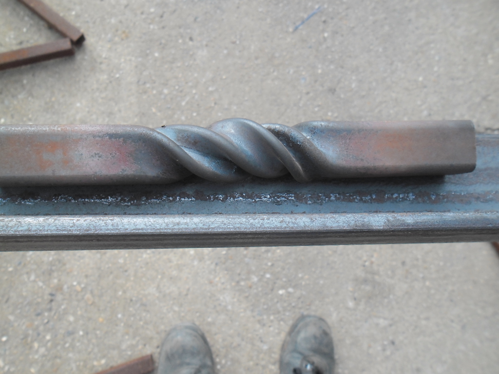

the iron dwarf Posted June 1, 2017 Share Posted June 1, 2017 tried twisting some 25mm ( 1" ) square tube today for the first time, worked ok for a first attempt I think Quote Link to comment Share on other sites More sharing options...
