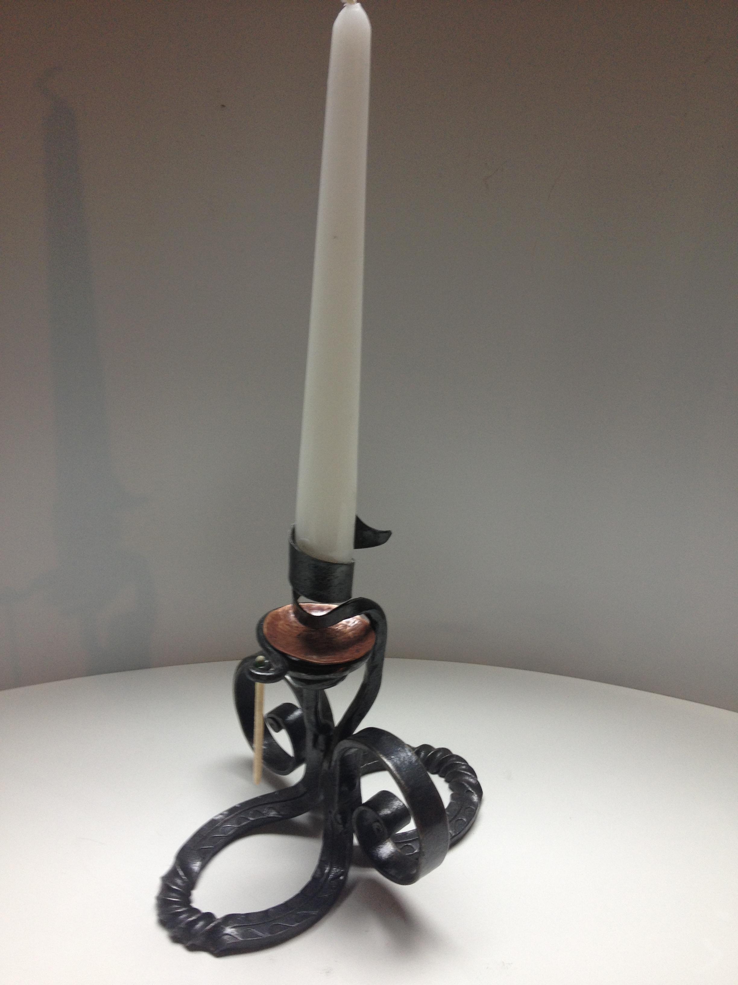

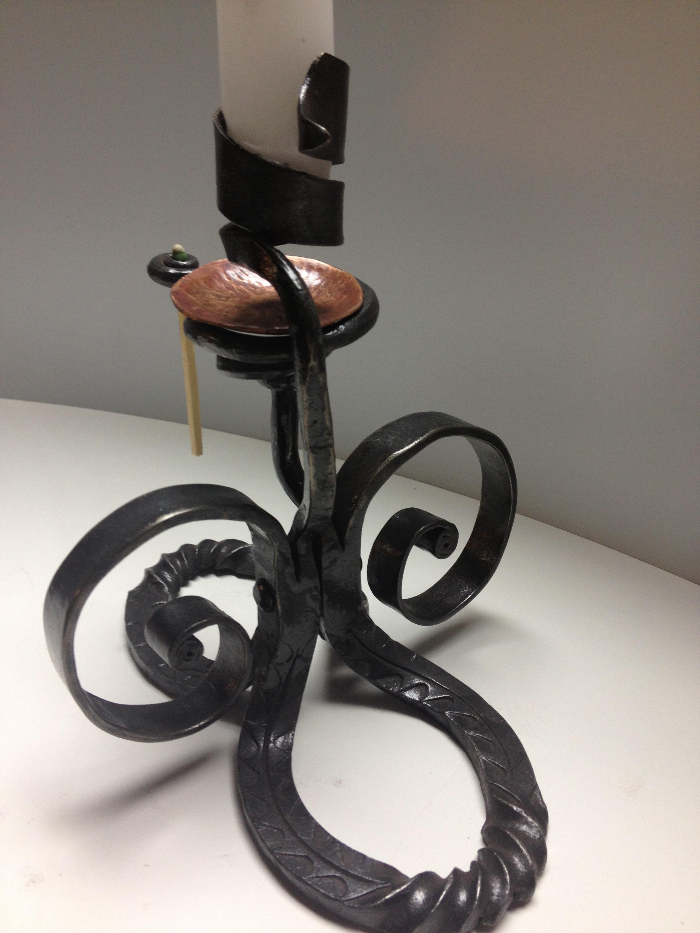

Jim Coke Posted April 26, 2017 Share Posted April 26, 2017 Greetings Reynolds, I make mine from one piece of 1/2 inch stock with no interruptions or welds and only one rivet. Just 7 hours to make free hand. Forge on and make beautiful things Jim Quote Link to comment Share on other sites More sharing options...
SReynolds Posted April 26, 2017 Author Share Posted April 26, 2017 Those are quite nice. What are the two scrolls called at the base, where it is rolled tightly? Quote Link to comment Share on other sites More sharing options...
Jim Coke Posted April 26, 2017 Share Posted April 26, 2017 Greetings Reynolds, I make mine from one piece of 1/2 inch stock with no interruptions or welds and only one rivet. Just 7 hours to make free hand. Forge on and make beautiful things Jim Just a style of penny scrolls.. Yes the ends are tapered long and thin than rolled up for the volume.. I learned that years ago from Peter Ross Quote Link to comment Share on other sites More sharing options...
Alan Evans Posted April 26, 2017 Share Posted April 26, 2017 Traditionally those are called rolled snub scrolls over here, and are the type I was referring to in my earlier post that I made on the Davies Brothers' restoration at Erddig. The same shape but forged from solid would be a solid snub, and if the solid snub was hammered flat it would be a penny end...though penny ends are normally made from flat section and twisted 90˚ to align with the taper or the scroll. The trick I was taught to get a rolled snub tight, was after tapering the scroll length, to fishtail the end and cut out a Vee notch about a third of the width. Roll the snub up good and tight and then hammer on the ends to knock the fishtail tip ends in which filled any and all of the gaps in the centre. I am afraid I give up with your OP problem. You had apparently made your mind up that a locking post was the only solution and could not understand why it was not necessary...and I rather think you still don't. And yes, you ignored a number of questions I asked in earlier posts, and yes, you have rejected the quality advantage of starting the scroll on the anvil and using the jig just to complete the less critical part away from the eye/snub, which is how scroll jigs have traditionally been used by others. The locking post will always be a compromise, and is the reason for the kink and/or flat at the heart of so many commercial scrolls. However you have found a solution which enables you to make it to the form and quality that you desire, which is all you need. Good. The candle sconce and drip pan problem that you have now introduced is good from the point of view that it gave Jim a reason for posting his rich piece...But in answer to your question 2 hours ago, SReynolds said: But who builds candle holders which directs melted wax to run down the fixture onto the surface which it sets? Apparently Lorelei Sims. ...and you can add me. I often try and design candle sconces so that not only does the wax run down, albeit onto the base of the fixture, but the candle itself will burn right down until the stub also drops onto the base...effectively self-clearing. I dare say Jim's one will also be self-clearing with the right burning rate candle. Alan Quote Link to comment Share on other sites More sharing options...

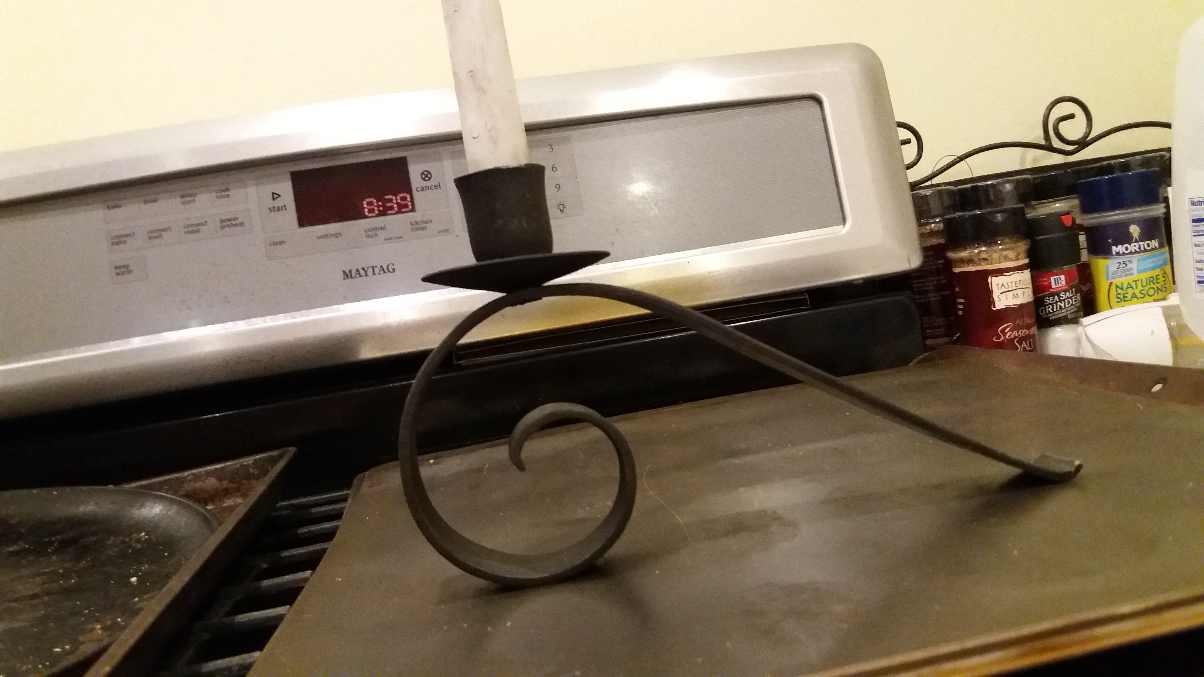

SReynolds Posted April 29, 2017 Author Share Posted April 29, 2017 Work in progress. Needs a bit fine tuning. Another side note problem is the availability of proper sized candles. Small candles won't due in these cups. I pitty the customer who trys small candles. They will curse me. Quote Link to comment Share on other sites More sharing options...
Jim Coke Posted April 29, 2017 Share Posted April 29, 2017 Greetings Reynolds, I think you should give more consideration to your design it is way to top heavy and lacks enough footprint to keep it stable. Just this ol boys 2c who has made a bunch of candle holders. A few others will chime in with opinions. Forge on and make beautiful things Jim Quote Link to comment Share on other sites More sharing options...
SReynolds Posted April 29, 2017 Author Share Posted April 29, 2017 It is 1.5" wide flat stock. You'd have to tip it over on purpose. But no, not my design. This is a project in the blacksmith book by Lorelei Sims. But have added a drip pan to catch melting wax, as opposed to running it down onto the table of which it rests. Quote Link to comment Share on other sites More sharing options...
jlpservicesinc Posted April 29, 2017 Share Posted April 29, 2017 Not bad.. It might be a camera parallax angle problem but the scroll looks side heavy... (IE off centered)... But overall I think it's a success.. I'd be concerned with not enough stability myself also... A candle falling over is not a bright future.. Quote Link to comment Share on other sites More sharing options...
