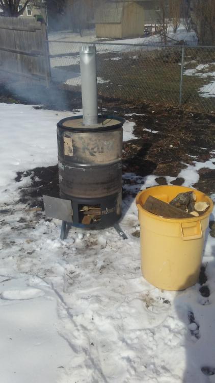

ronwend523 Posted March 10, 2017 Share Posted March 10, 2017 I built a charcoal maker from a 55 gal drum and a 15 gal drum with a tabbed lid. The 55 gal had a lid as well and I installed a 4" stove pipe in it. The inside drum has a vent pipe going down its side for gasses to escape and burn. I fill the fire wood into the bottom and along the sides. I have made 3 batches so far and it is working very well. Quote Link to comment Share on other sites More sharing options...

ronwend523 Posted March 12, 2017 Author Share Posted March 12, 2017 They are an easy put together. The 55 gal drum was on Ebay for $39 with shipping. Food grade drum with locking lid. The 15 gal are hard to come by and actually a 10-12 gal would be better cause theres more room for fire material and 10-12 gal gives a good amount of char. The inside container has a take off lid with tabs and it 3 legs to keep it up high in the outside drum. A steel pipe comes out the top side of the inside drum and down the side to burn off gasses. There's the 4" stove pipe on top and a tin door at the bottom to feed fire wood and draft air. I have made 4 batches of ash char and it works like a charm. Quote Link to comment Share on other sites More sharing options...

C-1ToolSteel Posted March 13, 2017 Share Posted March 13, 2017 Nice job. Look around and I bet you can find some 55 gal. drums for a LOT less. I get mine at the dump for $10 USD. Maybe there would be a market for something like that on Craigslist. Avid smokers tend to use lump charcoal as well as beginning blacksmiths. Just a thought. Also, for personal use, you may want to look into the underground versions. You can make huge batches of charcoal that way. Quote Link to comment Share on other sites More sharing options...
ronwend523 Posted March 13, 2017 Author Share Posted March 13, 2017 I plan on making some apple or oak char for the BBQ. It will be much better than using the brickets that are made of who knows what. I have a gas grill but that's not like the good ol wood fire. I may tinker with the inside container to improve on the design. right now it has 3 legs that it sits on and they inhibit loading the fire material. I'm always tinkering. Quote Link to comment Share on other sites More sharing options...

SLAG Posted March 13, 2017 Share Posted March 13, 2017 RNWND, "Charcoal" briquettes are compacted charred sawdust and glue. Some have added food coloring, even occasionally, perfume. (o.k. the last two are a "lie'). They will burn and some character smiths have even forge welded with it but that was for showmanship for their demonstrations. The B.T.U. output is unsatisfactory. Also, they are comparatively expensive. Lump charcoal is your best bet. Thomas Powers is correct. There are a number of charcoal retorts describe and illustrated. But, the pictures are missing from many of them. They were lost when this an improved program was foisted on the i.f.i. administrators a few years ago. But there are several, comparatively new threads that have illustrations and pictures. SLAG. Quote Link to comment Share on other sites More sharing options...
ronwend523 Posted March 13, 2017 Author Share Posted March 13, 2017 Tom I have looked at the different pics of what are available on this sight and all I can find on YouTube. It's to bad the older posts were lost in the switch. My Char Maker is the same as so many I've seen and I don't claim any credit for any design. I built mine to be simple and economical to make. They all are just a container that holds the material to be charred and a container or pit to have a good fire to heat up the container. I enjoy researching information and illustrations of everything pertaining to the forging of metal. It is so enjoyable to recreate what our forefathers did as a way of life back in the day. I'm a very newbie to this part of metal working and I look up to all of you that have been doing it and educating others about it. Thank you all. Quote Link to comment Share on other sites More sharing options...
