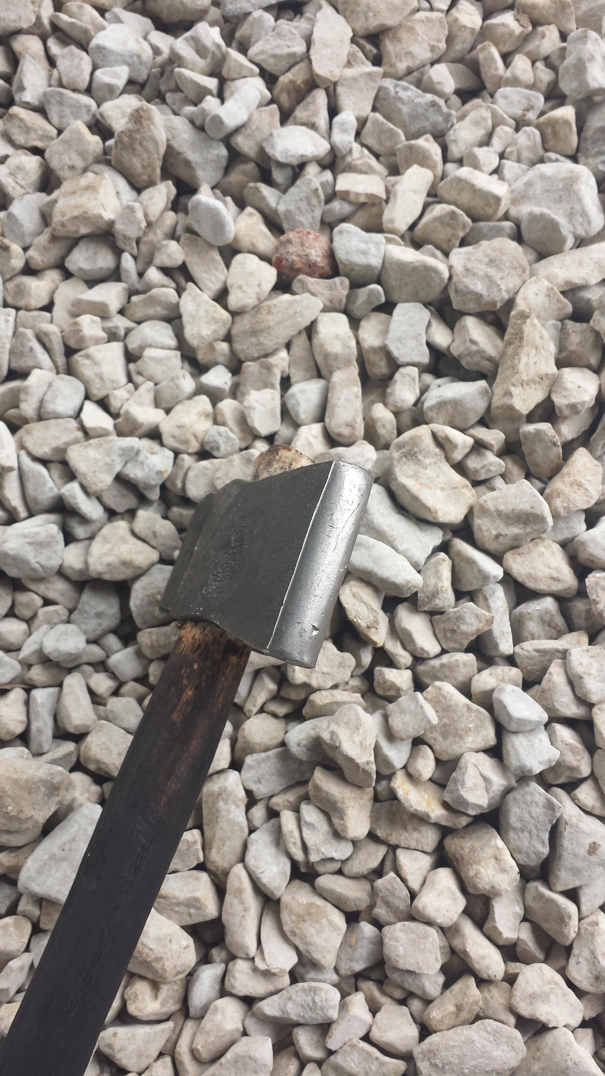

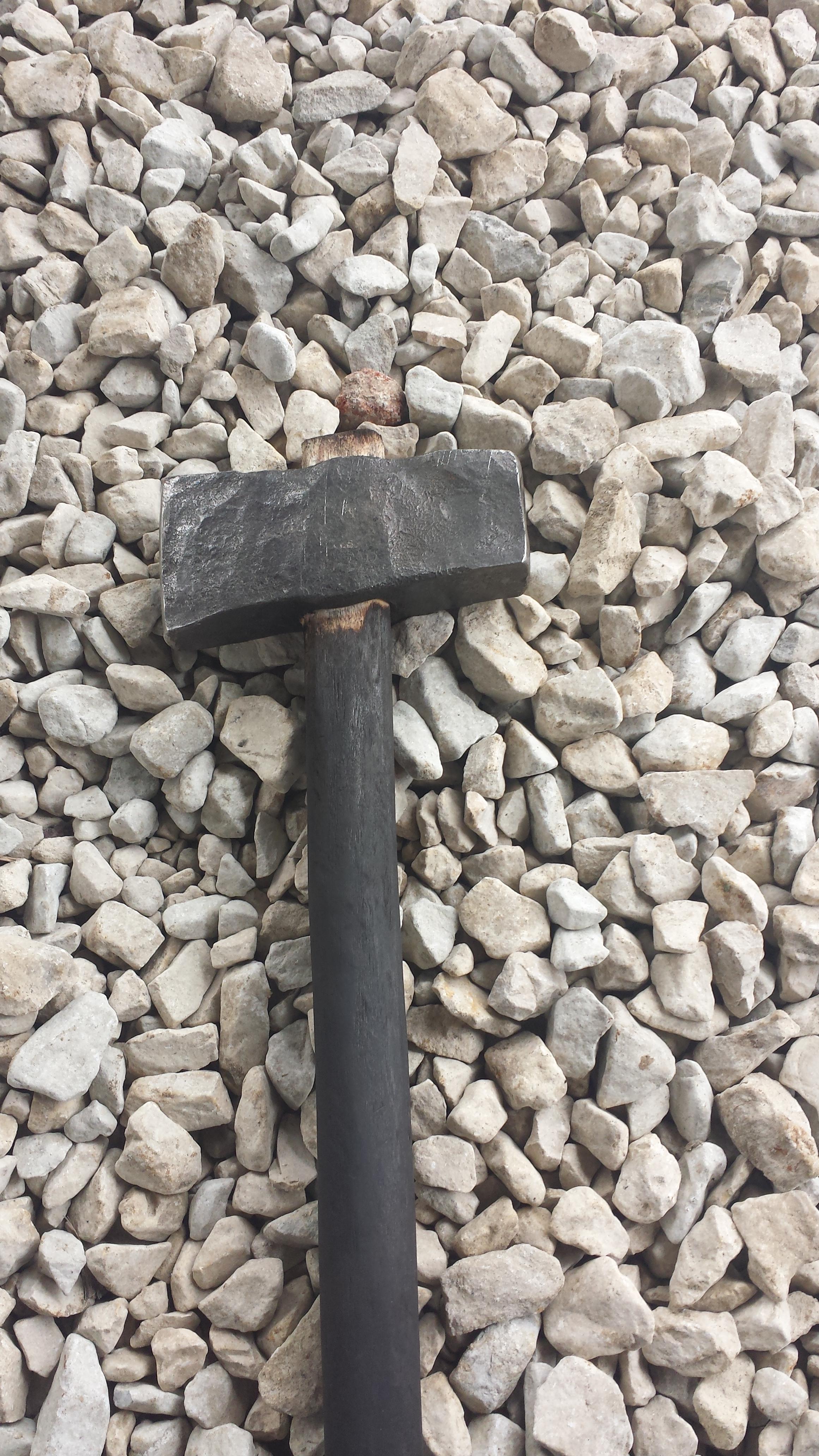

Here is my first top tool. The hammer Eye punch with just a hand hammer!

That's an excellent start! Don't worry about making it perfect, ounce you make the other tools you can make a nicer one. The only criticism I might have would be to make the taper on the handle a little more graceful, or enlarge the eye. Other than that, it looks good! cant wait to see your process!

LB: Yeah, One of my favorite blacksmithing sayings is, if you want it perfect make it perfect. I will admit, I didn't put any real work into that handle, It was a broken sledge hammer handle that I was re-handling a hammer with, But I finished the punch and handled it right away. I get more coal on saturday, So then I will finish my hammer tongs, and tools making will proceed! I'm getting very excited at this point!

Yep! In the words of Brian Brazeal " if you want it perfect, make it perfect!". I couldn't see the geometry on the end of the punch, but just make sure that that is correct, because that is an important part of the tool. I would even say that it is one of the most important parts of the punch to get correct.

I'm pretty sure the geometry is correct. However, the punch is somewhere between 8-12 degrees off from the eye, Which is something I didn't see until it was too late. We'll see though!
4 hours ago, EJRailRoadTrack said:
I didn't put any real work into that handle, It was a broken sledge hammer handle that I was re-handling a hammer with...
Take that handle to the wire wheel on your bench grinder and give it a thorough going over to even out the surface and remove any polyurethane coating that might be on it.  Then paint the bare wood with some boiled linseed oil that's been thinned down a lot with paint thinner or mineral spirits.  This will allow the oil to soak into the wood real easy and makes for a fast-drying finish that looks incredibly good with forged iron tools.
All of my tools get the thinned BLO treatment, and they look like tools you'd expect in a smith's shop! :D

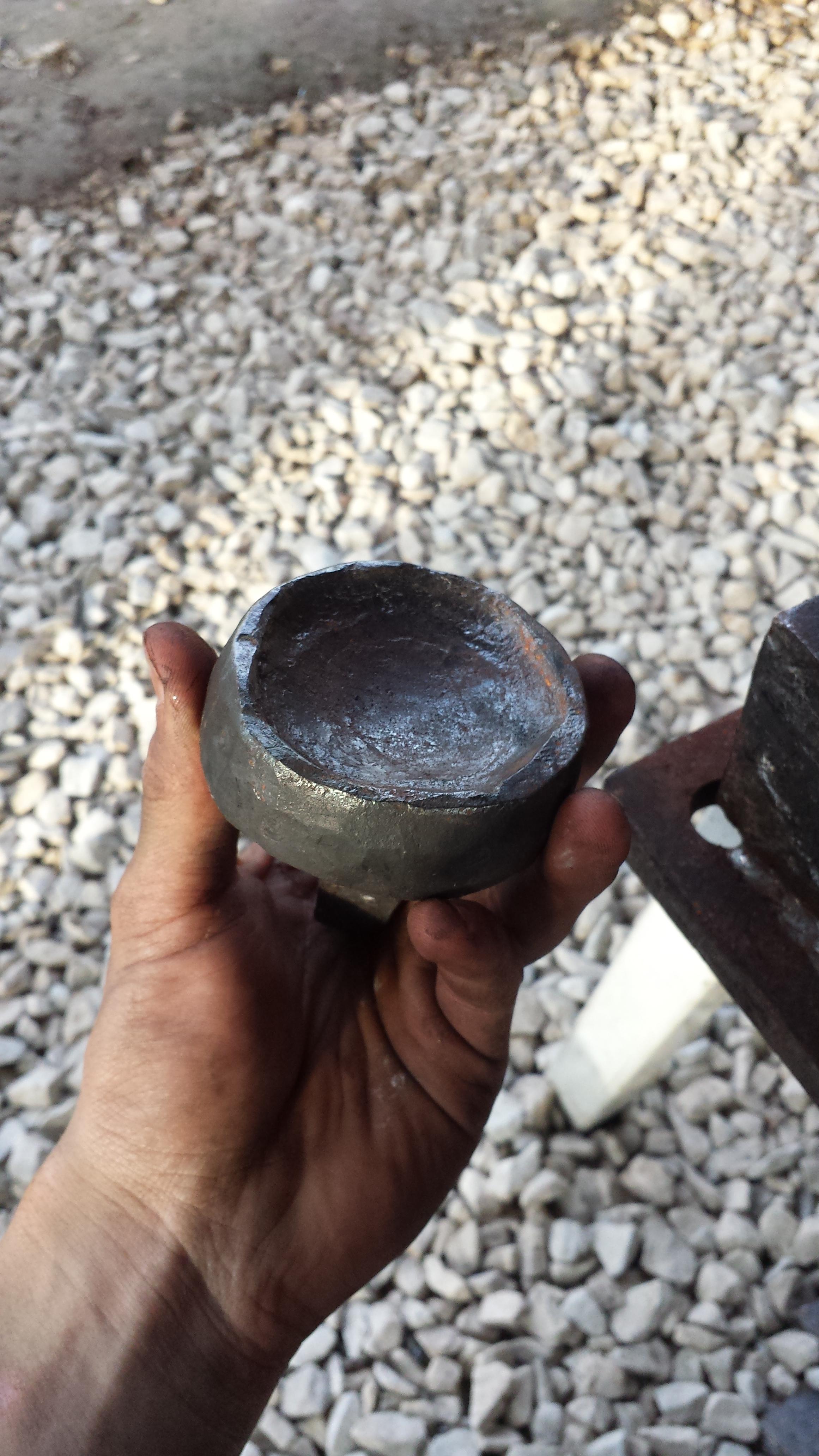

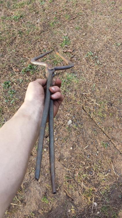

At last! I make it back to this topic. I've finished the cupping tool, the bottom fuller, and the hammer tongs!
I wasn't happy with the cupping tool, Before trying to lip the tool It was not fully flat, So I had flatten it back down then re-lip it. But, it should work!
The handle had been hit a rasp fairly heavily. I like to just put a bit of oil, of any kind my handles, I char some of my handles too, I think it gives a nice look and feel.

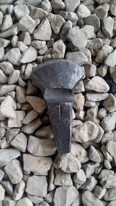

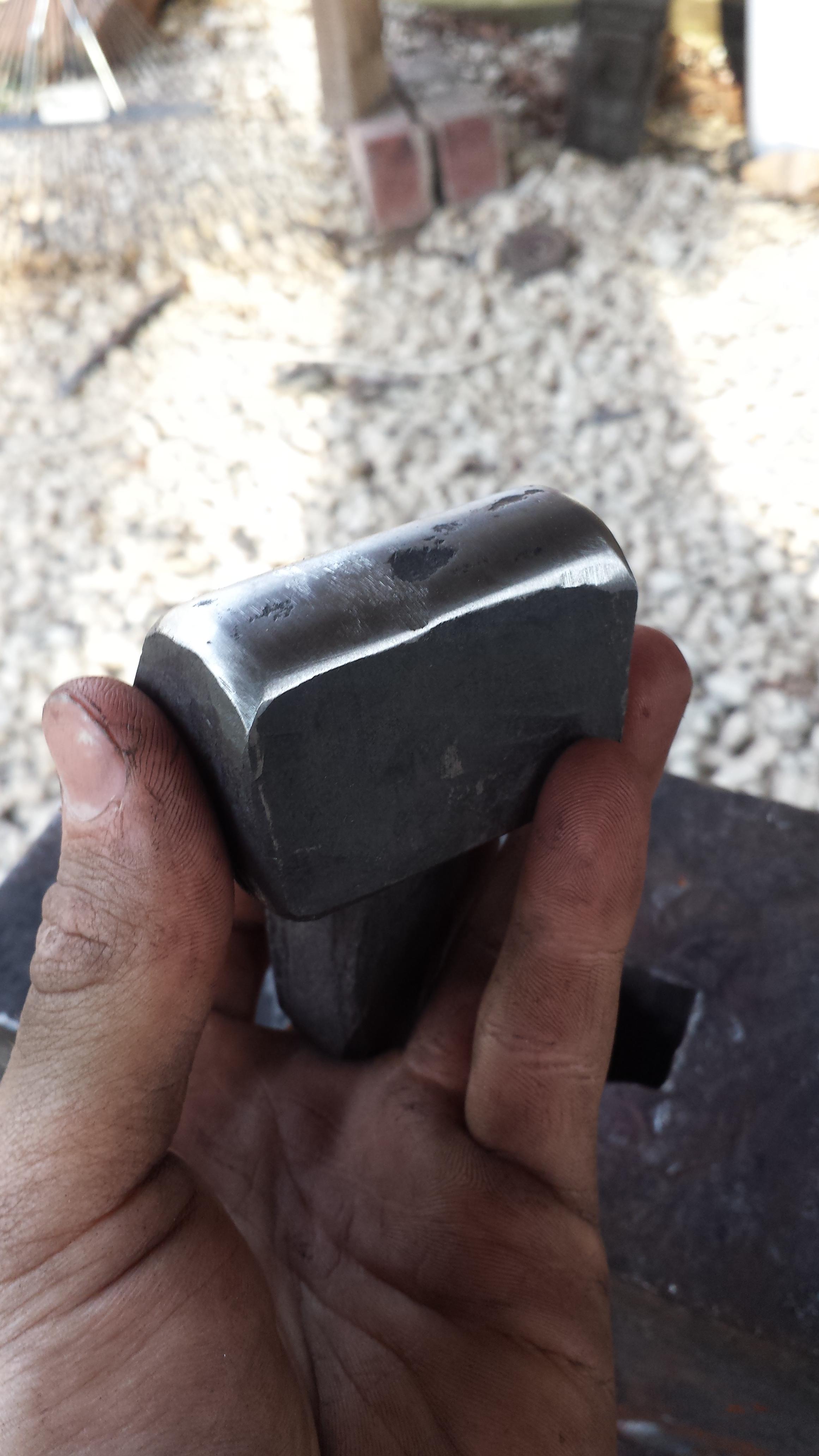

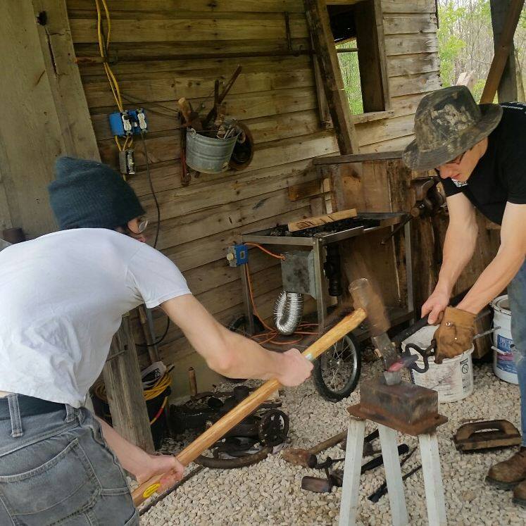

Top fuller and hot cut hardy done!
Forged the top fuller a few weeks back. And my older brother came a struck for a hot cut hardy on tuesday,
Just a couple more tools and I'll be forging hammers!
All that bending over makes my back hurt just looking at the pictures----is that striking anvil at the correct height for the users of it?
If you stand at the same height as the striking anvil it's about perfect, for me anyway. But it's buried in the gravel, so therefore it's a bit short. I'm contemplating a small concrete slab for it, to get it up higher and to make it more stable.
Good job EJ. Just make sure the top fuller is the same radius as the bottom fuller. its not too big of a deal because you will be rotating what ever you are fullering and will even it out, but...
One nice thing about using spring steel for the hammer eye tongs is that you can make the reins thin and light with them still being strong. Don't be afraid next time to make them thinner.
Do you have a flatter or large set hammer? if so I would recommend going over the fuller and hot cut with it, you'd be surprised how much it improves it. Also putting a hot coat of oil helps prevent rust and makes it look nicer. Nice handle, a lot better than the first one!
When putting in the fullers on the Hot cut, if they are off, don't feel like you cant adjust it. on the first few passes with the fuller you can even have your striker give lighter blows until you have the troughs set straight, then he can give full hits. Especially with fullers comparted to a top hot cut or a butcher, you can move it over and straighten out easily without it bein easily noticed in the end.
All the suggestions above are about aesthetics or preferences, so good job! and, these are the first tools, so they will be ugly. once you have these tools made you can go back and replace the older tools with nicer ones.
