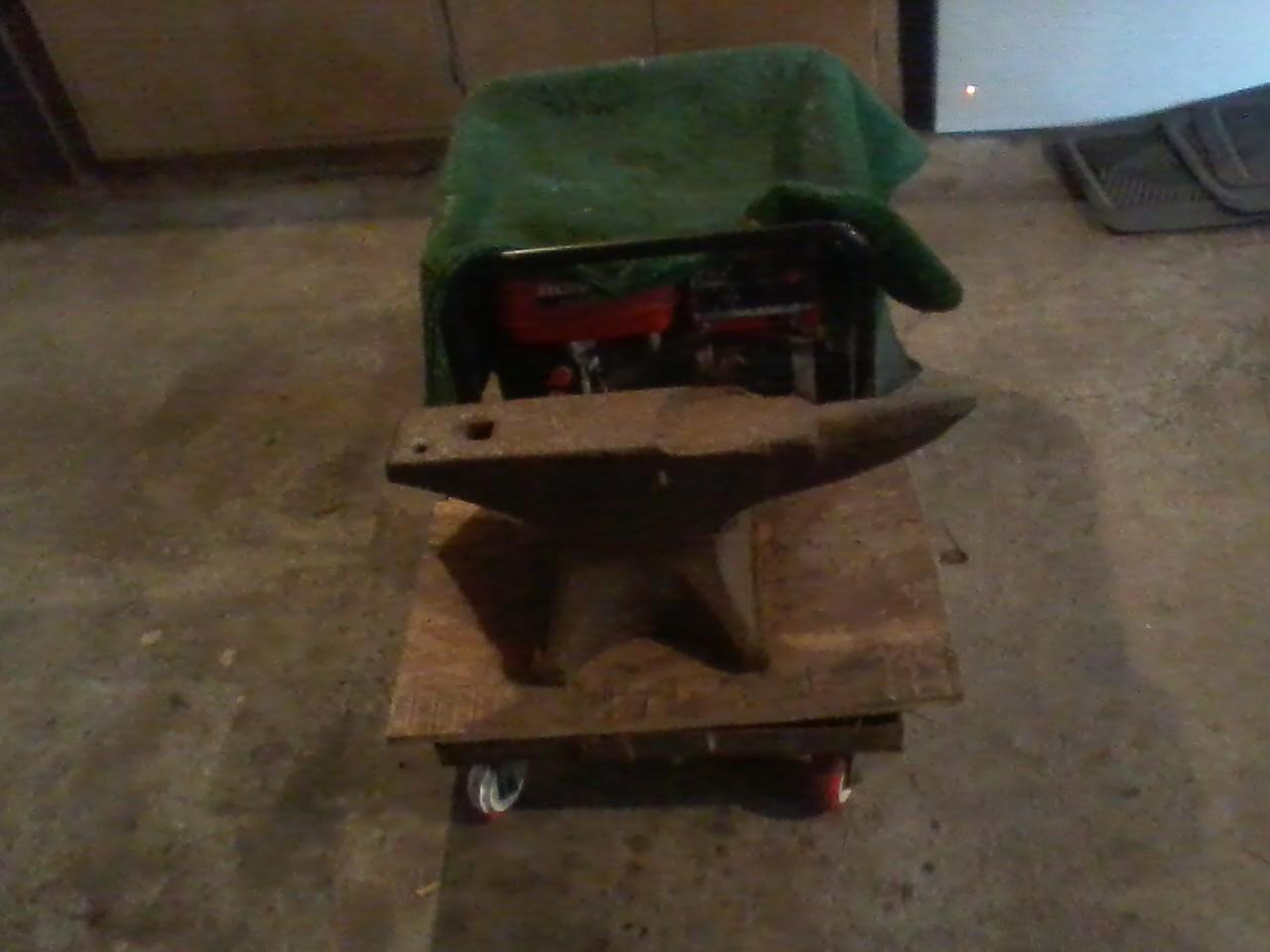

I am looking at an anvil and wanted some opinions on it.  A part of the top plate has chipped off.  If it looks like there is more cracking I will probably pass. I will look it over and check the ring. I don't have a ball bearing, so is there another method to check rebound? Not sure on manufacturer or weight but I think is plus or minus 150 lbs. I am currently using a cheap, small anvil so I feel like anything would be an improvement. He is asking about a dollar a pound so it seems reasonable but I am not looking to buy a paper weight. Thanks
Sure you can use it ... but that's worth $50 not $150
Offer $50. Not worth much more.
Or keep looking. :)
To check if the plate is still attached to the base, use a hammer and let it bounce all over the plate by dropping it from 4" or 6" . If it rings and bounces off, the plate is solid, if it knocks hollow, ( clonk ) give it a miss, not worth your trouble. It's a boat anchor.
Check for manufacturer details, that may make a bit of a difference. (not much)
I agree with Marc1: that anvil has lost a really substantial chunk over the most heavily used section of the face, rendering that area essentially useless. At 50 bucks, it would be a decent starter anvil (if the rest of the face is sound), but otherwise keep looking.but otherwise keep looking.

If it's cheap enough, it might be worth repairing as it looks to be a good brand anvil.  There is still some face over the sweet spot. I might go 50 cents a pound if I really needed an anvil.  A lot of it depends on where you are at and the density of anvil in that area.  Here in New Mexico, USA they are a lot rarer than back in Ohio, USA and both those places are in the same country!
Thanks for the input guys.  I am in Northern California, about 5 hours north of San Francisco, on the coast.  There aren't a lot of anvils available around here.  From what I have read, replacing the broken portion with a new plate usually isn't all that successful.  Like you said though, if it's cheap enough I'd be willing to try.
It appears to be a Peter Wright by the flats on the feet. If so, it is a wrought iron body with a steel top plate.
I agree with the others, it isn't worth $1 a pound.

Hard to tell brand without better images but I concur with everyone else that it does look like a PW by the feet. If it's anything like mine the rest of it still has some promise; Like someone said before ask less for it.

Yes replacing the plate with a plate is generally a failure.  Replacing the missing plate by building up with the proper rod works Search on Robb Gunter anvil repair method

Well I bought it. Seems solid other than the chip. It is a PW. Weighs about 140. Paid $90 for it. I'm going to keep an eye out for a nicer anvil but this will be a step up for now. Thanks for weighing in everyone.
