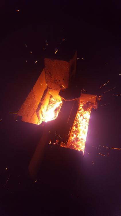

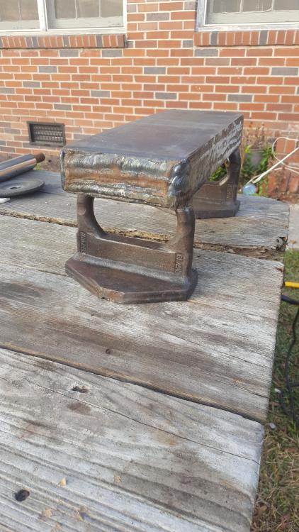

MarvinB Posted December 5, 2016 Share Posted December 5, 2016 Figured I'd share i built myself a striking anvil and successfully heat treated it Quote Link to comment Share on other sites More sharing options...

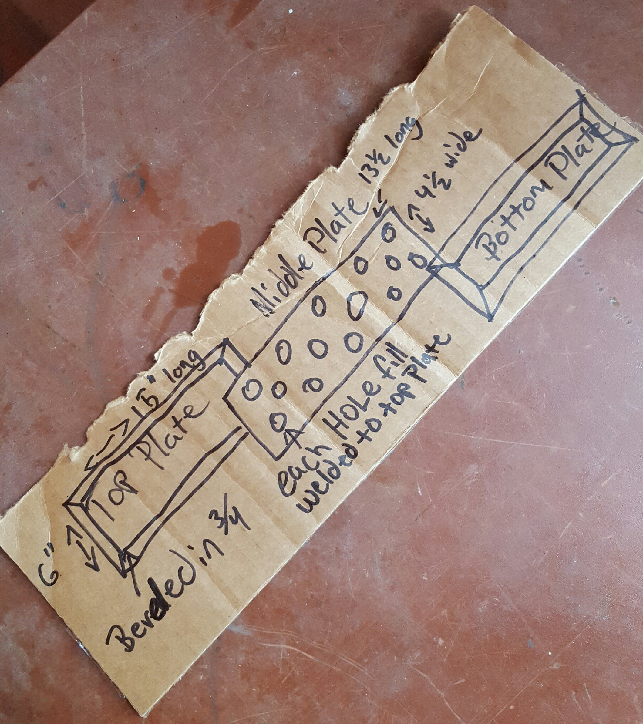

Latticino Posted December 5, 2016 Share Posted December 5, 2016 Cool legs, and congrats on the successful heat treat. What size is the anvil and how did you accomplish your quench? Just curious why you didn't bore a hardy and pritchel hole in it before hardening. Most of the striking anvils I've seen, including the one I've been working on for myself, have them. Also, it looks like you have welded multiple layers of 1/4" thick steel plate together around the perimeter. If this is the case I'd be interested in how it holds up to heavy striking without full penetration welds. Quote Link to comment Share on other sites More sharing options...
C-1ToolSteel Posted December 5, 2016 Share Posted December 5, 2016 Nice. What kind of steel did you use? The few striking anvils that I've seen were mild steel. Next thing for you to do is make a really sturdy base, something set into the ground and welded to your anvil. Quote Link to comment Share on other sites More sharing options...

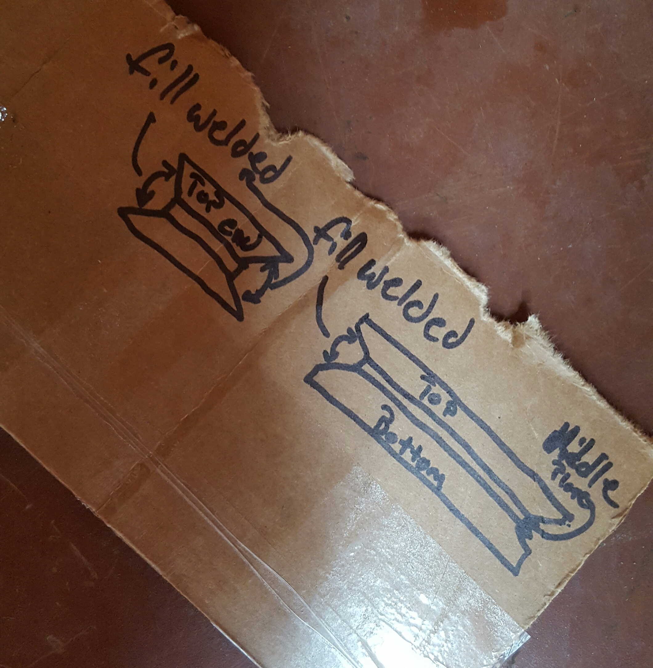

MarvinB Posted December 5, 2016 Author Share Posted December 5, 2016 This was a peace off a coal conveyor I got from the power house I was working at the legs on the avil where originally on each end of the plate which was about 30" long and 3/4 thick I cut it in half added a peace of 1/2 in to the center I drew this out hopefully easier to understand Quote Link to comment Share on other sites More sharing options...

MarvinB Posted December 5, 2016 Author Share Posted December 5, 2016 2 minutes ago, C-1ToolSteel said: Is it high-carbon? If not, that would make heat treating unessisary. It wasn't high carbon I'm not sure what it was exactly for what it was being used for before I assumed it was good carbon of some kind before I treated it i could hit it with my rounding hammer and dent it so I treated it and it's harder than my hammers Quote Link to comment Share on other sites More sharing options...

MarvinB Posted December 7, 2016 Author Share Posted December 7, 2016 On Monday, December 05, 2016 at 1:23 PM, Latticino said: Cool legs, and congrats on the successful heat treat. What size is the anvil and how did you accomplish your quench? Just curious why you didn't bore a hardy and pritchel hole in it before hardening. Most of the striking anvils I've seen, including the one I've been working on for myself, have them. Also, it looks like you have welded multiple layers of 1/4" thick steel plate together around the perimeter. If this is the case I'd be interested in how it holds up to heavy striking without full penetration welds. Realized I didn't answer ya about the hardy hole I have a mouse hole anvil with a hardy so didn't really need one in this Quote Link to comment Share on other sites More sharing options...
JHCC Posted December 7, 2016 Share Posted December 7, 2016 19 minutes ago, MarvinB said: Realized I didn't answer ya about the hardy hole I have a mouse hole anvil with a hardy so didn't really need one in this The hardy hole in a striking anvil isn't just to hold the various hardy tools, but also for making them. If you need to upset a piece of steel to make a fuller or a swage, it's better to use a striking anvil: it's lower and therefore at a better height for sledgehammering, and it's less likely to lose its heel to a missed blow. I have a Mouse Hole anvil as well, but I still made myself a portable hole. Quote Link to comment Share on other sites More sharing options...
MarvinB Posted December 7, 2016 Author Share Posted December 7, 2016 (edited) 3 hours ago, JHCC said: The hardy hole in a striking anvil isn't just to hold the various hardy tools, but also for making them. If you need to upset a piece of steel to make a fuller or a swage, it's better to use a striking anvil: it's lower and therefore at a better height for sledgehammering, and it's less likely to lose its heel to a missed blow. I have a Mouse Hole anvil as well, but I still made myself a portable hole. I didn't think about that but if I ever need one I guess I'll just have to build one but as of right now I don't see any major sledge hammer swinging in my future Edited December 7, 2016 by MarvinB Quote Link to comment Share on other sites More sharing options...

MarvinB Posted December 10, 2016 Author Share Posted December 10, 2016 I guess I shouldn't have called it a striking anvil that's not what it's being used for .I'm using it as my primary anvil and I don't need a hardy hole in it more than likely I want ever make any hardy tools but if I was to choose to us it as a striking anvil with large sledges I will. I'm completely comfortable doing it the entire anvil isn't hardend I'm sure it's probably a little harder than it was from the middle to the bottom the face took the heat and I watched it to make sure as it started glowing red it didn't make it past the half way point that way from the middle down through the legs wouldn’t be as hard as the face.I weld for a living and the way i welded it and the amount of weld it would take more than a few guys with sledge hammers to bust it they might give it a sway back like a ol broke down mare Quote Link to comment Share on other sites More sharing options...
