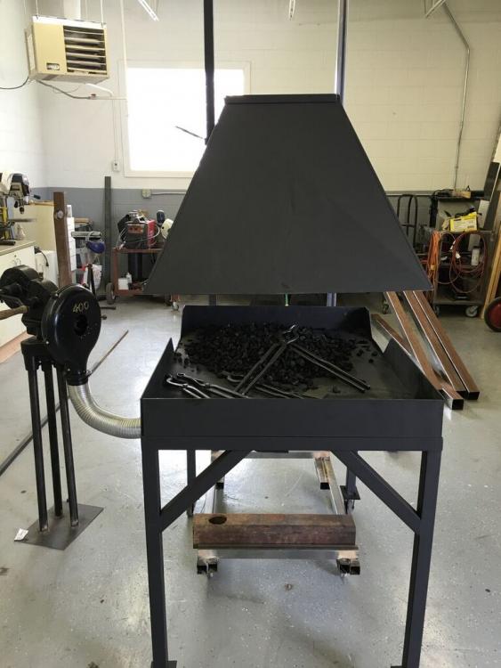

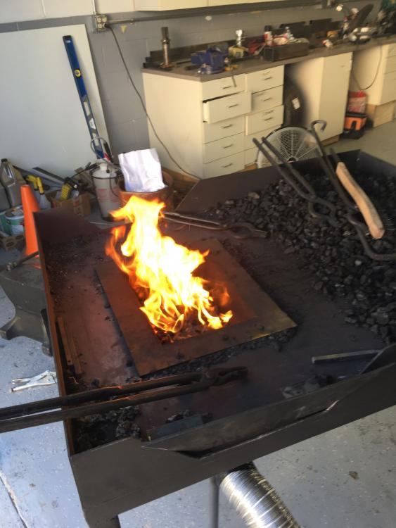

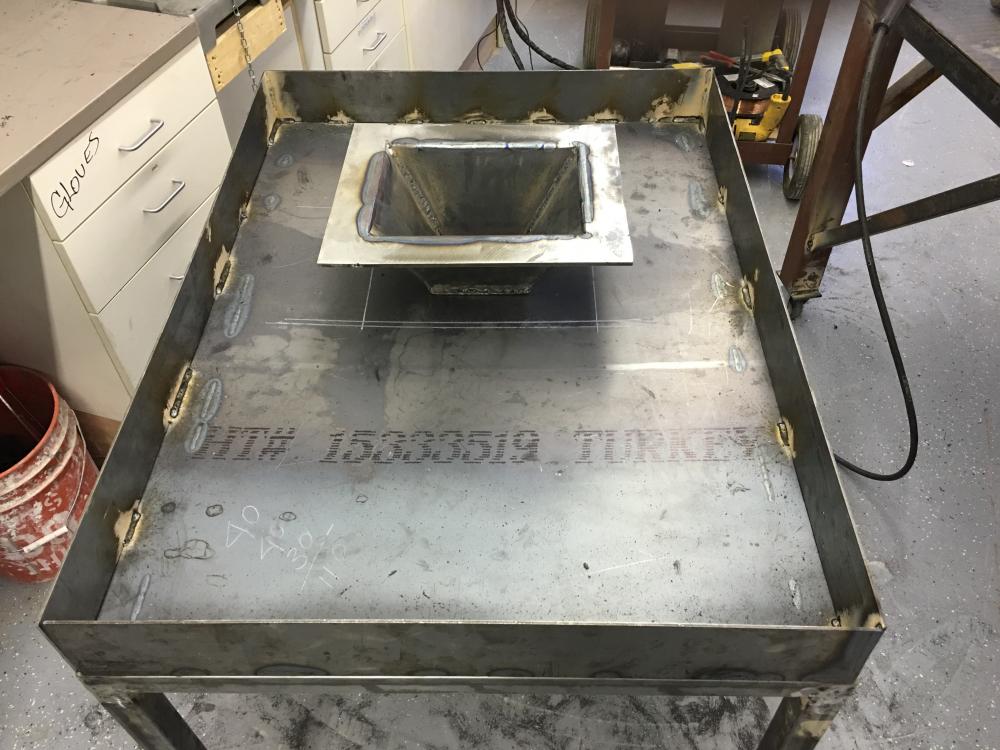

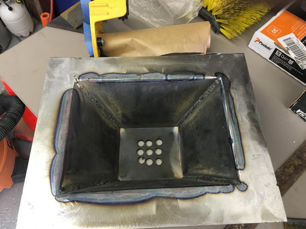

Thought I would share
The fire pot looks a bit deep IMO, but overall Nice work!
You can make tong racks that slip over the rim on your forge to keep them handy where you need them and out of the way. Just remember to give them a dip in the water before you hang them as the bits are what's sticking up, it's just too easy to grab the hot end. If the racks just slip on the rim you can move them as necessary, I often use them to hold lengths of stock temporarily.

My travel coal forge has a tong rack that fits in the top of the pipes for the legs too, actually 2 of them;  only as it's generally worked from the sides I bowed the racks out a bit so the tongs stay cooler; also for the longer one I did some loops to make hammer holders.
Definitely a task made easier with a bending jig in a postvise you can access from all sides: Heat a section, place in jig, run around the vise.  flatten with a wood or rawhide mallet, repeat.  I use 3/8" round IIRC as I can do the final bending cold to get the arc I want placing the straight sections into the postvise opened wider than the stock and give it a good tug.  If you go too far a nice broad anvil horn can help back off the bend a bit.

You are right it is about two inches to deep, it is six inches deep, I'm thinking it should have been like four inches?
Thank all of you guys for the suggestions, I see tong racks in my very near future like probably Tuesday :-)
Two to three inches deep has been good for me. That's just me tho. 2" for small stuff and 3 for larger. It is opinion based and others have different experiences. im still learning myself after 3 years.
