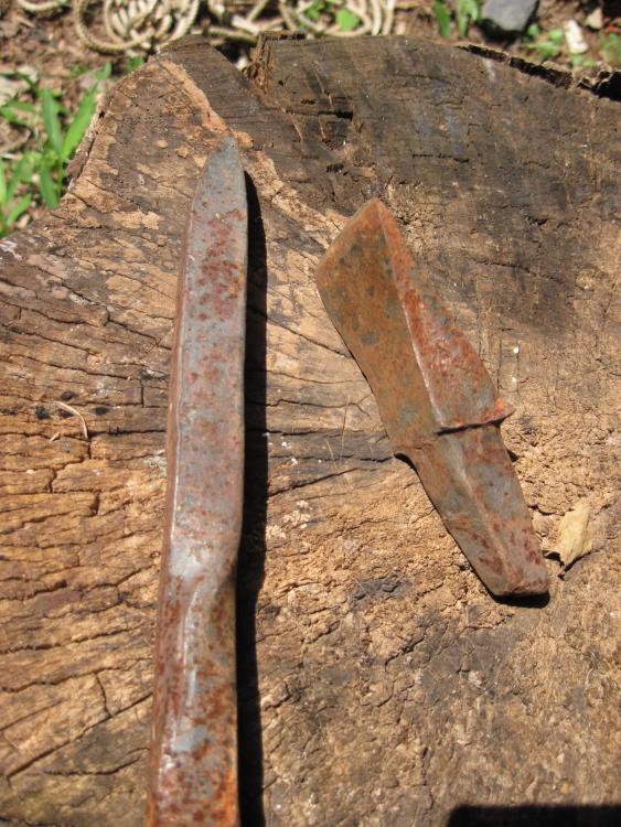

I used a railroad spike before I even knew what I was really doing. It needed sharpening at the beginning of each forging session, but on the upside, it made a great small fuller by the end of each session.
Bottom line: There is a big difference between something 'working' and something working well. So, railroad spike (which is low carbon, doesn't harden) is workable, but its really a make-do sort of thing. Much better to have something that just plain works, and works well. IMG_0023.JPG
On the left was the spike, and on the right is a 80 point carbon steel hardie that I made. The difference between the two is astounding. So, if you do it well the first time, no need to redo it!
