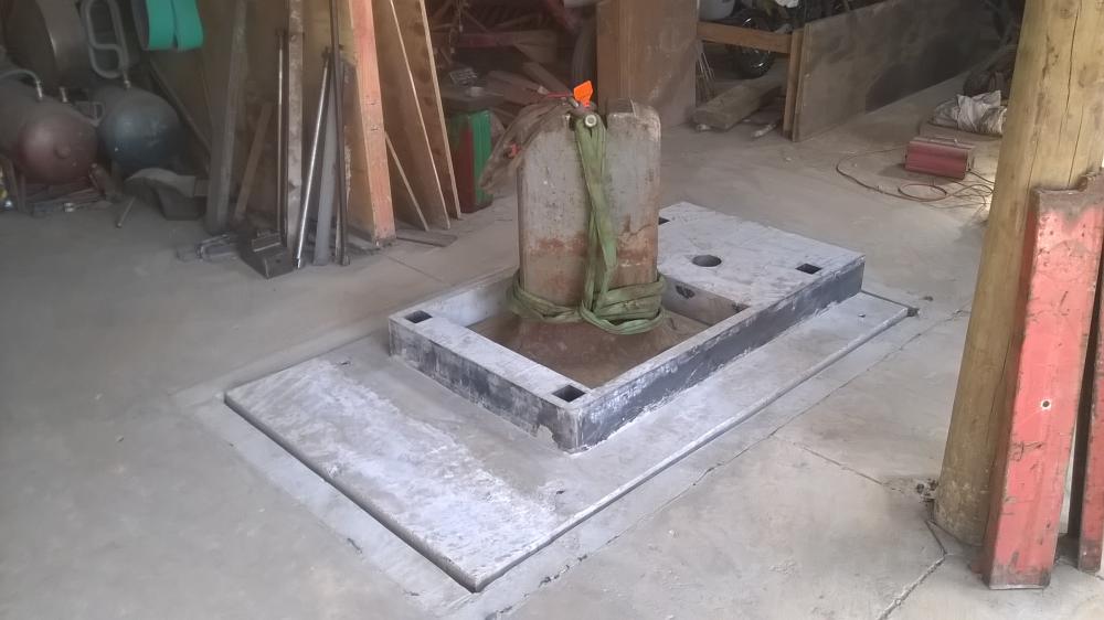

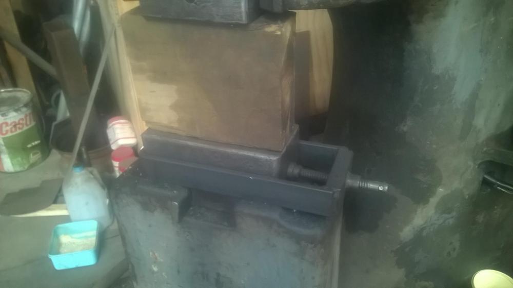

BeaverNZ Posted November 14, 2016 Author Share Posted November 14, 2016 The Tee bolts are finished and so are the Tee bolt mounting tube, Next is the form work or boxing assembly which should be less work than the last time but still quite a bit of work. This hammer had better work as i have never seen it go but i cant see why it wont as I believe it hasnt done alot of work as it has little wear. Thanks John for the complement as I said I will be abit mifft if there any major problems Quote Link to comment Share on other sites More sharing options...
forgemaster Posted November 14, 2016 Share Posted November 14, 2016 I don't know if I said it before or not, but it is a good idea to leave the pockets on the ends of the bolt tubes long enough so there is still room if you break a head off a bolt after a while, to get another bolt in there without having to go fishing for the broken off head in the bottom of the pocket. Don't ask me how I know that this is a wise move. Quote Link to comment Share on other sites More sharing options...
BeaverNZ Posted November 16, 2016 Author Share Posted November 16, 2016 Hi Phil Yes fair comment and there is enough room for a head section to drop down just in case but I think the probable failure point will be at the threaded end but time will tell. Any suggestions for improvement are all noted I am making the boxing for the ineria block now and will be lifting the foot of the hammer by 150mm or 6 inches for a better working height. Thank you Cheers Beaver Quote Link to comment Share on other sites More sharing options...
Alan Evans Posted November 17, 2016 Share Posted November 17, 2016 On 10/11/2016 at 10:17 AM, Alan Evans said: Nice job...of course once you have got the hammer in, you will be able to forge the bolts for the next one! You have learned of the advantage of tying on a coffee tin to create a concrete free chamber beneath the Tee-slotted plate so you can get the bolts in and out? This chamber should be deep enough in case the Tee lugs ever did shear off so that you can just leave them in there and still get another bolt into place.... Alan On 14/11/2016 at 8:46 AM, forgemaster said: I don't know if I said it before or not, but it is a good idea to leave the pockets on the ends of the bolt tubes long enough so there is still room if you break a head off a bolt after a while, to get another bolt in there without having to go fishing for the broken off head in the bottom of the pocket. Don't ask me how I know that this is a wise move. What do they say about a wise man learning from his mistakes....and a lucky man learning from the mistakes of others? Mistakes are prevented by learning from experience...experience is gained through making mistakes! Alan Quote Link to comment Share on other sites More sharing options...

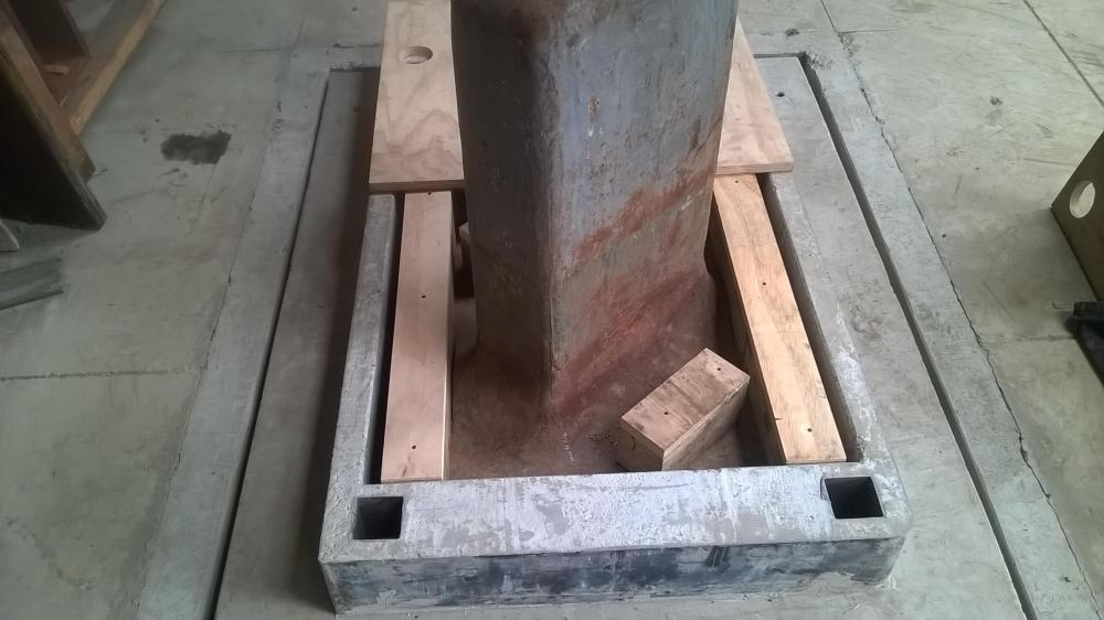

BeaverNZ Posted January 5, 2017 Author Share Posted January 5, 2017 Im Very pleased I have got the ineria block placed in the hole. Its sitting on 240 mm of oregon timber which should be a good sound/shock deadener Quote Link to comment Share on other sites More sharing options...

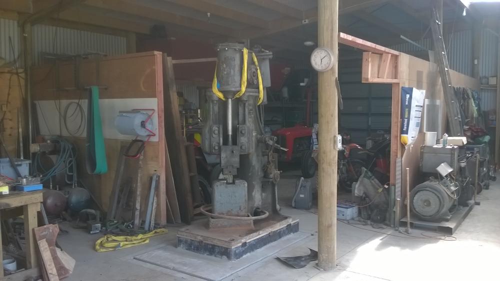

Andrew T Posted January 9, 2017 Share Posted January 9, 2017 What have you got in the bottom of the hole for padding? It looks like a couple of 2x4s. Quote Link to comment Share on other sites More sharing options...
BeaverNZ Posted January 10, 2017 Author Share Posted January 10, 2017 Andrew there is 3 8x3 oregon timber blocks at each end so they are 240mm thick in total. The hammer is finally placed permanantlly YIPPIE all thats left to do is mount the motor I am going to remount that and mount it abit more elegantly than what came with the machine. Getting excited its going to be a struggle to do any paying work this week Quote Link to comment Share on other sites More sharing options...

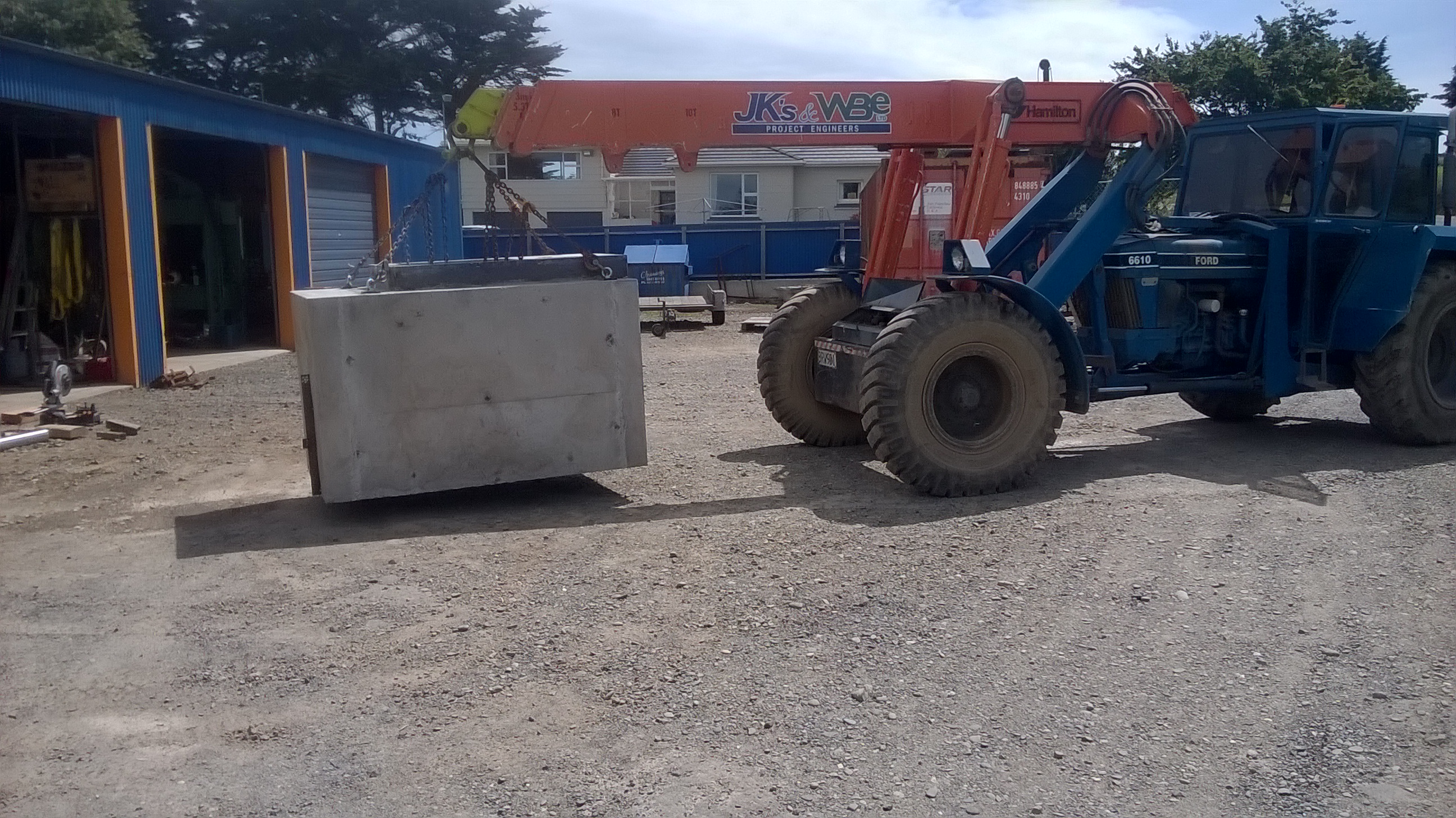

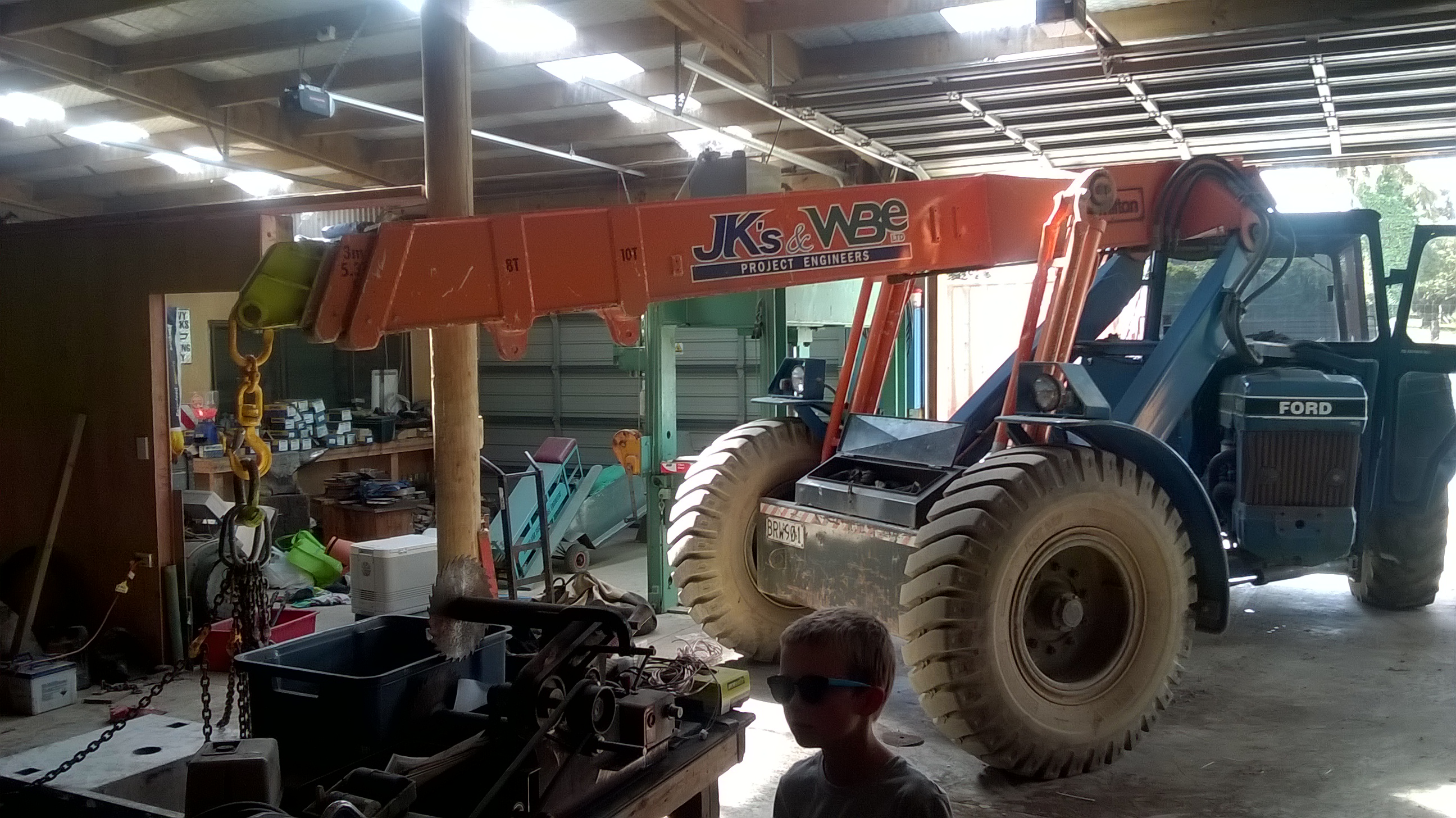

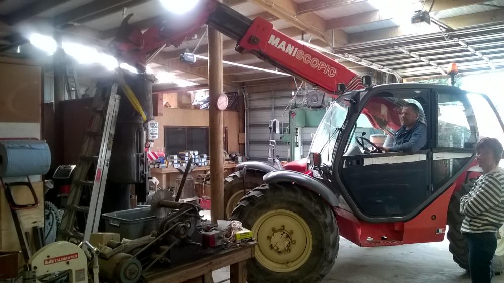

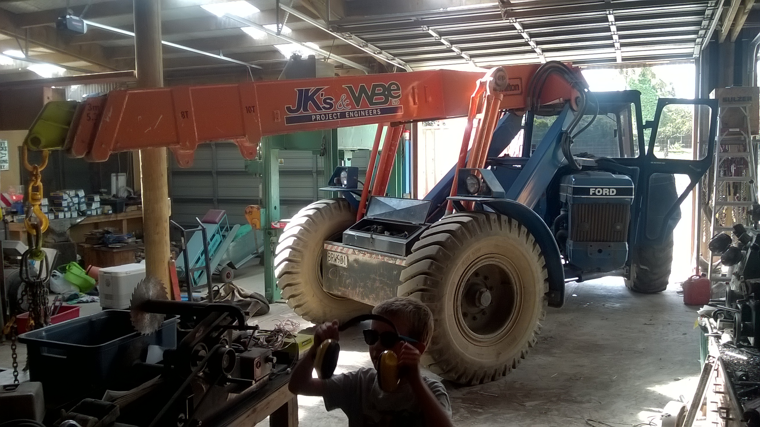

Alan Evans Posted January 10, 2017 Share Posted January 10, 2017 How much headroom did you have above the boom when you lifted the hammer over the anvil? I had to make a special hook fitting to go on the end of a Hyab jib to get round a similar problem once. Looking good... Alan Quote Link to comment Share on other sites More sharing options...
BeaverNZ Posted January 10, 2017 Author Share Posted January 10, 2017 Alan When we were lifting the hammer over the anvil there was about 20mm of room spare, Actually broke off the heat sensor for the alarm system. I got someone with the Manitou because it was close and avilable and cost me a twin carb plate for a weiand 6 71 blower that I was unlikely to ever use but made it a bit tricky because of the goose neck in the boom. Quote Link to comment Share on other sites More sharing options...
BeaverNZ Posted January 12, 2017 Author Share Posted January 12, 2017 Its alive Im as happy as a dog with two spigots, I just need to fit the guarding put some paint on the motor mount and fix up the dodgy wiring and get a wedge made to hold the bottom anvil block in place that was the only piece I couldnt find when I brought it https://youtu.be/t4sI2vJ208s Quote Link to comment Share on other sites More sharing options...
