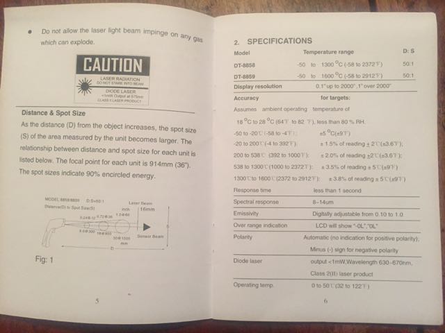

Following advice from IaninSA on here, I found a CEM IR temperature gun which goes from -50˚C up to 1600˚ C (and will also read in ˚F, -58 to 2912) for around £130.00 on Amazon uk. It seems to be very sensitive at high and low temperatures and is much more convenient and versatile than a built in thermocouple...so far I have used it to check my furnace temperatures 1350˚C and a chiller cabinet I was setting up for deer at 4˚ C .  Another useful feature is, it has a very small focus point so you can take a reading off various places along your workpiece if you need to.
Thoroughly recommend one even if you do have a freebie thermocouple to play with.
Alan
Concur.
The portable Infra Red Gun is a far better system.

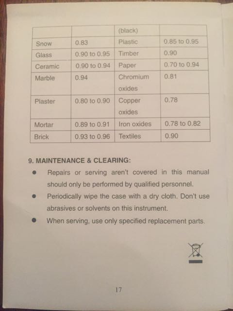

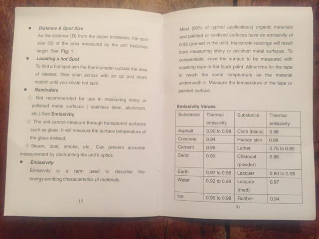

Short answer is no idea. Need another one to compare it with!
It seems to give reasonable results...ambient temperature of objects in the room  etc.
My one has a trimming system to cope with the emissivity of different materials, I presume the more expensive ones would also have a similar way to calibrate them.
According to the book of words, less than+/- 3.8% at the top of the range +/- 5˚C between 1300 and 1600˚C
And +/- 1.5%  or +/- 2˚C between -20 to 200˚C
Alan
