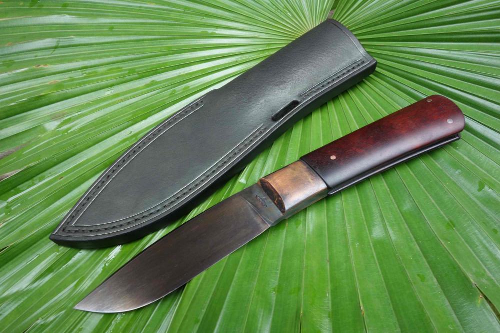

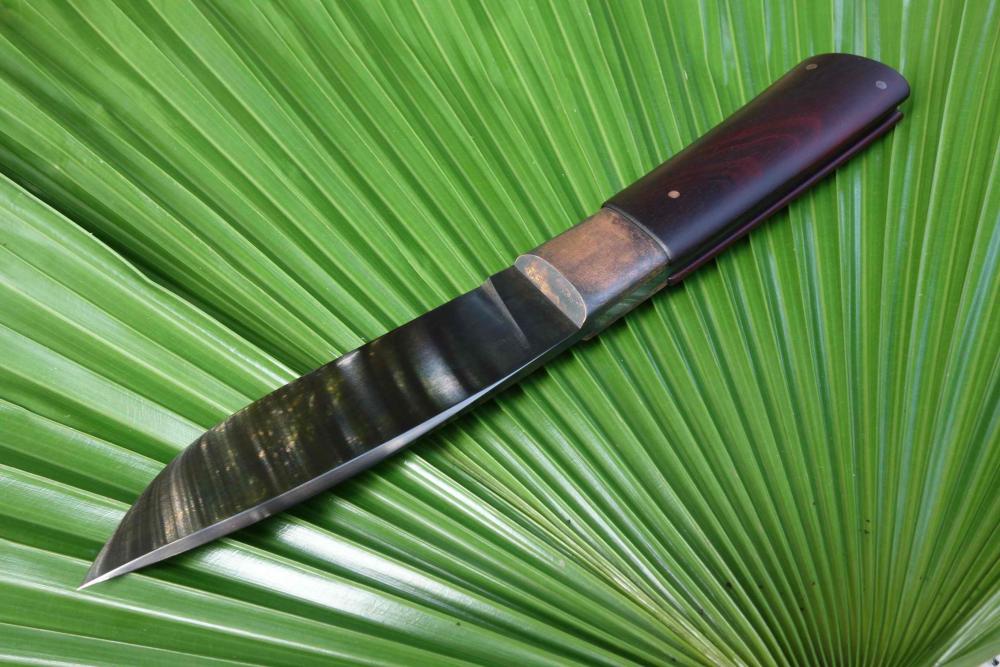

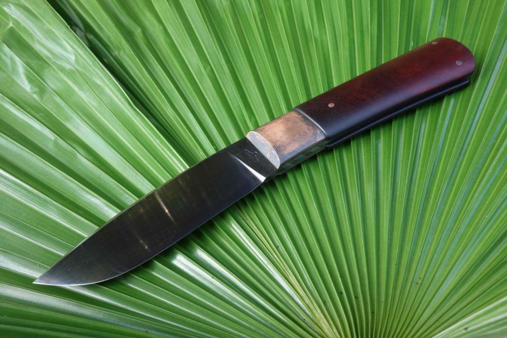

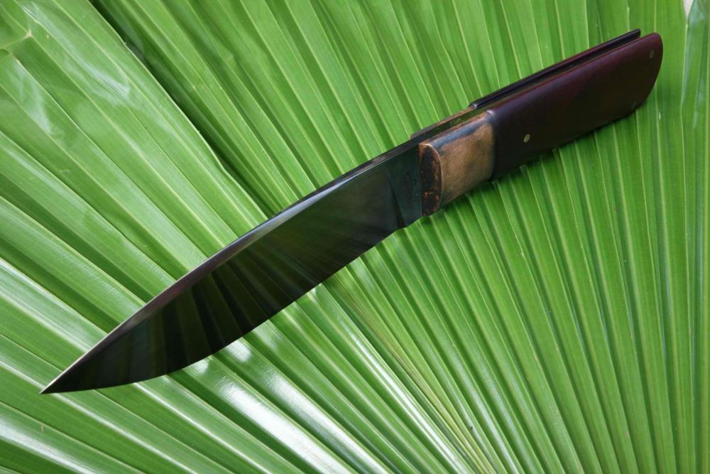

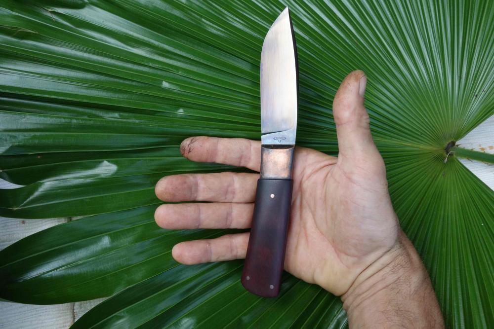

templehound Posted August 26, 2016 Share Posted August 26, 2016 He travelled a long way from Thailand to Austria. 1.2516 (120WV4) blade, forged from round bar, bolsters and pins are copper and Indian rose chestnut for the slabs. Overall length 230 mm. The sheath is made from water buffalo hide. Quote Link to comment Share on other sites More sharing options...

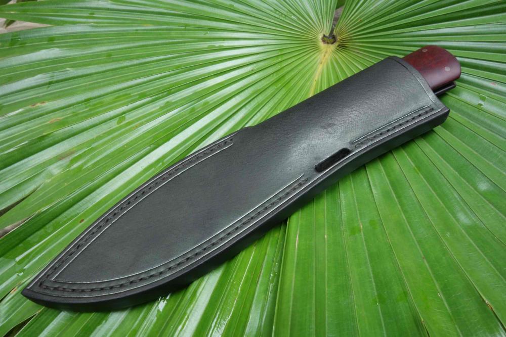

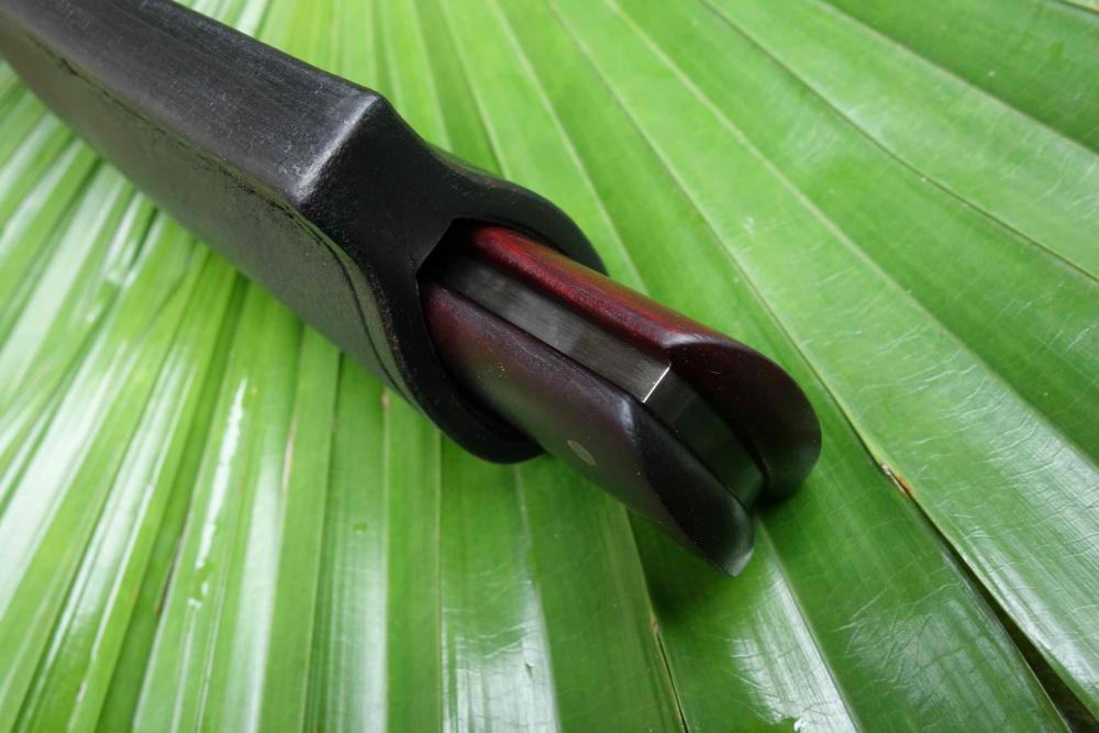

bigfootnampa Posted August 26, 2016 Share Posted August 26, 2016 This is the nearly flawless type of work we've come to expect from you! The sheath design is quite unusual! I am not quite sure how the sheath's single slot is intended to work. Very cool stuff though! Quote Link to comment Share on other sites More sharing options...

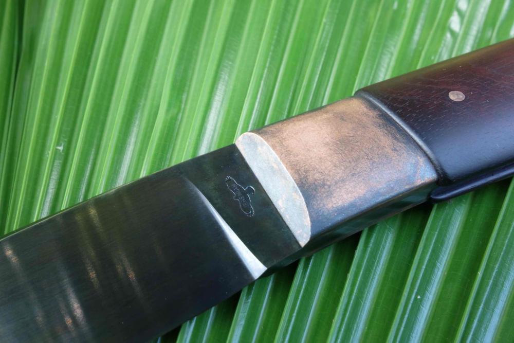

Biker Bo Posted August 26, 2016 Share Posted August 26, 2016 That's beautiful. I'm working on my first San Mai ( cable and band saw blade) right now. I've made a copper bolster and have been searching for a patina look that I like. If you don't mind me asking how did you achieve that color on your copper . Thanks . Quote Link to comment Share on other sites More sharing options...

templehound Posted August 27, 2016 Author Share Posted August 27, 2016 19 hours ago, bigfootnampa said: This is the nearly flawless type of work we've come to expect from you! The sheath design is quite unusual! I am not quite sure how the sheath's single slot is intended to work. Very cool stuff though! Thank You bigfootnampa! The long hole is the option to tie the knife to the belt or the backpack. 16 hours ago, Biker Bo said: That's beautiful. I'm working on my first San Mai ( cable and band saw blade) right now. I've made a copper bolster and have been searching for a patina look that I like. If you don't mind me asking how did you achieve that color on your copper . Thanks . I used potassium polysulfide (https://translate.google.co.th/translate?hl=en&sl=de&u=https://de.wikipedia.org/wiki/Schwefelleber&prev=search) Thank You Biker Bo! 16 hours ago, Gergely said: It's a beauty. Congratulations! Best wishes: Gergely Thanks Gergely! I appreciate it a lot! Quote Link to comment Share on other sites More sharing options...
Glenn Posted August 27, 2016 Share Posted August 27, 2016 Liver of sulfur or Hepar is an old name for a mixture of potassium sulfide , potassium polysulfide , potassium and potassium sulfate . They are obtained by melting together potassium carbonate (potash) and sulfur absence of air at 250 ° C. The name goes back to the liver brown color of the mixture. Quote Link to comment Share on other sites More sharing options...
