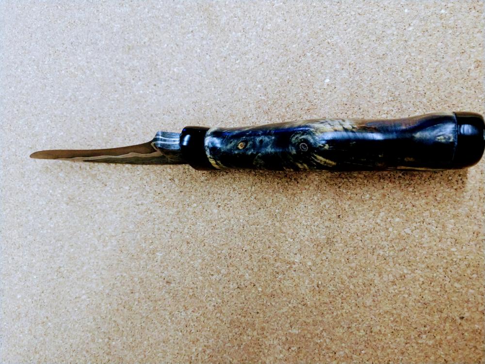

  2. Forged from a slice of outer bearing race. Brass is from the separator. Black paper marcata trim. Not sure the type of wood but I've had it laying around since the mid 90.

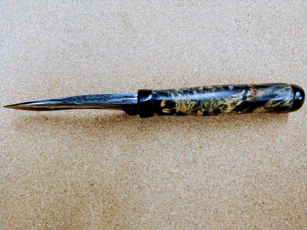

  3. Thanks. I twisted it two times to get it that tight of a pattern. I sure hope I get it right on the next one.
  4. This is a new way to finish that I've been playing around with. I almost threw the billet away because of the open weld. Glad I didn't.

  7. Forged up some choker cable. It's got an open weld but it's not caused a problem . The handle is maple burl . I drilled the aluminum rod and inserted brass pins. Copper buss bar for the guard and a piece of black and silver dyamomd wood for the butt cap.
