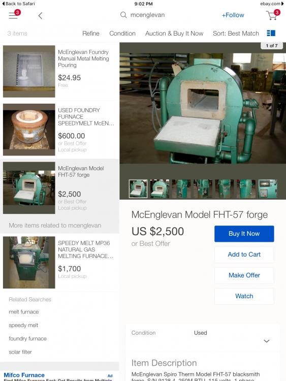

KeithSS Posted August 24, 2016 Share Posted August 24, 2016 Hi, was hoping someone had experience with one of these forges. There is one on eBay for $2500. I just got one in good shape needs some parts and some work. I really like that this forge use propane or nat.gas.its all automatic as far as adjustments ,set the temp and go. I do guess that this is how it works. I have been forging from a aspirated propane forge and it works great for me. im just wondering if this forge is worth spending time setting up and Useing as my daily forge? heres some pics. Quote Link to comment Share on other sites More sharing options...

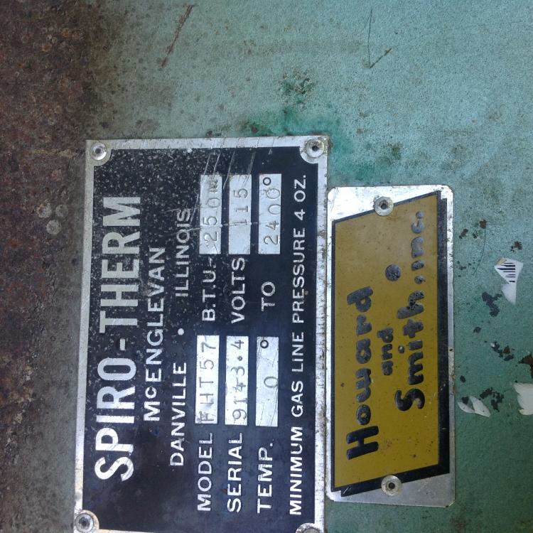

KeithSS Posted August 26, 2016 Author Share Posted August 26, 2016 I didn't pay $2500 for it .i got it for a couple hundred . I was just Useing ebays pictures. The company that makes these said , the new ones are built the same as the old ones except for the electronics are updated. So, I couldn't figure out how to see what the cost to operate it will be. The name plate says 250 m btu. 1.000.000 btu = 10 therms = $9.00 I pay 90 cent a therm in mi. (How long does a therm last?) i know it can't cost as much as my math says. Quote Link to comment Share on other sites More sharing options...

ThomasPowers Posted August 26, 2016 Share Posted August 26, 2016 Is M Million or Thousand ? Quote Link to comment Share on other sites More sharing options...
Latticino Posted August 26, 2016 Share Posted August 26, 2016 10 hours ago, ThomasPowers said: Is M Million or Thousand ? Unfortunately both have been used as a standard abbreviation. However, these days (as counterintuitive as it seems) MBTU typically refers to thousands of BTU and MMBTU refers to millions. Also I believe that typically burner ratings are in BTUH (BTU per hour) or MBH (thousand BTU per hour). If you are in contact with the company, I would ask them for clarification. Quote Link to comment Share on other sites More sharing options...

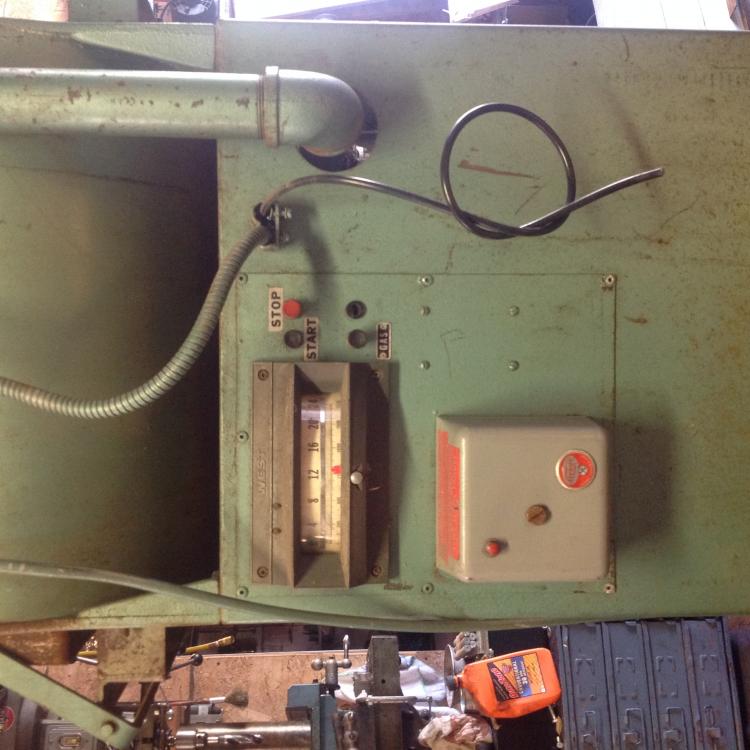

KeithSS Posted August 26, 2016 Author Share Posted August 26, 2016 I will ask the company if its millions or if its thousands of btu. Thats a good point . I have seen boilers rated in the millions , but they had a 4" gas line going to them with a big gas pump. It's a 3/4" fitting going into this unit. I think the strength of this forge is the shell and firebrick, it has 2 gas lines coming in the top side of the shell and on the other side 2 gas lines going in the bottom and it must make a swirling movement. Rated to 2400 deg. The brick is all curved round and in perfect shape. i ordered a $100 dollars worth of parts a spark plug ignitor and a flame sensor. im thinking if it doesn't start, its going to be the fire eye box which I'm thinking its a $500 dollar part . Then I might have another machines skeleton standing in the corner of the shop taking up room. Quote Link to comment Share on other sites More sharing options...
KeithSS Posted August 26, 2016 Author Share Posted August 26, 2016 Yep, the mfg. said it was supposed, To read 250.000 btu. Not million. Quote Link to comment Share on other sites More sharing options...
ThomasPowers Posted August 26, 2016 Share Posted August 26, 2016 makes a difference! I wasn't believing the numbers I was seeing if I assumed million... Quote Link to comment Share on other sites More sharing options...
