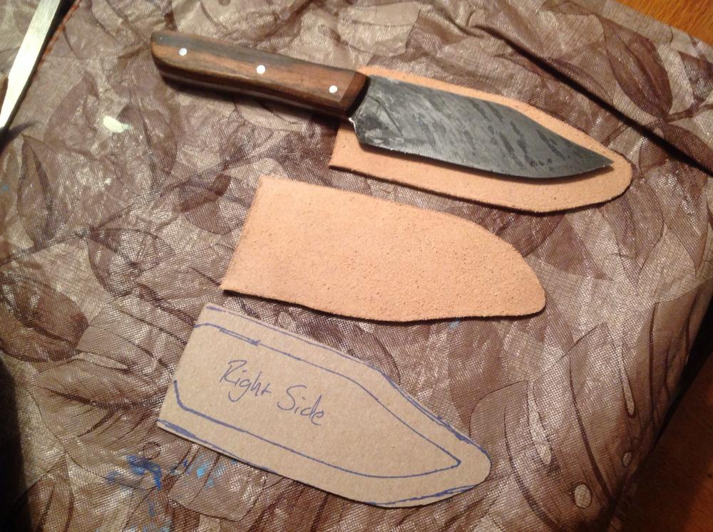

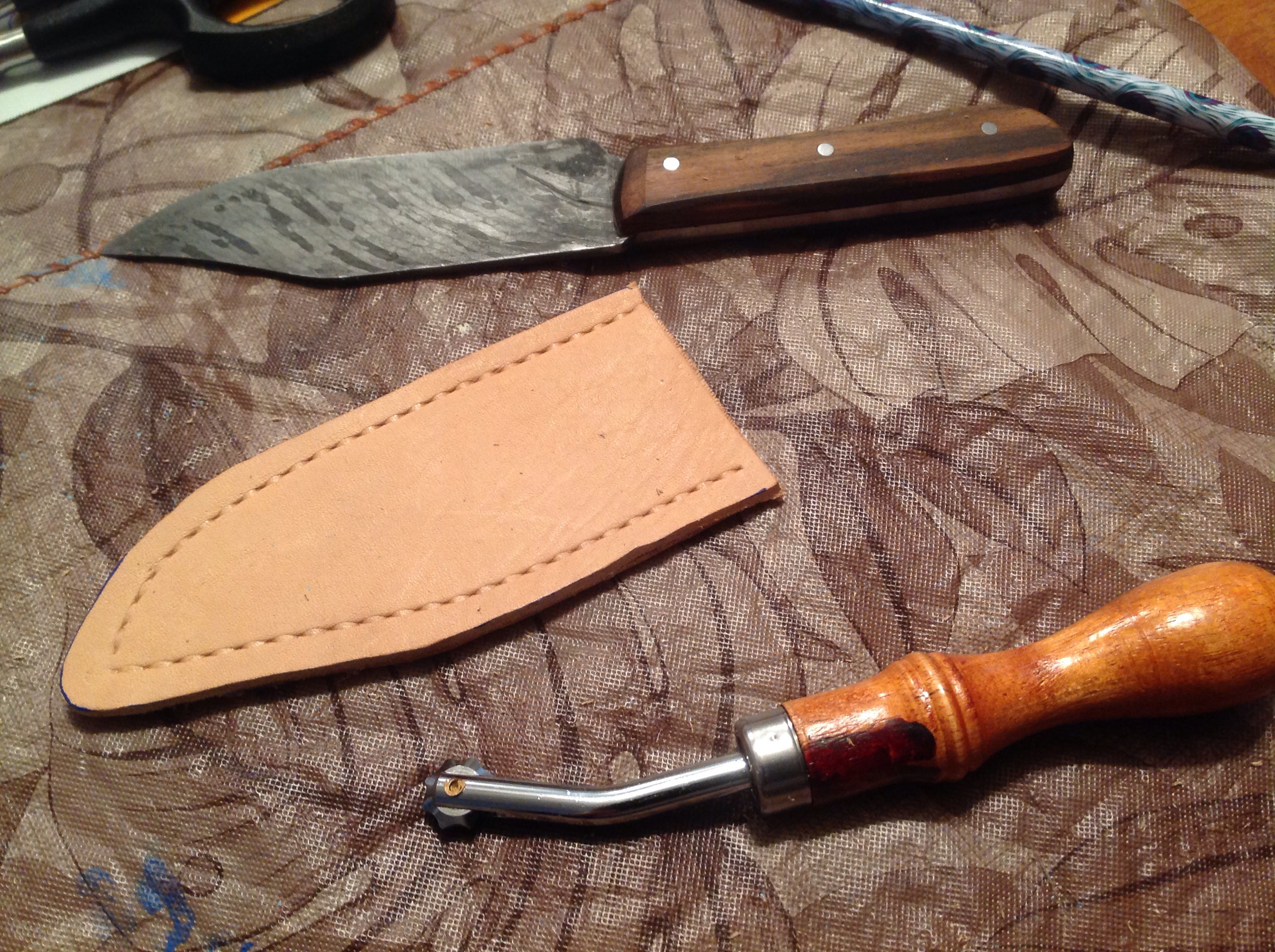

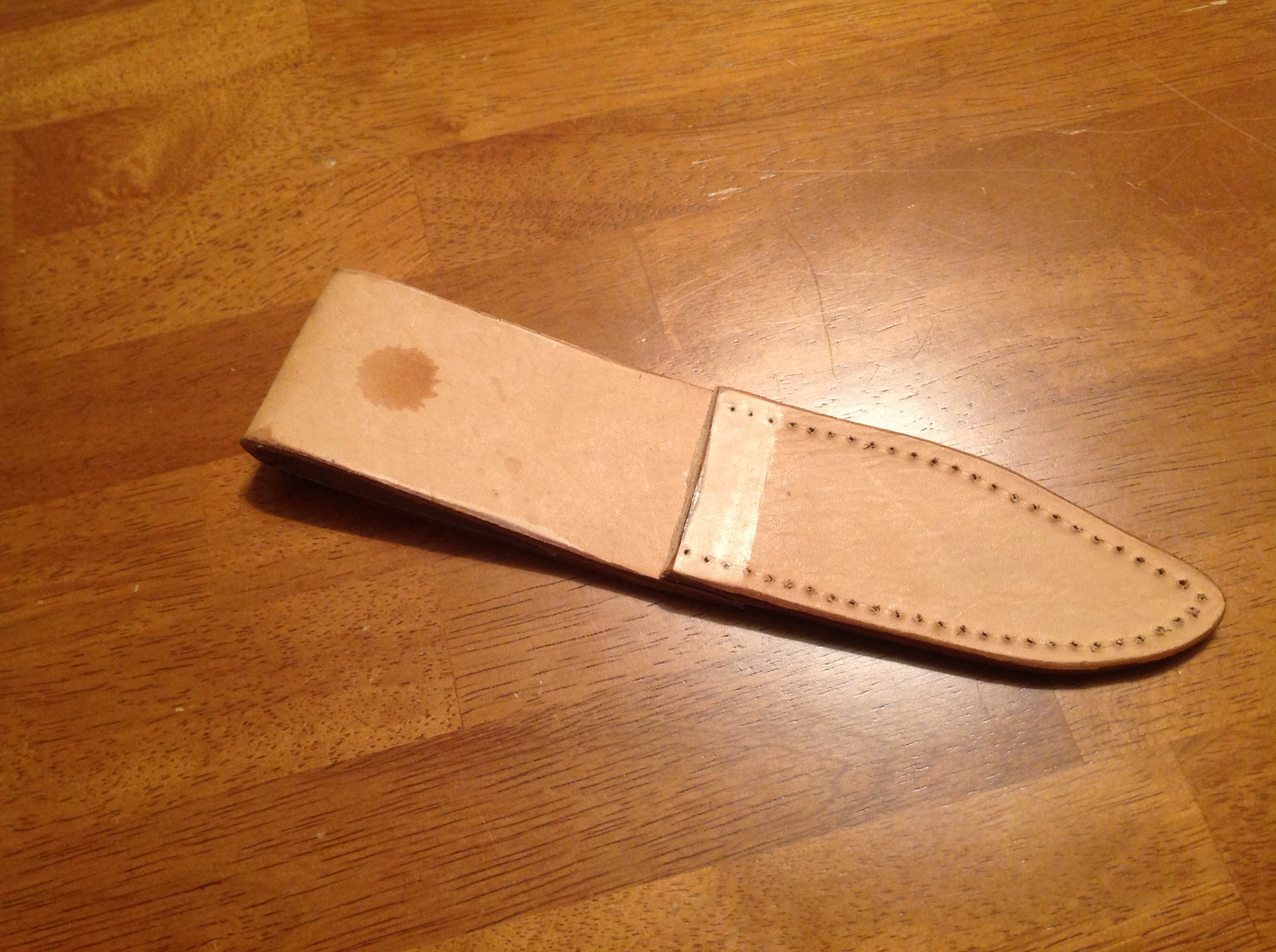

wd&mlteach Posted August 23, 2016 Share Posted August 23, 2016 Awesome job, sewing finished leather by hand can be tough. I love my leather apron -Leather Forever! When hand stitching leather I use an overstitching wheel and an awl to punch through the leather. I place a block of oak behind the leather as not to dull the awl or stab myself or the table. I also use a Speedy Stitcher as it is great! Quote Link to comment Share on other sites More sharing options...

rendoman Posted August 23, 2016 Author Share Posted August 23, 2016 Thank you all for your valuable advice! Thanks wd&mlteach , As soon as it opens the leather shop (unfortunately 12 sept) I will buy this overstitching wheel, It's not easy to follow straight paths on soft skin. Your sheath and knife are really well made! Thanks SLAG , I'm watching the Speedy Stitcher tool, it seems good to use, with wooden handle it can withstand pressure, it seems also serviceable to use, I have to search in local shop! Thanks JHCC, I had thought to put a shelter in the pocket, but with fly ash and grind powder maybe it's better to put inside apron, I need to think about putting side pockets maybe, certainly more sheltered from dust Thanks Charles R. Stevens, I will remember next time to not stitch across in high strain area, only sides. It's the first time I see this strange glovers needle, it seems a reamer with big head. Quote Link to comment Share on other sites More sharing options...
