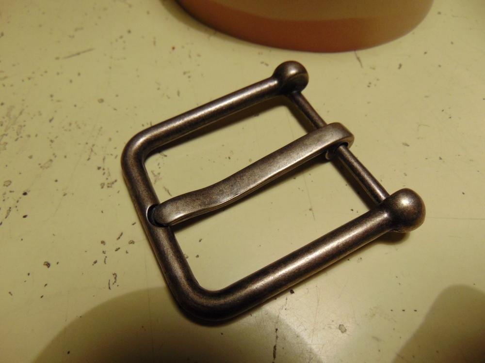

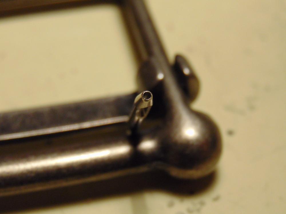

  2. Thanks for the advice! and for the name of the tool, I'm not an expert in english Language, and sometimes I have trouble finding the right tool. I think I will try to build a burnishing tool on my lathe, I got some aluminum and teflon scraps, with a radiused tool maybe I can do a nice job. It's a good idea to make a rigid ribbon in the opening area, I think I will try in the next holster, not only to re-holster than to pull with thumb in order to facilitate the extraction (maybe my holster is too rigid and new) I bought some more leather for a leg bag, with 2x3mm belt (5cm - 2" wide). I'm starting to build the belt, I post some picture I bought also a couple of hollow punch bit, I discovered that mounted on a bench drill they are nice. Size 1mm. Maybe I used wrong glue, normal vinavil pressed with brass plates and transformers. I posted even an aluminum tool found on a forum ( http://leatherworker.net/forum/topic/26604-edge-burnisher-for-dremels/ ) should I replicate something like this right?

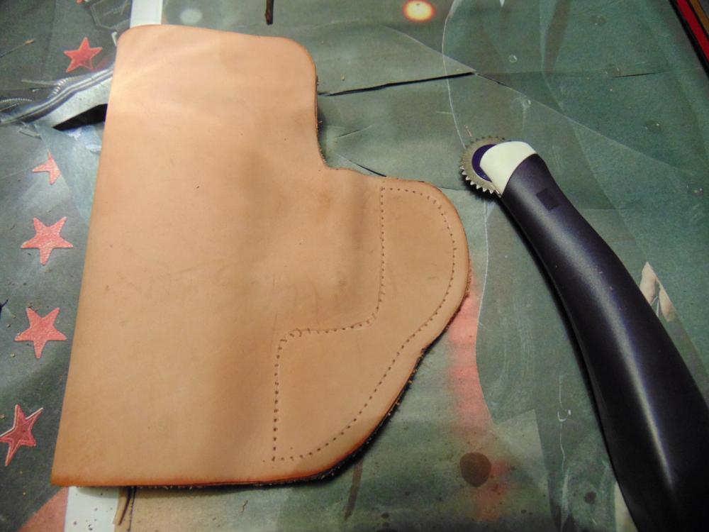

  3. Hi! you're right, 9x21 is close to a clock . In Italy, usual 9x19mm is not permitted, but 9x21mm is fine for civil use, according to law... I finished sewing, I have to find a good hollow punch tool for waxed twine, I used 2mm drill bit, but holes are big, it's not a perfect job Luckily the holster keeps the glock in perfect position, It's needed some strenght to pull out the pistol. I will add a reinforcement in the top area, because 3mm leather is too soft , and trim the contour. I used acetone dark brown dyeing and two hands of white shoe polish. I'm thinking the best way to finish edges

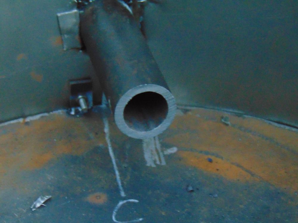

  6. Hi! Noob question: should I put some firebrick on the base and lateral in order to define area? Today I cut a window on lateral side, maybe I should open another one on the other side. I added a front shield, maybe too high. I finished the prehistoric valve, ugly but effective, from 0 to max air. I chose this style because it was easier to make, and above all it keeps a perfect cooling of the fan, not overloading. I will add a front switch to start and stop fan and a "decent" cable Thank you all for your advice!
  7. Your advice are Always welcome! You're right, I made something not correct in design, Tomorrow I will open a side window and cover the front I never imagined that it would take so much coal (4-6") to run this forge, I'm so noob thanks for advice!

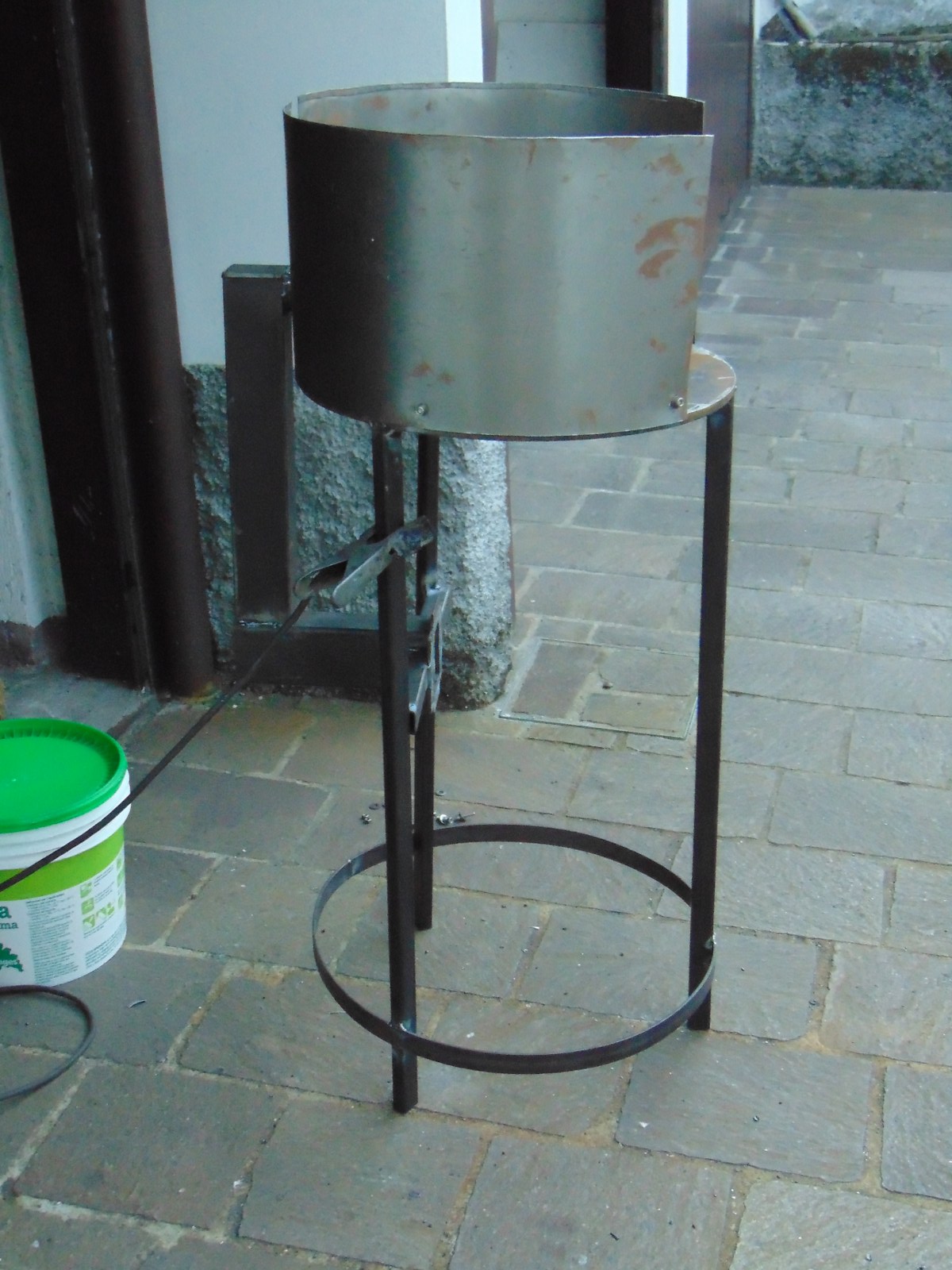

  8. Hi! I built air intake, with slide valve in order to regulate flow. I changed also tube jet I'm thinking about putting a filter at the entry of fan Saluti Stefano
  9. Hi all! Small update, not a perfect job, but at least nice to see I make a small grill in stainless, don't remember if 304 or 316, for sausage and other bbq applications (yes I got no barbecue at home, that's my first!) I found today this fan, it's ok, but I dont know if can be a nice blower, at first sight it has a strong air flow. I'm thinking about a mechanical valve in order to partialize flux, with exhaust... I got an hairdryer as second choice Saluti Stefano
  10. Hi all! Thanks to the advice given by many good members of this forum I decided to try a small side blast forge. I found good metal scrap, a round part thick 1\2", good as base. I did air intake from square tube. A broken hairdryer will be the air source, the tube will be at 3" from base. I built lateral bulkheads from 0,8mm steel, I folded with hammer the edges, not because I wanted to try hammer on anvil, rather because they were sharp. I'm thinking about making them detechable, in order to facilitate cleaning and to use like barbecue I post also my diy custard raspberry and strawberries tart Saluti Stefano

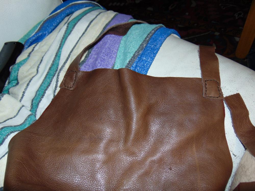

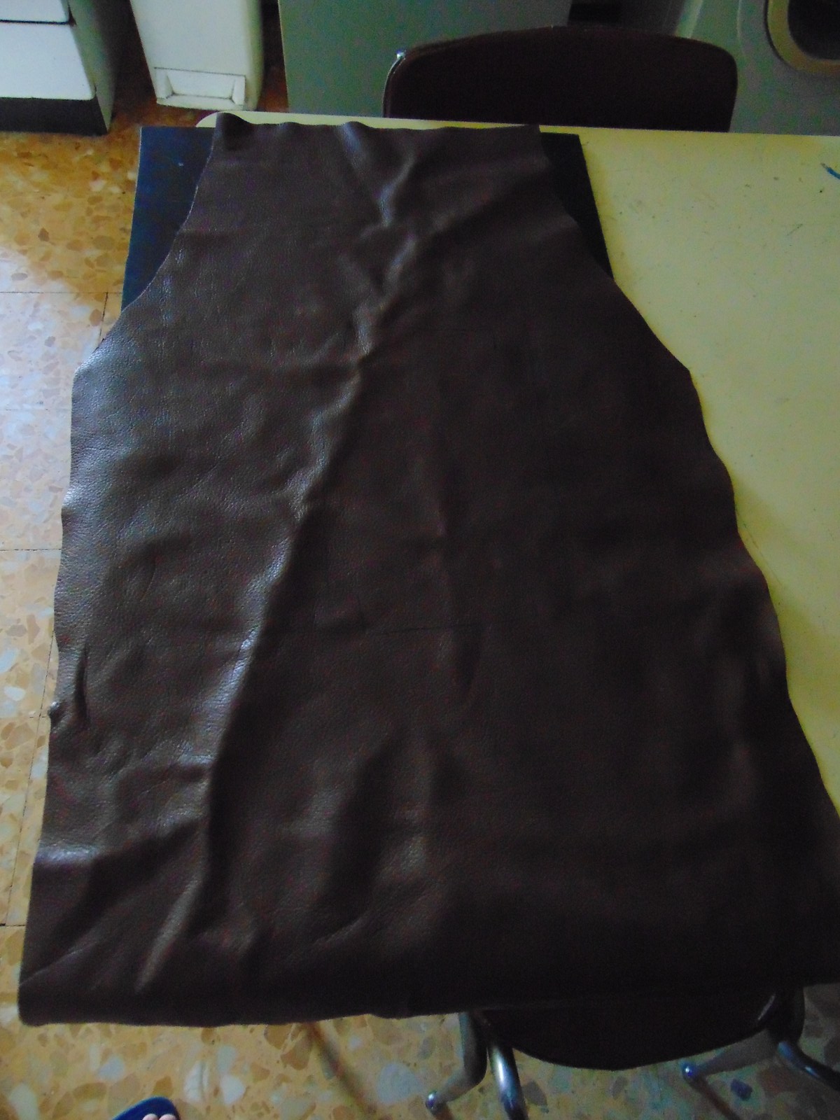

  11. I just finished my first apron, not a nice done job but at least usable. I tried different lenght, I found that knee lenght is better for my use, very long apron is not so practical to use in kneeling position. I decided to follow an advice to avoid pockets in the front, think about it, the molten iron sparks hurt! maybe it's better to not put pockets I post some pictures of finished apron, I got garage in full disorder, please close one eye I Drew a bad paper with some measure, i'm 1,85m x 90kg, maybe can be useful for someone Saluti Stefano
  12. Hi! I tried to do my best with anvil and hammer in order to make some buckles, but it's not easy! Aesthetics aside they are good. I did some mistake with length and belts, that's my first time with a leather vest, without pattern it was a bit hard to take at first sight measures. I finished with "stitching stamp" beacuse I started with this, in next works I will avoid to use. I think I will do something else with leather, but always for "little things", for sure I will buy a stitching tools and the special Needles, they seems to me easier to use I think Tomorrow I will make some pocket and glasss support. Saluti Stefano

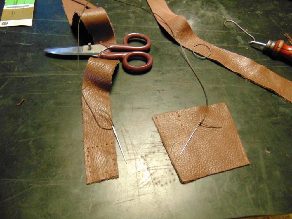

  13. Thank you all for your valuable advice! Thanks wd&mlteach , As soon as it opens the leather shop (unfortunately 12 sept) I will buy this overstitching wheel, It's not easy to follow straight paths on soft skin. Your sheath and knife are really well made! Thanks SLAG , I'm watching the Speedy Stitcher tool, it seems good to use, with wooden handle it can withstand pressure, it seems also serviceable to use, I have to search in local shop! Thanks JHCC, I had thought to put a shelter in the pocket, but with fly ash and grind powder maybe it's better to put inside apron, I need to think about putting side pockets maybe, certainly more sheltered from dust Thanks Charles R. Stevens, I will remember next time to not stitch across in high strain area, only sides. It's the first time I see this strange glovers needle, it seems a reamer with big head.
  14. HI all! I'm building a leather apron in order to preserve my clothes from sparks, welding and forge ( and maybe because I like this kind of clothing ) I Used a beef leather about 2mm thick, hand sewn with waxed twine. I'm not so expericed with Needles, but I'm trying to do my best. I will add some pocket with cover for small object, and a support for protective glasses Saluti Stefano
