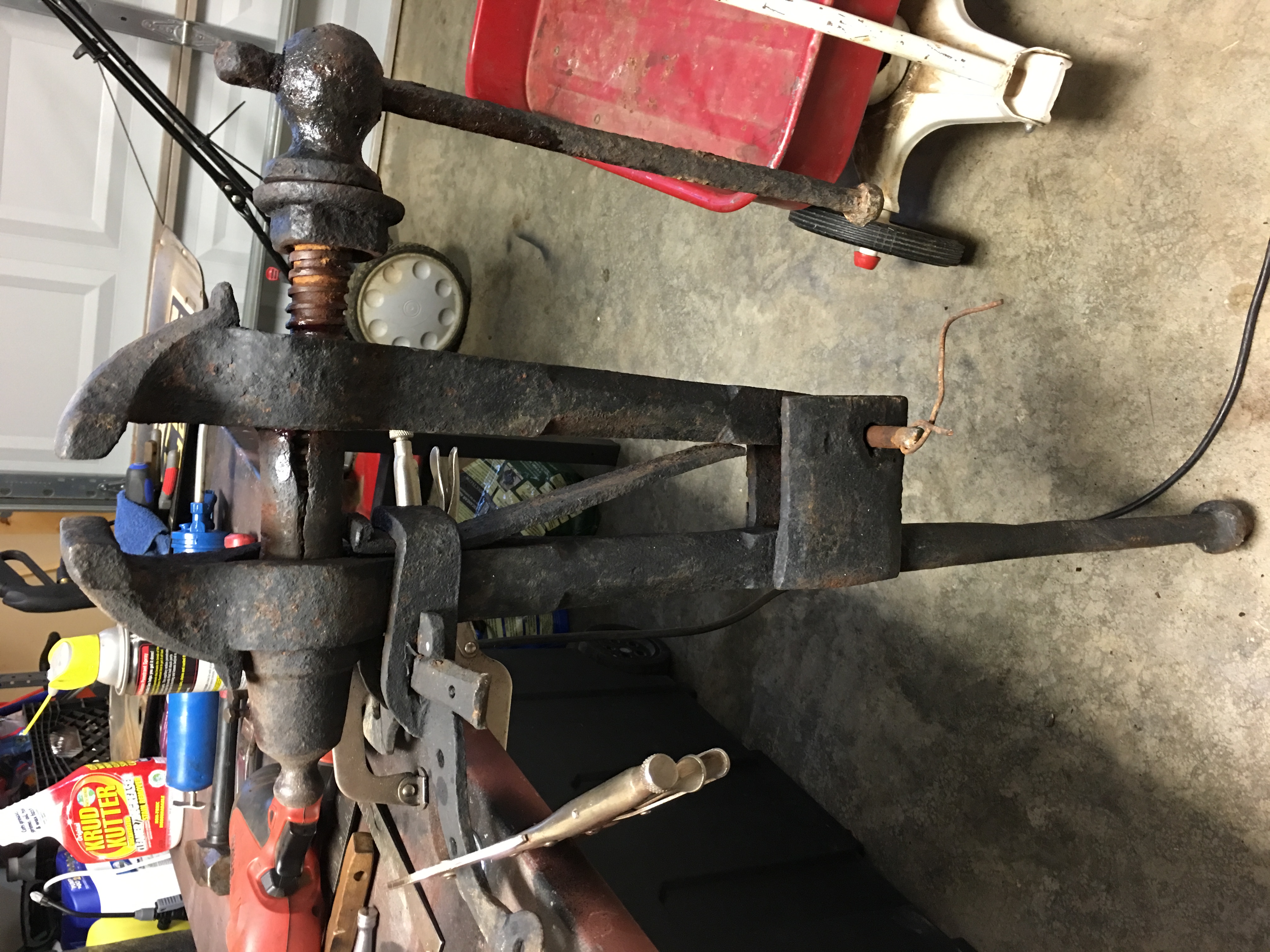

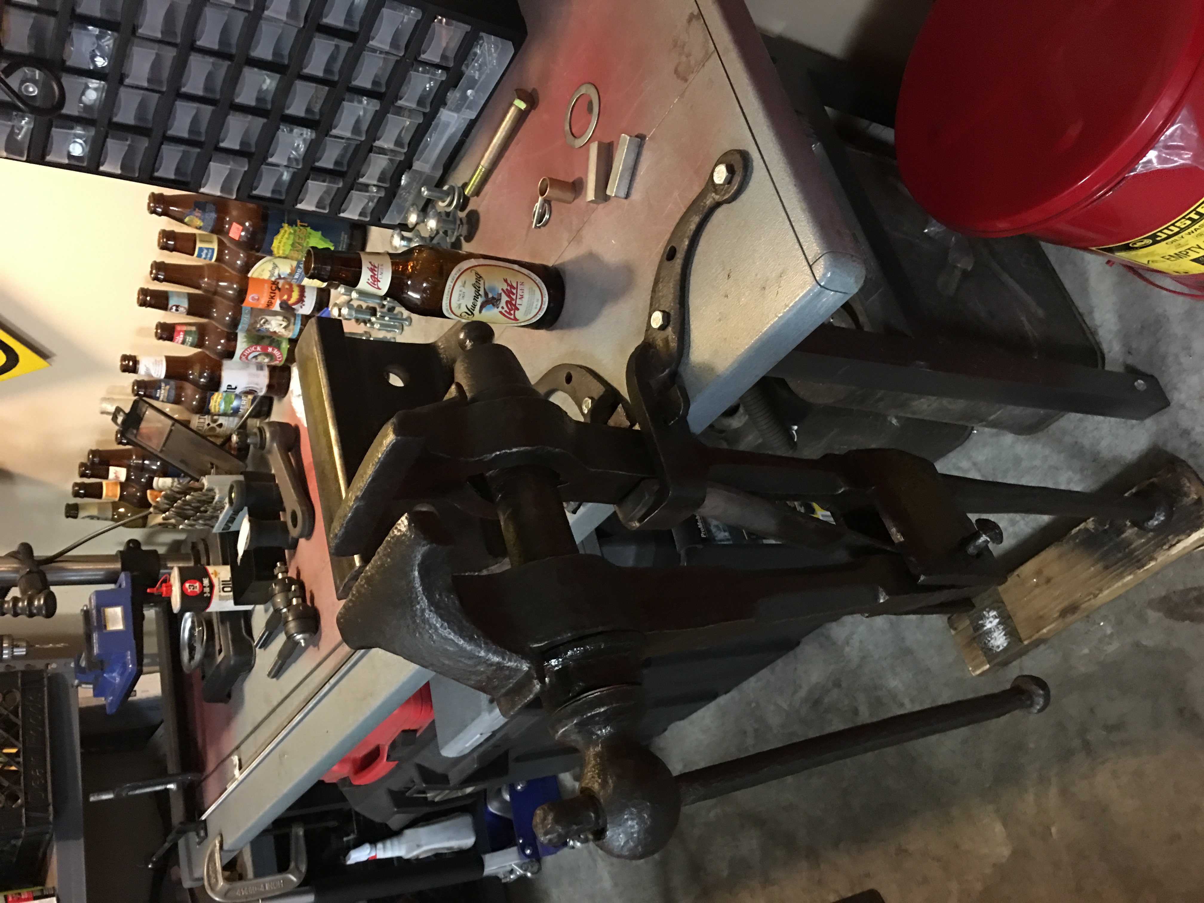

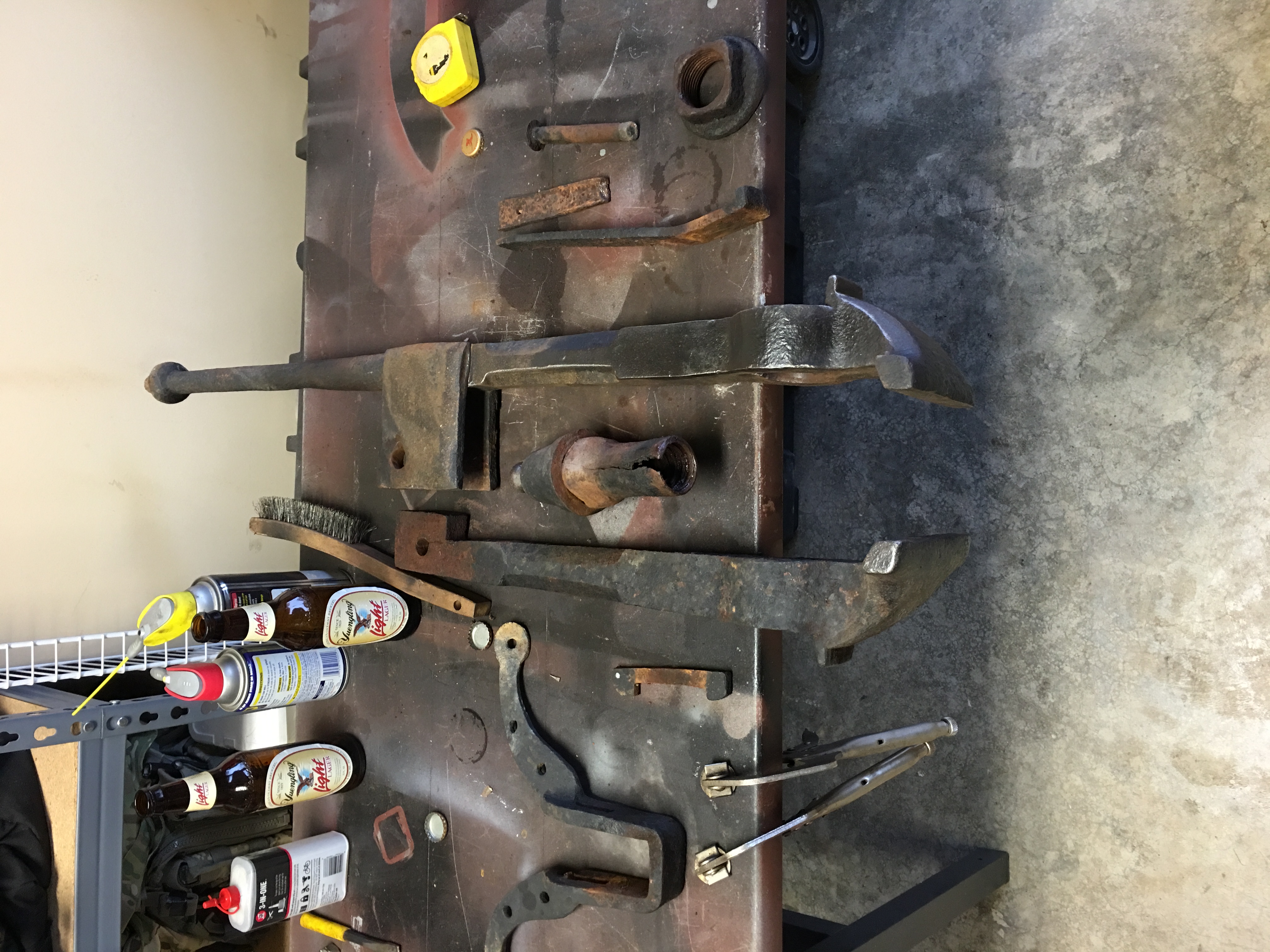

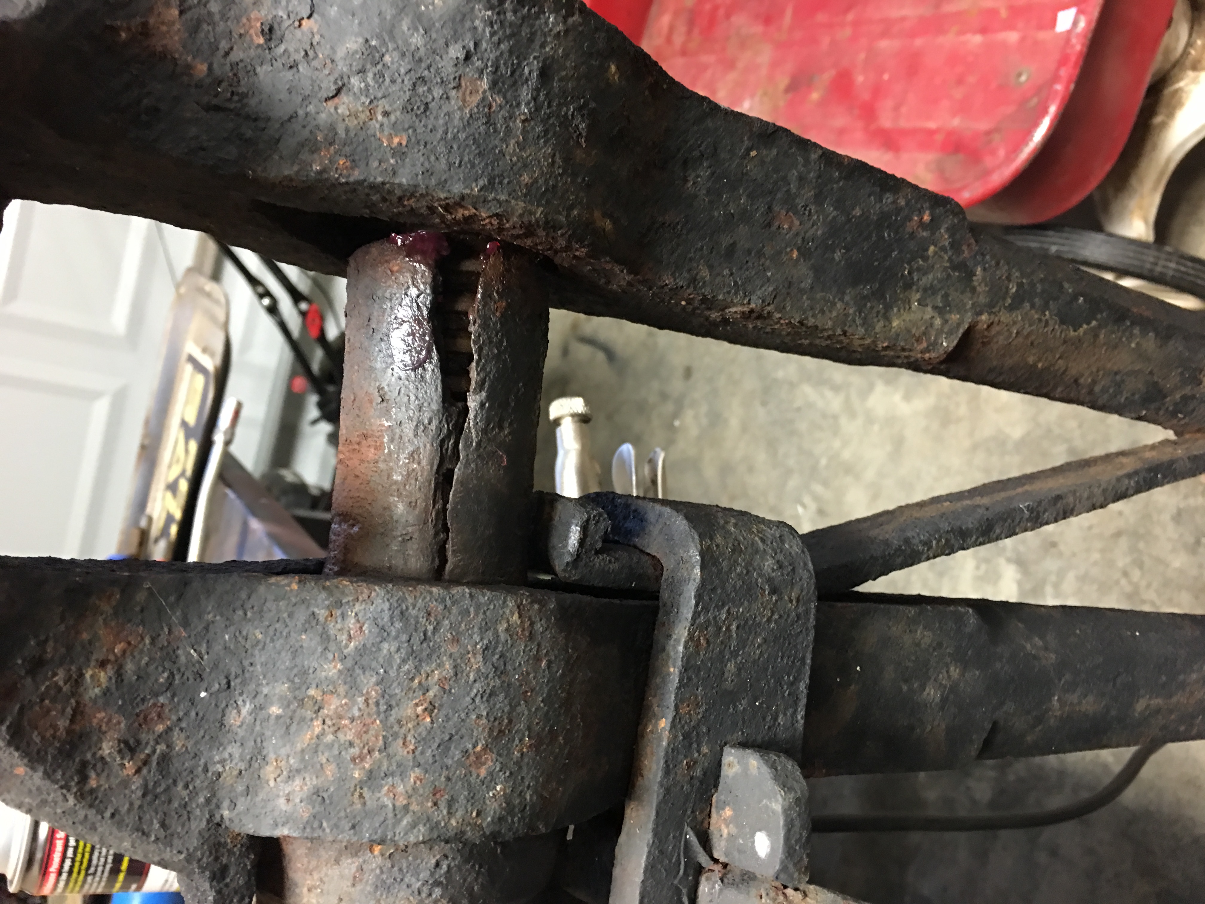

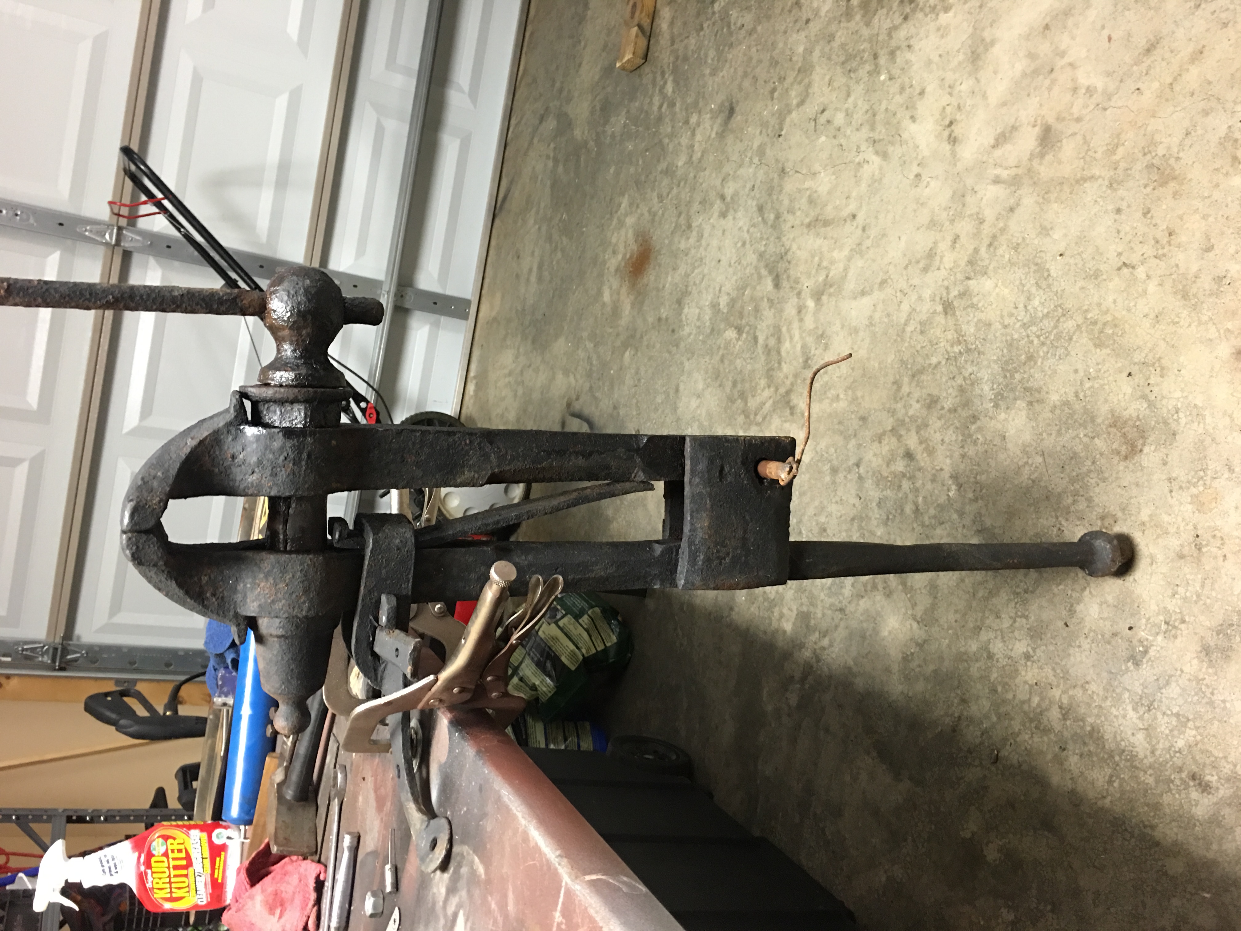

Hi, new user here, love the forum. I have been looking for 6 months and finally found an affordable blacksmith vise. I paid $110 at an auction. Most are 200-300 in my area or $150 if I feel like driving 5 hours to get one. It is rough, but I like it. Today I will be wire wheeling and rubbing with oil. I need to replace the thrust washer since it is a large nut currently. The screwbox is cracked, but still grips the threads. I'm thinking on how to best repair or replace. I'll post pics when I am complete with the cleaning.
You might be able to forge a collar to wrap around the cracked screw box.  You could then tack weld the collar to the screw box so it wouldn't open any more.  It might look like Fido's b*tt, but it might work.  I wouldn't try to weld the box crack.  That piece will take a lot of stress.  Best to see if you can find a replacement somewhere.
The screw box is the split cylindrical part in your first three pictures between the two vise halves.  As in the pics, the large screw simply moves back and forth inside it.  It's one piece.  The thread is usually an Acme-type thread and mates the box, so the ID and OD you mentioned depends on whether you measure the outside or inside of the screw threads.  For the best results, try to find parts from a non-working post vise that will let you use the replacement screw box that will fit your screw.  Putting a tube inside the split screw box won't work with your existing vise screw.  Pretty simple.

Thank you all for the advice. Yeah, these are expensive in most areas. I like the idea of the collar to surround the shaft to prevent spreading. I will take your advice and not weld. I finished wire wheeling and rubbing it with oil, I will post up a picture when completed. Thank you all.

All cleaned up, rubbed with oil, and in its temp home until I make a better bench/stand. I'll update if/when I decide to fix the screwbox or at least reinforce it.
