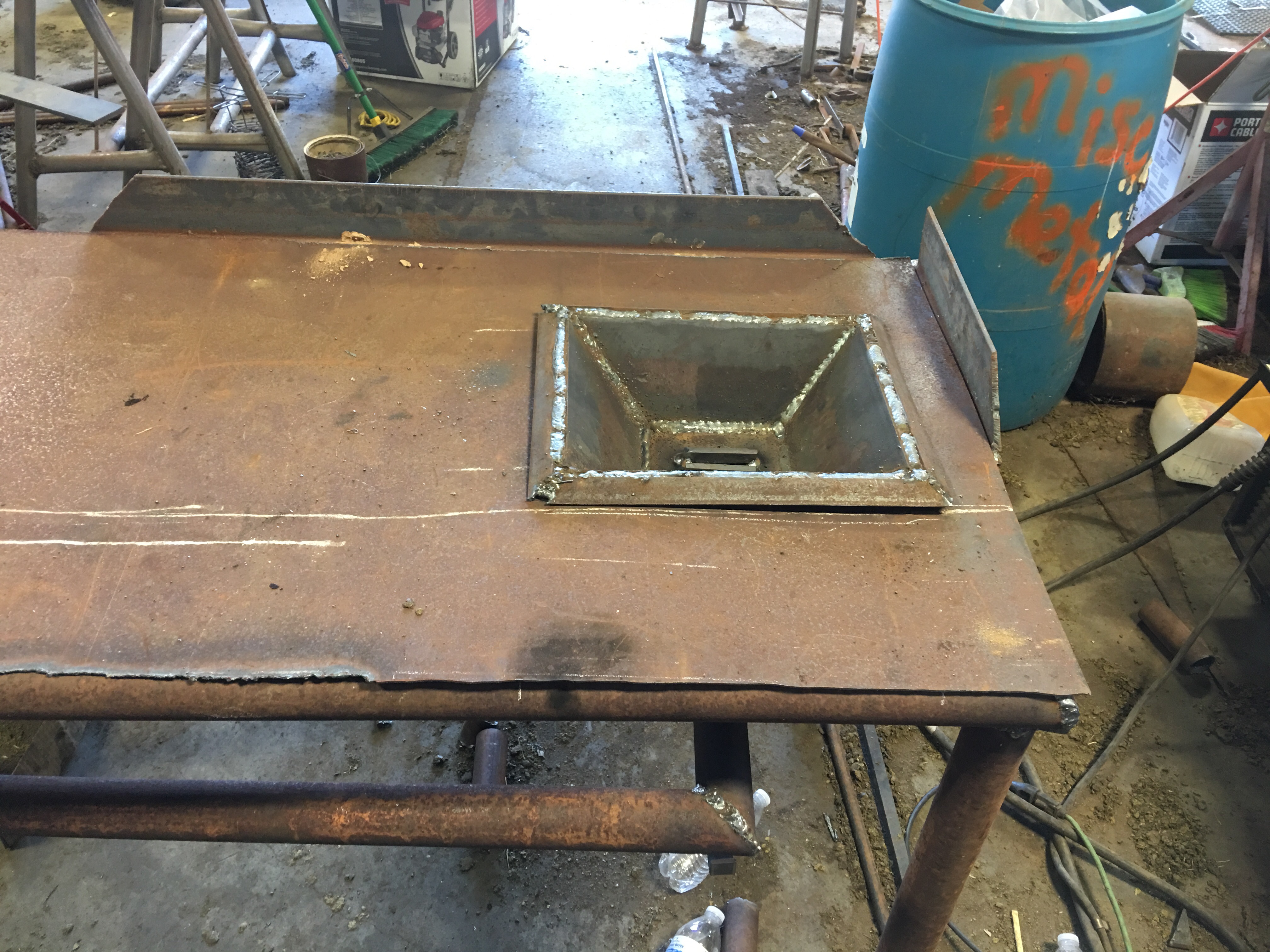

Still needs some work but my new forge is coming along well I think. It isn't as square as I'd like but I think it will work well enough and if it doesn't spouse I can tweak till destruction.
Looks like it's coming along well. How deep is the fire pot? And the table dosnt have to be perfect. It just holds extra fuel. It will help to add edging around it except where you set the workpiece in and on the opposite side it helps to have easily removable edging for when your working longer pieces. Tho you don't need it there, I like having it so when pushing shorter pieces into the fire you're not pushing fuel off the other side.
Square? The fire doesn't care. If you weld a flat rim around the fire pot so it'll drop in the table and rest on the rim you'll find fire pot maintenance much easier. Makes it easier to assemble in the first place too.
Looks good to me.
It's about 4 inches deep and 12 1/2 x 10. Rail around the table and pot just haven't been put on yet.
home stretch, just wish there wasn't a warp around the pot

Pancho: What warped the table top? I stitch welded 3/16" x 1" angle iron to the bottom of the 14ga. table of my large coal forge and it hasn't warped at all. The reinforcing angle stitched under the table would look like a V touching the bottom of the table top. The rim is 2" angle iron flange up to make an elevated rim around the table but it's stitch welded as well. By stitch I mean a 1/2" tack weld every 4"-6" max # of welds. Nothing in the fabricating sunk enough heat into the top to warp it at all. I'll think you'll be a lot farther ahead using something other than that long lever of a piece of pipe for the air supply, vacuum cleaner hose for example.

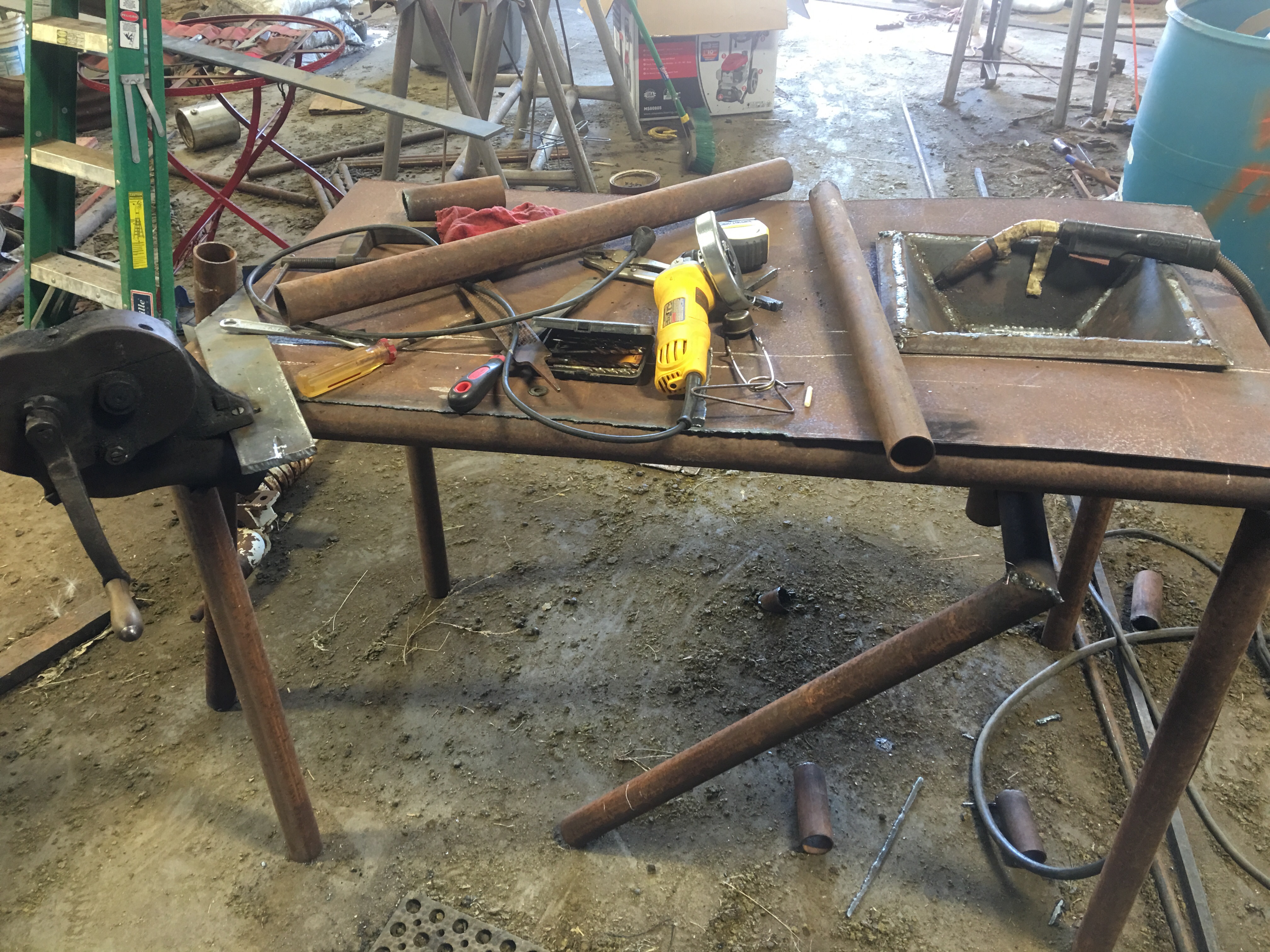

I wasn't thinking when I cut the hole and used oxy acetelyne torch instead of plasma torch or a cutoff wheel. I would agree with the pipe, it probably won't work the best but it's what I had. It can always be changed later.
Well something isn't working right, don't know whether I need a bigger blower or different air pipe but I can't get a fire going in it.
Is it the table top that's warped or the fire pot? If it's the table then get our your hammer and beat that sucker flat again. ;)

That is a possibility, it actually smooths out as it heats up but it's the least of the problems at the moment
If you can, run the pipe straight from your blower to the T. I think that angle is hurting your air. Also are you losing any air out of the ash dump? That should be a tight fit without air loss.
Lastly what coal are you using? Bituminous and anthracite are a little different as far as how much air they require.
All that pipe isn't going to help air flow shorter is better.

i haven't had the chance to try again since I got it "done" but I'm thinking that I don't have enough air pressure. My first thought for a fix is to straighten up the duct. I'm not real sure why but I'm guessing that the horizontal 90• before the vertical 90• is taking away a lot of my air flow. I'm thinking I'll straighten that up first, if that doesn't work then I'll try I stronger fan. Was given a small 12v squirrel cage fan. Won't be hard to run a simple test with that without too many modifications with all the slip fit connections I have. Does anyone have any air supply advice?
