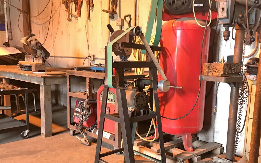

Forrest Betts Posted July 7, 2016 Share Posted July 7, 2016 Made a homemade 2" x 72" belt grinder out of scrap and repurposed parts. Check it out and let me know your thoughts! https://youtu.be/BEi2ruFzGNw Quote Link to comment Share on other sites More sharing options...
Buzzkill Posted July 7, 2016 Share Posted July 7, 2016 Not bad at all, especially since you have minimal money involved. One thing I noticed that you probably will as well with some use is the design of your flat platen. When you're facing it you can easily move pieces around the right side to grind in some tough to get to spots or odd shapes. However on the left side the support structure holding your platen in place prevents you from the same type of access. You might be able to weld some tabs or a couple pieces of horizontal tubing (top and bottom) on the support tube to bring the wheels out further to help, but that will also require moving the platen itself forward to match. Other designs you have probably seen use a piece of flat plate with a portion cut out between the wheels to minimize the issue. Variable speed or step pulleys to give you different belt speed options is also highly desirable, but that's a pretty darn good build on the cheap overall. Quote Link to comment Share on other sites More sharing options...
Forrest Betts Posted July 7, 2016 Author Share Posted July 7, 2016 Thank you! I do plan to add step pulleys in the future.. Just haven't found a broken drill press to steal them out of yet. Hahaha.. I also plan to update the platen with the one sold from Oregon Blade Maker. Click here to see it. But I was kinda trying to see how cheap I could build it first... The only part I HAD to buy was the drive wheel. Everything else was re-purposed junk essentially. Drive wheel was a little less than $50 So that's all I have into it so far. Quote Link to comment Share on other sites More sharing options...

swedgemon Posted March 30, 2017 Share Posted March 30, 2017 I like your design and the minimal $$ investment but you might start saving some money, or watching for, a TEFC (Totally Enclosed Fan Cooled) drive motor. Grinding dust going through an open motor will make for very short motor life. If your compressor runs while you are grinding, the motor on it will also suffer. You will know when your moment has arrived...one of my older motors made a "Ziiittt" noise and died...I also learned to close-up on/off switches...grinding dust gets in and causes another visit to the electrical supply section of Home Depot. Again, great design and best off luck !! Quote Link to comment Share on other sites More sharing options...

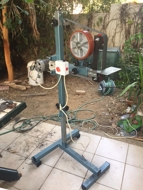

lyuv Posted April 26, 2018 Share Posted April 26, 2018 9 hours ago, Nivsknives said: I was going to clamp mine to the bench but mite do something similar to yours. Kudos If you want a free standing machine, you may want to consider an adjustable hight design like this one. It gives you the option to work standing or sitting. I found that with long grinding sessions, sitting is much easier on the legs and the back. The single leg is less rigid than a "table" costraction, but it's not an actual problem, and it depends on the thickness of the material you use. Quote Link to comment Share on other sites More sharing options...
Gavj75 Posted April 26, 2018 Share Posted April 26, 2018 The idea of being able to sit or stand is definitely appealing. I've got some stuff to consider now before I start clagging steel together so thanx for the input Quote Link to comment Share on other sites More sharing options...
