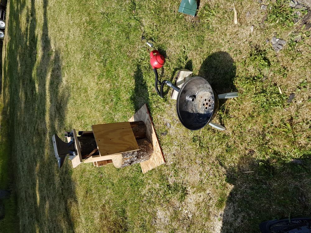

I havent done a lot to be able to tell if its too soft or not. All ive really done is hammer on a railroad spike and i did a little scroll with 1/4 round stock.
Right now im using a small bbq with a pipe coming in the side for air. My fuel is charcoal from home depot. Seems to work alright, but again i wouldnt really know lol. I do have a section of RR track and was going to mount that but found that anvil and mounted it instead.
RR rail makes a fine anvil if you mount it on end it makes an excellent anvil. Same thing as an axle, ask around heavy truck repair shops trucks break axles. Trucks are filled with good steel but till you have some experience it's best to use known stock, buy a stick from the steel yard. You can buy a 21' stick at a steel yard for about as much as a 3' piece at Home Depot. 3/8" sq. is a good size to learn with, it's light enough to get plenty done before you start to loose your arm (get tired) and it's heavy enough mistakes don't happen too quickly to correct.
If you give your anvil a little stroke with the point your pocket knife blade you'll know what too soft is. Unless your knife skates without leaving a mark, then take a file to it for a light stroke, if a file skates you have a gem. I'll bet your pocket knife marks it though.
Your forge is fine. If you ram some damp sandy clay in and scoop out a trench maybe 4" deep and maybe 6" wide with one end open to the side of the forge. Then lay your pipe in the open end and fill it in with soil so it's held about an inch off the bottom. Now you have a proper charcoal trench forge. Easy peasy.
Briquettes aren't the best forge fuel too many additives, mostly the limestone to make it white when it's lit. The lumps being too big and hard is easy to fix, just break it up to say peanut size. It WILL work but it's not great. Lump charcoal works much better, MUCH. You still want to break up big pieces walnut size is good. Smaller size increases surface area so it burns hotter and consumes all the oxy for a HOT fire that won't scale and burn your work. Steel will burn if it's hot enough and there is free oxygen present.
You already have a pretty good start, a little polish and you're off and running. What are you using for a hammer? Don't get something heavy, 32oz drill hammer is my recommendation, heavy enough to be effective but not so heavy it's hard to control and tires you out. The shorter handle is another plus for control. I've had at least one on my hammer rack as long as I've been smithing. Excellent starter hammers.

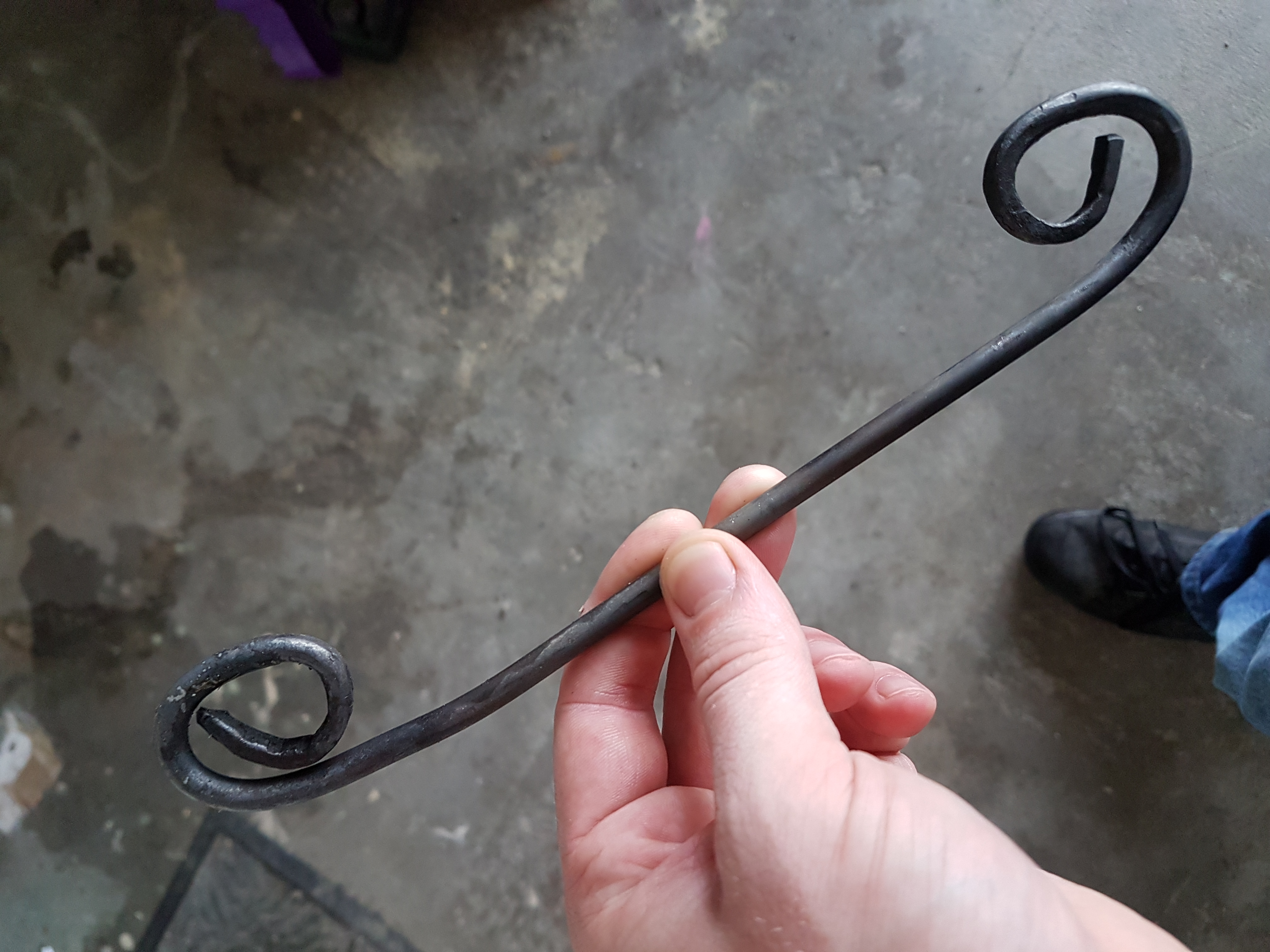

My setup right now and my first try at scrolls
My setup right now and my first try at scrolls. I dont have any of the hammers yet. Ill have some pics soon hopefully

That's WAY too much blower. If that's what you were using as a bottom blast part of the heat problem is it's being blown right out of the fire. A blow drier is more than enough air for most general forging in a small forge.
Another air source is a mattress inflater blower, I've had a Coleman InflateAll /HO, it's 12v and delivers WAY more air than necessary for a pretty darned large fire. Heck I'm using it now to burn brush. I pick them up at yard, garage, etc. sales usually for a buck or included in bundle. New in the sporting good section of big box stores they run $15-$20 up here. They also come in 120v.
Anyway, if you find a 12v inflatall you can pack your forge to the beach and test the found coal before you pack a few hundred lbs. home. I'd do that at Castle Mtn. but I'm not building a fire IN a coal mine, I don't want to be THAT GUY.
