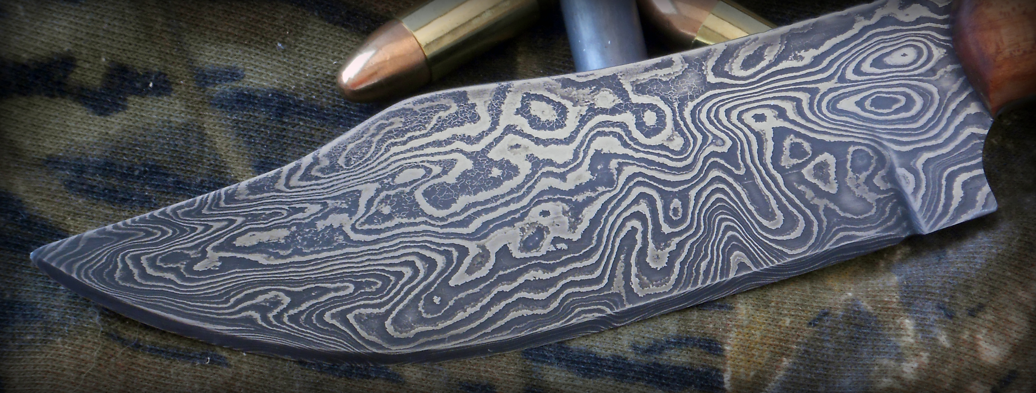

HEAP of JEEP Posted June 6, 2016 Share Posted June 6, 2016 I'm no expert, but can show some pictures of different layer counts I've done that might help you decide how far you want to take it. This was my attempt at a dog star pattern with 178 layers This was 176 layers too, but I forged the final knife on is side to show all the straight layers. This one was 280 layers with two twists after the final two folds. And this one was one of my earliest ones with 72 layers and just a random pattern. All of them were done by hand, no press or power hammer, and they were all done with either 1080 & 15n20 or 5160 &15n20. I'm still trying to figure it all out myself, but maybe these pics will give you some ideas of where you want to go. Quote Link to comment Share on other sites More sharing options...

Gijotoole Posted June 11, 2016 Author Share Posted June 11, 2016 I decided to make it easy - 28 layers with (so far) good welds. Here is what I hammered out today. Lessons: 1. keep metal hot and close to if not at welding temp to prevent delaminating at the edges. 2. Ensure the tip is curved hard down to the cutting edge before forging to make sure it reaches knife shape after hammering the bevel. 3. Don't breathe borax. Quote Link to comment Share on other sites More sharing options...
HEAP of JEEP Posted June 11, 2016 Share Posted June 11, 2016 Another lesson to keep in mind... when forging knifes out of damascus, it will show more layers if you grind the bevels, rather than forge them. I learned that lesson the hard way. Quote Link to comment Share on other sites More sharing options...
Gijotoole Posted June 11, 2016 Author Share Posted June 11, 2016 Good point. I have PLENTY of grinding to do. The edge is almost 1/8" thick, so there's room for waves. It's normalizing in the forge right now and I have 24hr duty tomorrow so I'll have to wait until Sunday to start grinding. After another round of normalizing, of course. Quote Link to comment Share on other sites More sharing options...
HEAP of JEEP Posted June 11, 2016 Share Posted June 11, 2016 Make sure you normalize after grinding, before you heat treat. Grinding can add a lot of stresses to the steel. Are you aware that normalizing is a heat treatment? Quote Link to comment Share on other sites More sharing options...

Gijotoole Posted June 17, 2016 Author Share Posted June 17, 2016 GYAAHHH! I have a big flux inclusion right in the middle of the blade. It's under a nickel layer so it's not that thick, but I'm not sure how to get rid of it without grinding through it. Any advice? Quote Link to comment Share on other sites More sharing options...
Frosty Posted June 17, 2016 Share Posted June 17, 2016 Flux is water soluble, expose it with a drill or sharp chisel and dissolve it out in boiling water. By expose I mean just a nick or two so the water can get at the flux. Frosty The Lucky. Quote Link to comment Share on other sites More sharing options...
