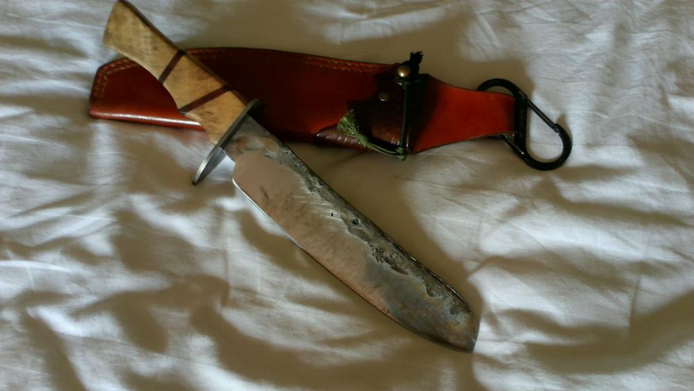

  5. Well I brought my pattern-welded knife with me to Cambodia and decided to give it a test run - it fell apart. I'm not even sad about it; it was an excellent test of real-world use and it failed. I'll have to get better at it, I guess. On the other hand, the other knife I made from 5160 has been a beast and hasn't shown any real signs of wear other than a patina from use on the bamboo and hardwoods. The local people here really dig the fact that "this American dude makes knives". Thanks for the help, everybody.

  16. its all good carbon steel. I checked it when it came in. Some of it is a bit oily and greasy - I'll just burn it off - but almost all of it is brand new.

  19. GYAAHHH! I have a big flux inclusion right in the middle of the blade. It's under a nickel layer so it's not that thick, but I'm not sure how to get rid of it without grinding through it. Any advice?

  23. I decided to make it easy - 28 layers with (so far) good welds. Here is what I hammered out today. Lessons: 1. keep metal hot and close to if not at welding temp to prevent delaminating at the edges. 2. Ensure the tip is curved hard down to the cutting edge before forging to make sure it reaches knife shape after hammering the bevel. 3. Don't breathe borax.
