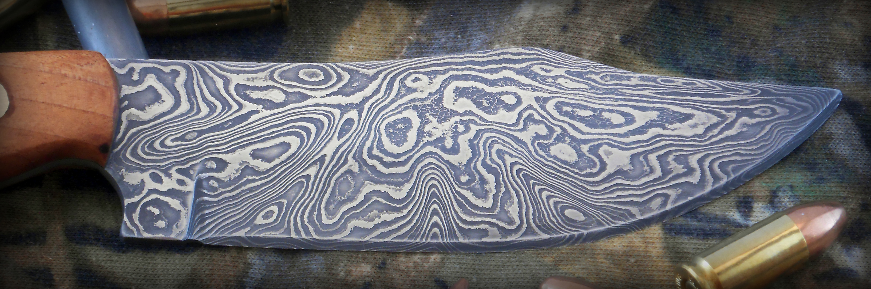

First attemp at a dog star pattern
Finished this one up today. First attempt at a dog start pattern. Don't think I quite nailed it, but do love how much movement the pattern has. 1080 & 15n20, maple handles. Screwed up on peening the pins too.  Don't know what I did to make a couple of them come out so wonky.  Guess it really doesn't matter on this one.  It was a commission job and the customer loves it, so no biggie, but wish I knew what I did so I don't repeat it in the future.

A steel punch and a ball pein hammer can neatly smoosh the rivet end, next time. Also the void area around the rivet can be hidden (partially/) by mixing a light colored epoxy resin together with maple sawdust resin. The mixture is then worked into the void and allowed to set.    I hope that helps.

did you anneal the pins before you used them? Also did you slightly countersink the pin hole before you placed them? The annealing will allow for a "smoother" pein over with less breaking/splitting/chipping and the counter sink will give some "room" for the brass to "move into" thereby making for a bit more of a secure grip on things...
hope this helps..

Going back over my steps, and I would bet money that I didn't countersink the holes.  That could explain it. I always do, but on this one, I think I blew right past that step.
Never tried annealing the brass.  Didn't even know it could be done.  What temperature does it need to be taken up to?  I just use my forge for HT, normalizing, and annealing, and have gotten pretty good with the steels I use, but not sure how I would tell the temp on a piece of brass, being nonmagnetic already.  Ill have to look in to it and play around a little bit.
