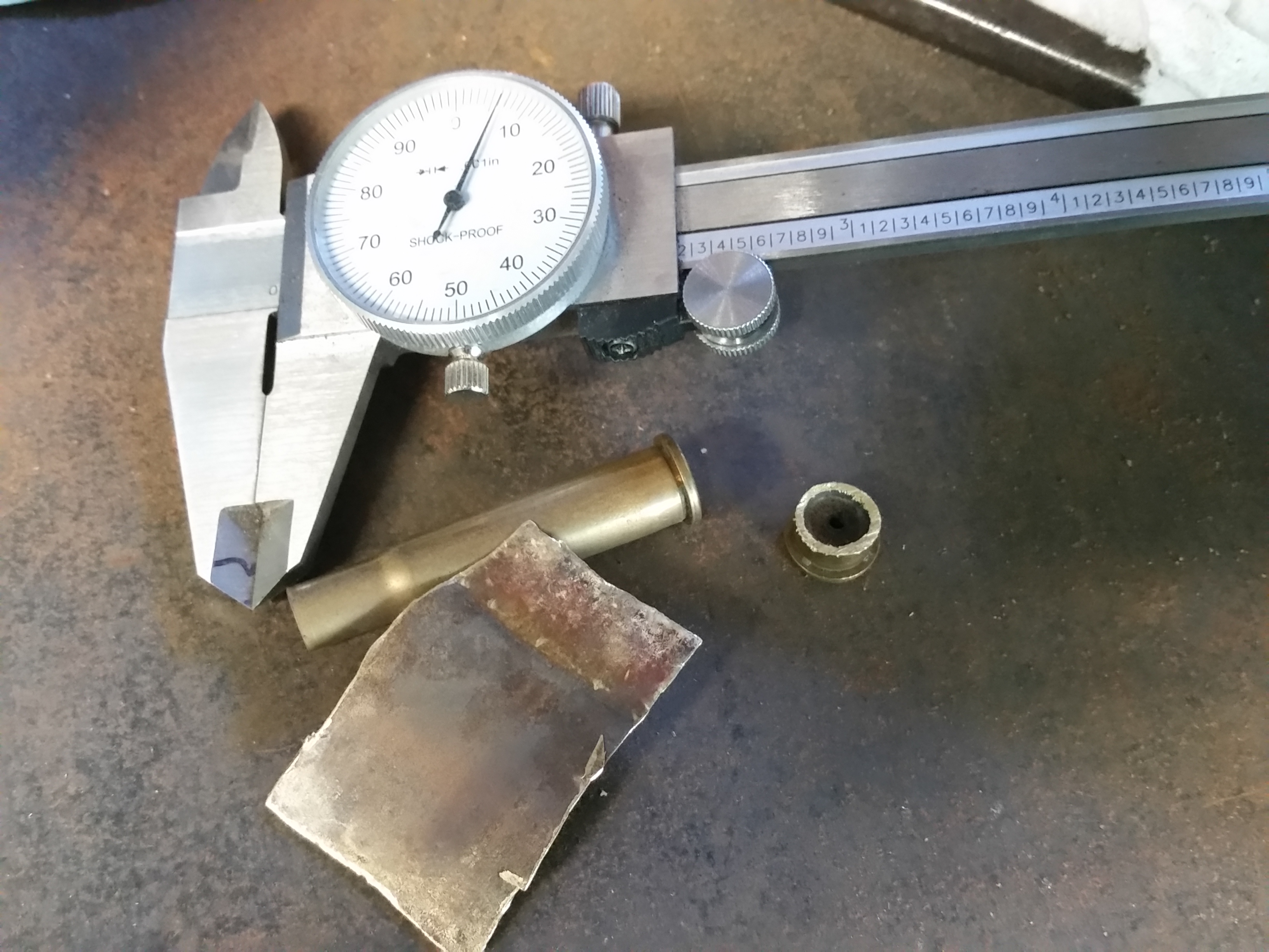

OK now, in my opinion, the first fix is in:
On the Win 30-30, right out of the gate, split open and crudely flattened, we have  ~.005"  thickness at the mouth and tapering up to  ~.030 at the base. VERY PLEASANTLY SPRINGY. Indeed one can make one's own music not unlike what ones gets from an Israelite Harp.
I would imagine that that sound generated by the plectrum itself would feed back nicely from the soundbox of an acoustic.
PM a mailing address if anyone wants some. My 30-30 has become quite expensive to fire, but I have plenty of found NATO brass with a nice desert patina.

Cool I'll check into that site. Expensive from what i saw. Anyway, the size like I said, they put on their picks ".005" Not sure what that means. .005 Mil? Maybe who knows.  I have to get a measurement tool& size the one I have  to see if they mean ".005 mil" I have no idea what size the pick is for sure, the company said they can't give that information out.  Turning into a major project just a simple guitar pick
Hey thanks, It would be great to get some of these picks pressed, I saw that site u mentioned. was 95$ for big roll of .005 mil. Now if that's the same material & thickness of mine I'd be happy. I should ask them for a scrap sample & match it to what I have to verify.  Not sure if they'll do that but I'll try. We should start a copper pick company up haha. Not sure if there is demand for them tho. Might only be  a handful of people who would want them. There are other companies already out doing the copper & metal pick thing. but they lack the variety of sizes
You are mixing terms. .001" = 1 mil, .005" = 5 mils, not .005 mils. .005 mils is five hundred millionths of an inch.
You want five thousandths of an inch.

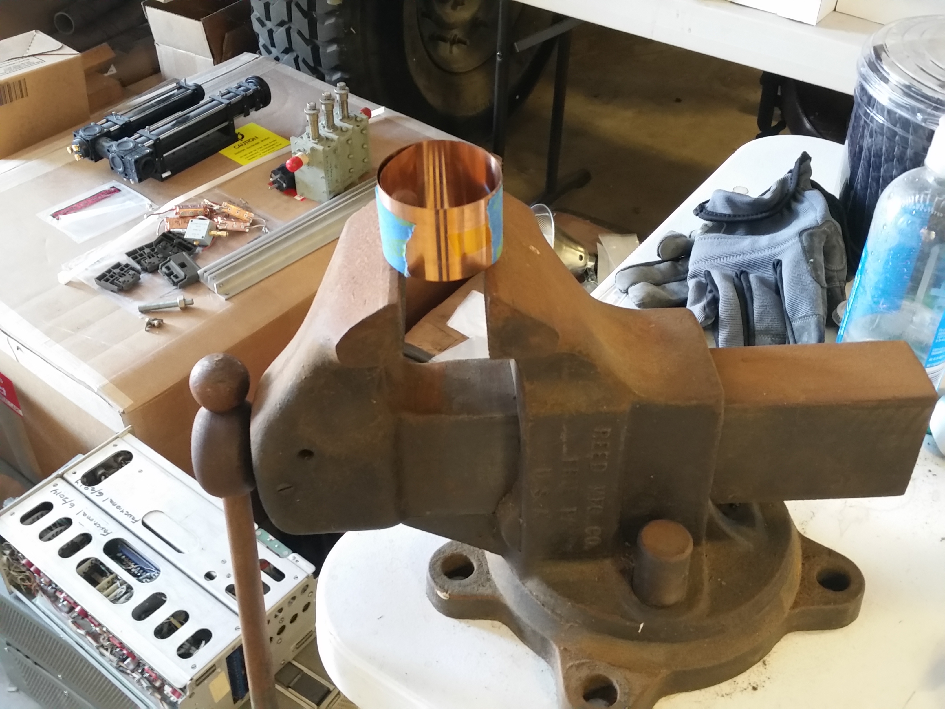

OK, this is the real deal. I was told that one of my brothers was selling this for five dollars per inch, but not sure. This is bonified spring tempered copper, .007" thick.
When you find exactly what you are looking for, it is going to be expensive. My brother up here in Goleta will try to source it for us if can find the spare time.
If you are going to lay out the coin, be sure you are getting "sping tempered".
You'd best get busy smashing pennies in the meantime.
