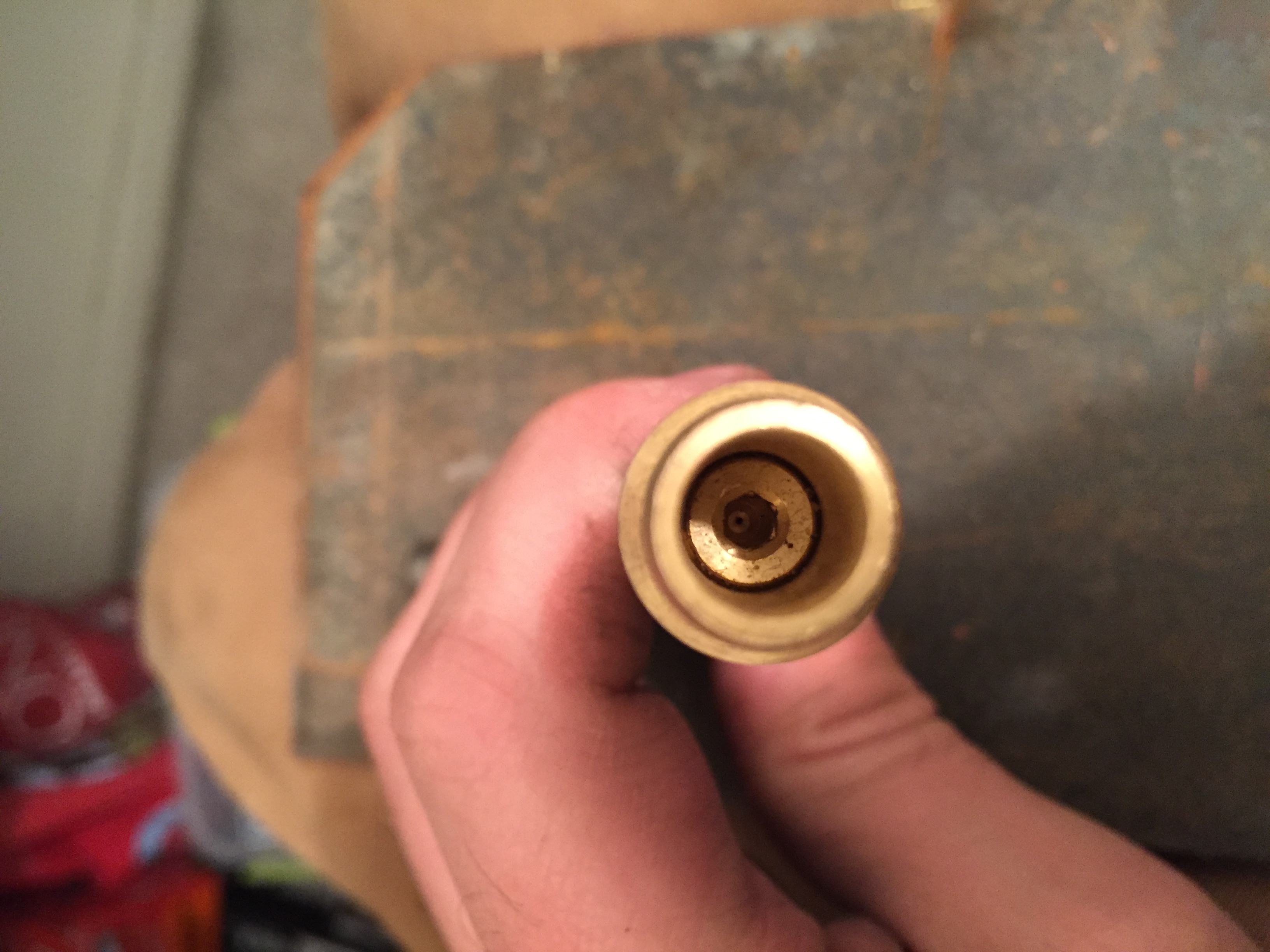

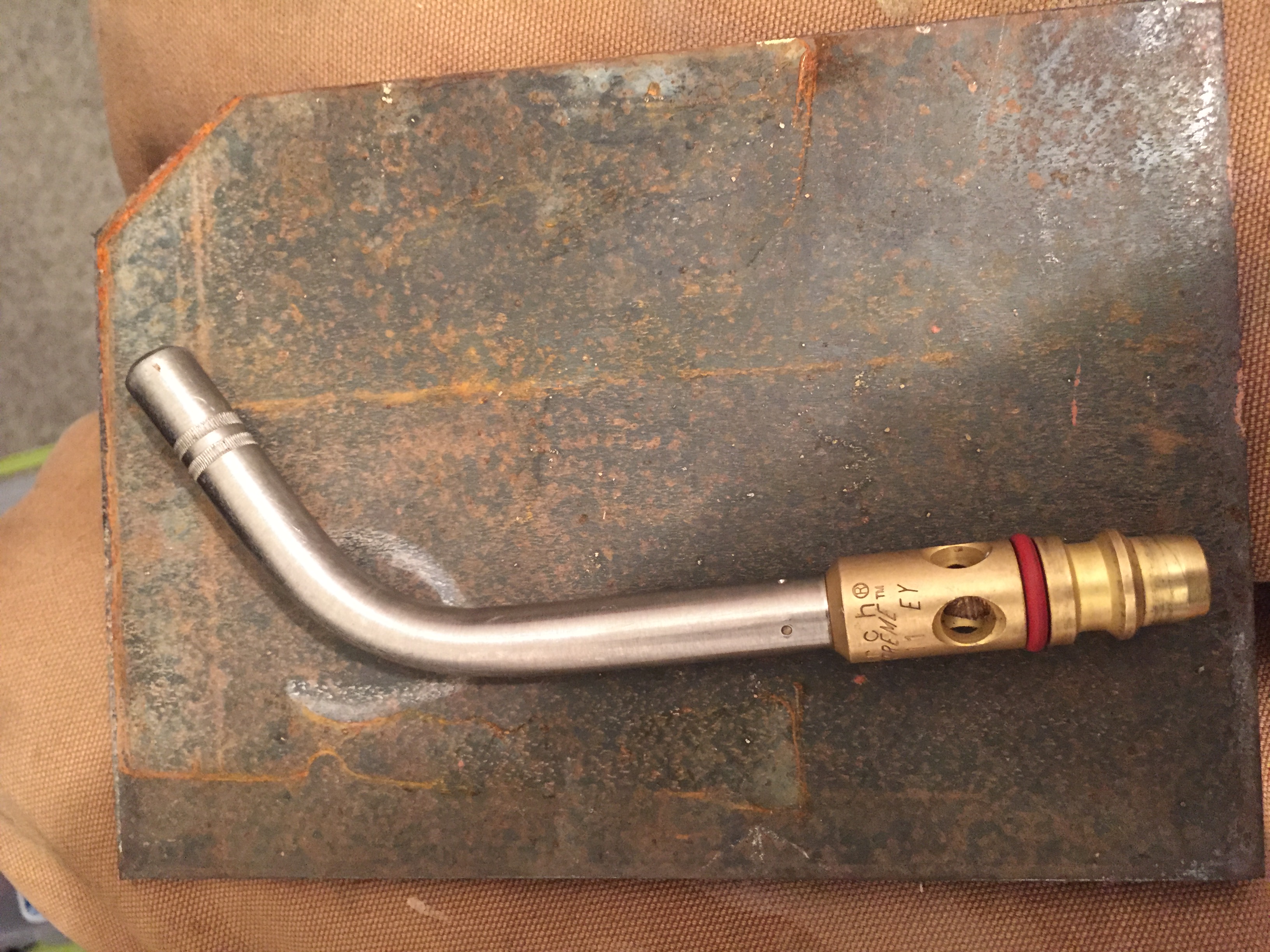

So far, everything is turning out great. I have not tested this design yet, but plan to do so soon. I started off by taking a close look at my TurboTorch tips that I use at work (Acetylene gas).
IMG_0679.thumb.JPG.35a23ec07cf7f98972252
Here's a picture of the TurboTorch tip (A11).
I too extra notes on the brass section of the torch tip, where the gas begins to mix with air. The gas flows from the regulator into a small chamber, with a very tiny hole machined in it. This little hole sits just before the air intake, which is proportional to the overall diameter of the tip size. I know this because other air intake holes on smaller and larger TurboTorch tips that I have increase and decrease based on tip size (A5 vs A11 for example).
IMG_0680.thumb.JPG.dfd9c7340a96baaa332d3
Here's a picture of the air-intake holes.
IMG_0681.thumb.JPG.57da4ad0b9b984664f9ce
Here's a somewhat poor picture of the little hole inside the tip I'm talking about.
