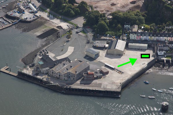

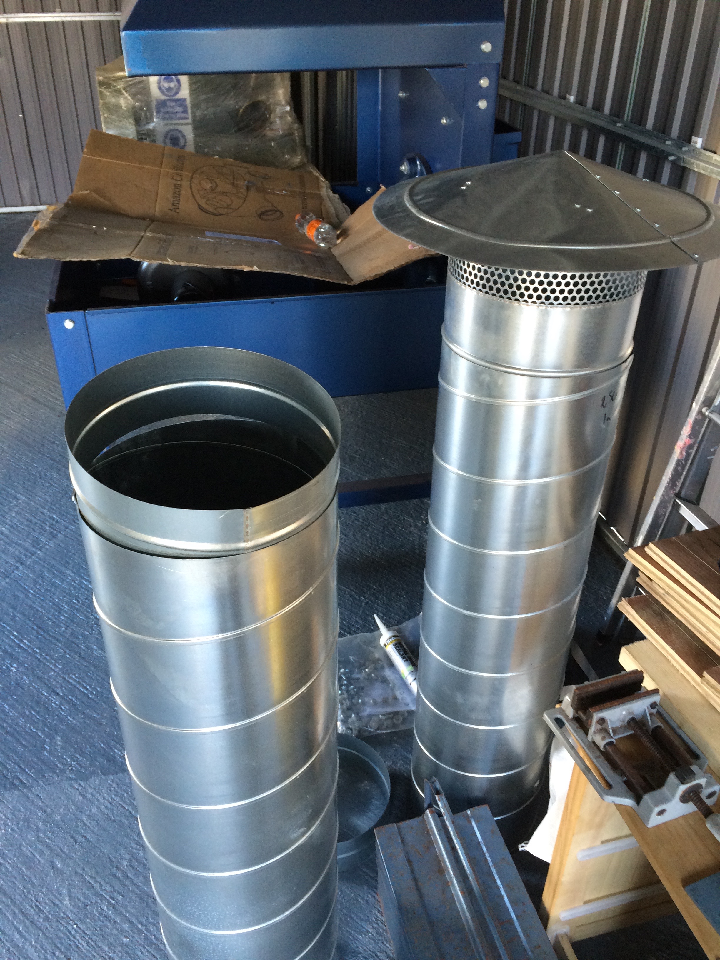

blackleafforge Posted April 23, 2016 Share Posted April 23, 2016 Hi! About 3 years ago I quit my job with the intention of working full time as a Blacksmith and turning my hobby in to a career. I spent a year studying at the Blacksmith college in Hereford then started setting up a shop while working part time to pay the bills. As I have progressed I realise how little I know and as mistakes crop up constantly and prove very expensive both in terms of time and money. I was hoping If I go through my set up so far someone might spot something I’m doing wrong or could do better and give me some tips. Thanks Andy The shed is just over 7 meters long and just under 4 wide, made of a very flimsy corrugated tin wrapped around a frame ( I have already bent it a few times by leaning on it or banging on it with something). Its built in a former military base, you can see how close the houses are, I am slightly concerned I may have a few complaints when I start churning out smoke and using the power hammer. I have the power hammer installed but am still trying to get the VFD to work properly ( I only have access to single phase). I am also trying to install the chimney at the moment, I went through a long design stage trying to work out ways to brace it to the shed so it won't blow over but after doing a trial run I have now decided that its strong enough as it will be seated in the forge hood and braced where it exits the roof, leaving about 1.5 meters sticking up which I think should be ok. Quote Link to comment Share on other sites More sharing options...

notownkid Posted April 23, 2016 Share Posted April 23, 2016 2 hours ago, blackleafforge said: I am slightly concerned I may have a few complaints when I start churning out smoke I would think you should increase your concern level from slightly to major. that White House with the open windows next to you will very soon become your worse nightmare. You will need the razor wire on the wall to keep them from arriving to shut you down. You need a permit for this? Which way is prevailing wind? Then add the hammer rattling their windows and dishes. To be a full time anything and be able to make a living at it you don't want to spend half your time dealing with neighbors and authorities. You might want to find a place more industrial located. Nice building, equipment, love the hammer I just think you have it parked in a bad location. Quote Link to comment Share on other sites More sharing options...

Smoggy Posted April 23, 2016 Share Posted April 23, 2016 I've just done a little bit of googling before Andy returns to the thread. For the benefit of others, the Forge is located on a commercial site which backs onto the waters, there is a ships chandlers I believe on the same site, public slipway access and a Marina. The area is interspaced with commercial and light industrial areas and residentual buildings as far as I can tell from satelite and street view images. (this is fairly common here in the UK more so in older towns and villages) So some concerns may be mute or at least not so much of a biggy (fingers crossed) It looks like it could well be a good site Andy if things go well, how much room have you got on your plot? and could you have possitioned the forge closer to the water? I would make myself known to the chandlers across the way (If I'm correct in thinking that is what they are) You could find a bit of bread and butter work there, It may not be what you want to do but it could help put bread on your plate! Not all watercraft are made out of plastic these days, there are still many made in steel and wood, requiring often oneoff or obsolete chandlery and that will likely be one of the places owners call into when hunting for them! I'd not be surprised if there is also a steel stockist and coal/coke yard not too far away!!!! Quote Link to comment Share on other sites More sharing options...

blackleafforge Posted April 23, 2016 Author Share Posted April 23, 2016 Wow, thanks for all the responses. With regards to the neighbours, I am within an ex military wharf that is now a business park and is rated for light industrial use. (http://www.yachthavens.com/group/commercial-properties/turnchapel-wharf/)The other companies operating on site do use things like grinders and welders although they are located further away from the public and they use noisy equipment intermittently rather than continuously like I will. They have had some complaints but only relating to working late at night something that I will avoid. The hammer is already on a steel base, resting on a wooden board and with rubber feet, I don't know how I could make it any quieter. I was put in this location by the wharf manager, I did raise the issue at the time and he seemed unconcerned. It would be possible for me to move but it would be a massive pain and take at least a week and some heavy machinery. I have no idea about the law concerning smoke drifting on to someone house, I will look in to it. I am using coal, what solid fuel will be best? I had considered insulation and then rejected it because most of the products I looked at were flammable to some extent, will fibreglass withstand direct contact with burning bits of metal and coal? I do intend to further populate the shop with equipment but will have to start earning to afford them, my wish list in order is currently: Oxy Acetylene bottles and accessories, Welding bench, Band saw, Pillar drill, mig welder, gas forge, grinder, etc etc.... I spent most of the budget on the hammer because a nice one came along and I had seen the effect it can have on productivity. And its cool! My hand tools do most other jobs satisfactory. I have insurance with eastlake and Beachell, and wow are they expensive, £350 per year I think. I will try to re negotiate when I renew. I am a sole trader with no employees. I have thought about producing stuff for all the boat builders in the wharf but most of them want stainless steel and I'm worried about inconsistencies. For example if i make chain I can guarantee breaking weight and some of this stuff may cost someones life if it fails. My intended product is initially small decretive items that I will stock in galleries and sell at fairs, this means the lack of equipment will not be a problem to start as I have designed them around traditional techniques. I have already had some work accepted in to a gallery I now just need to get quicker at producing it! Below is a pic showing my location. Thanks for all the help, really got me thinking! Quote Link to comment Share on other sites More sharing options...
