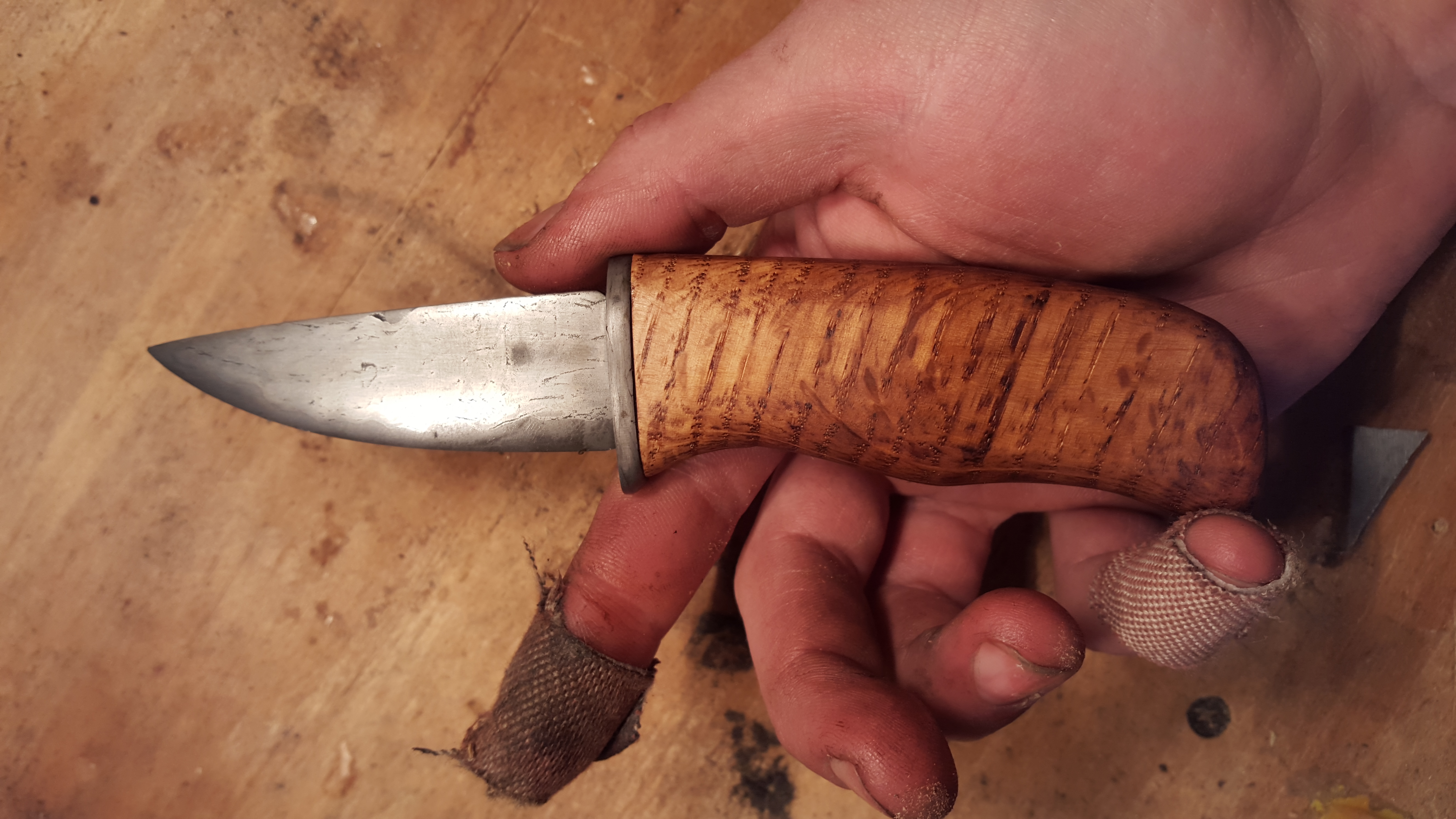

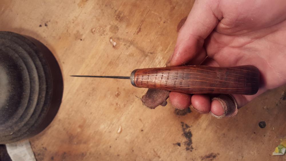

Alright, so i finally finished this guy up, i heat treated it in water which worked great, i ended up with a fairly good warp in the blade caused by a small weld failure. i got it straightened up and cleaned up and then decided to make a guard out of the same barbed wire i made the knife billet from. when i etched the guard i found it had a more active pattern vs the stuff i had made for the blade. im guessing its because i didnt fold the barbed wire as many times to weld up the guard. the handle is red oak finished with danish oil.
as you can tell by my hand, it was just a tad bit sharp after hand sanding :o  a little honing with a 1200 grit stone and its razor sharp.

Great looking pattern, whoda thunk barbed wire could be used for pattern welding!? Awesome idea!
I once welded up a blade using chainmail and thought I was pretty hot till I met a guy at Quad-State who had welded up a blade from lathe swarf; of course that was about 20 years ago now.
Nice to see that one finished!  That guard might make interesting tsuba material.
